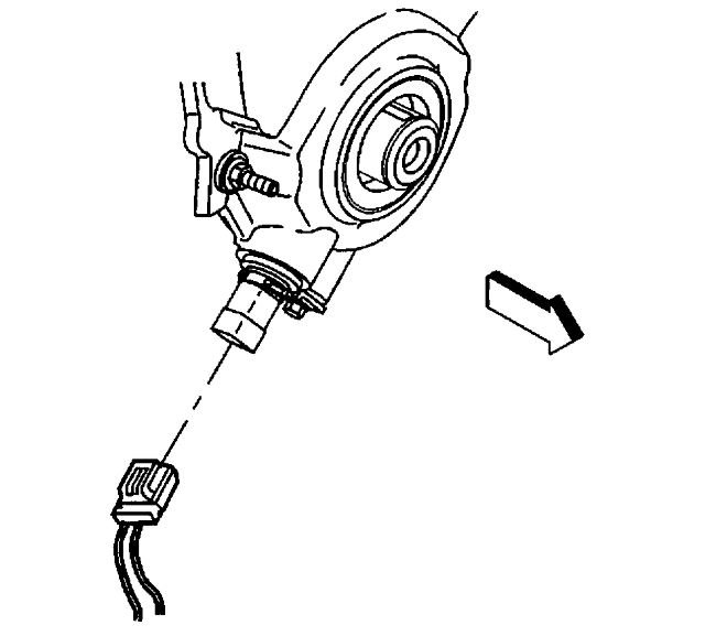

When you crank the engine, does the tachometer move up a little showing cranking RPM?
Did the engine run prior to all the repairs?
That will tell me if the crank sensor is working.
Tuesday, June 11th, 2019 AT 6:09 AM
TIGERMIKE28
  • 9 POSTS
The rpm's quit working shortly after I got brake work done a month ago. The truck wouldn't start one day, so I started troubleshooting. It had spark before I did the repairs.
+1
Tuesday, June 11th, 2019 AT 9:51 AM
My first suspect would be the crank sensor. Very easy to access and inexpensive.
Tuesday, June 11th, 2019 AT 9:57 AM
TIGERMIKE28
  • 9 POSTS
The crank sensor didn't help.

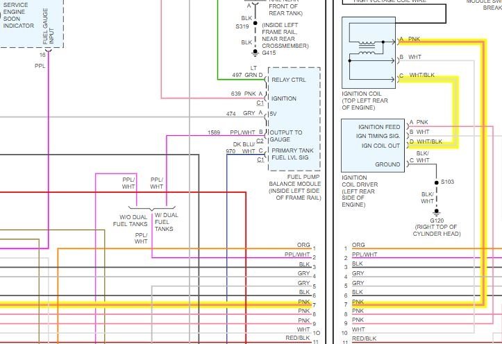

I have voltage to the coil with the key on, but not sure about the signal wire which I think is the middle wire. No spark coming out of the coil to the distributer.
Tuesday, June 11th, 2019 AT 3:39 PM
Okay, use a test light on the white/black wire on the coil. Crank the engine and see if it flashes while cranking. That will tell me if the module is working.

I couldn't find a test light, so I used my fluke 87 multi-meter. I tested the pink wire from the coil connector with key off = ground, key on = 12v. I tested the other two wires 0v, neither have continuity to ground, 0v when attempted to start. That confused me. This was done with the connector removed from the coil. Might I have done that wrong? I couldn't get a reading with it connected to the coil as I didn't have a t pin.
Tuesday, June 11th, 2019 AT 4:47 PM
TIGERMIKE28
  • 9 POSTS
I should be able to do a continuity check to the ECM right? Or is there a problem with the ECM? I thought the pink wire was line voltage, the other outside wire was ground, and the middle wire was the signal wire.
Tuesday, June 11th, 2019 AT 4:54 PM
No, you cannot use a voltmeter for this test.
You need a test light. Doing a continuity test is not a test yet.
You need power to the negative side of the coil. If you have no voltage with the key on, you need a coil.
Tuesday, June 11th, 2019 AT 4:58 PM
TIGERMIKE28
  • 9 POSTS
I tested with an automotive test light. All three wires light up green with ignition off. All three light up red with ignition on. None flash when cranking.

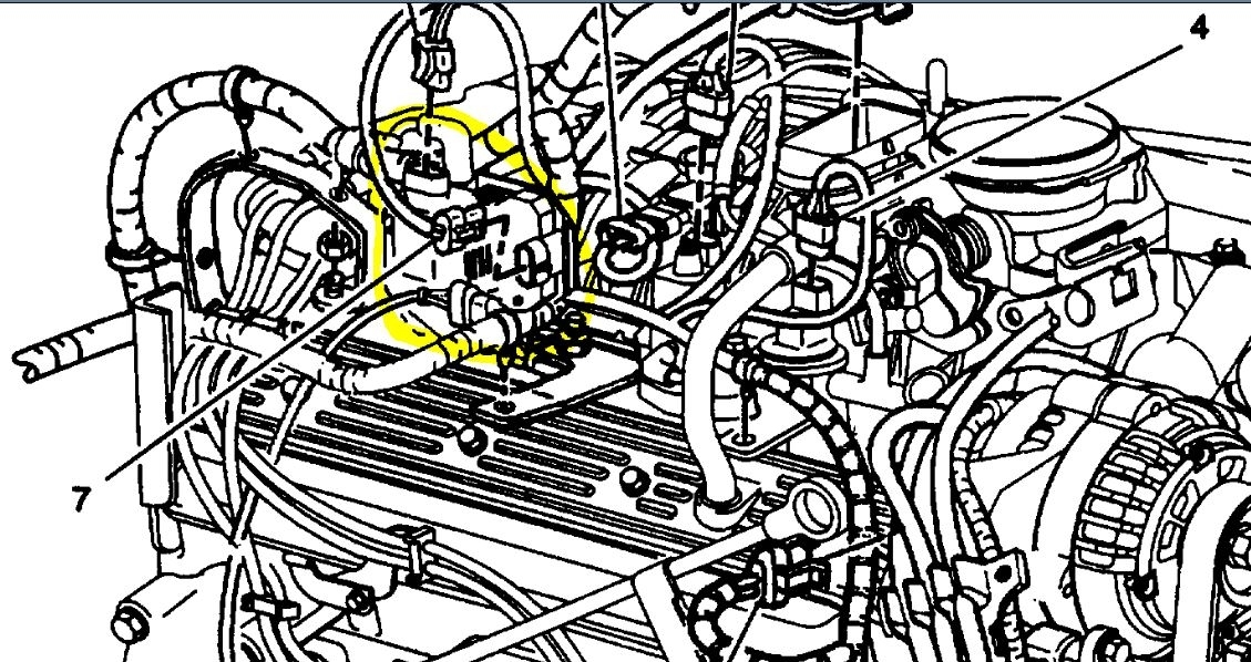

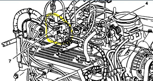

The module is not working.
I would replace the module.
I attached a picture for you. It is number 7 in the picture.
+1
Wednesday, June 12th, 2019 AT 8:29 AM
TIGERMIKE28
  • 9 POSTS
That did it. With a fuel line patch it's up and running. Thanks very much Roy!
