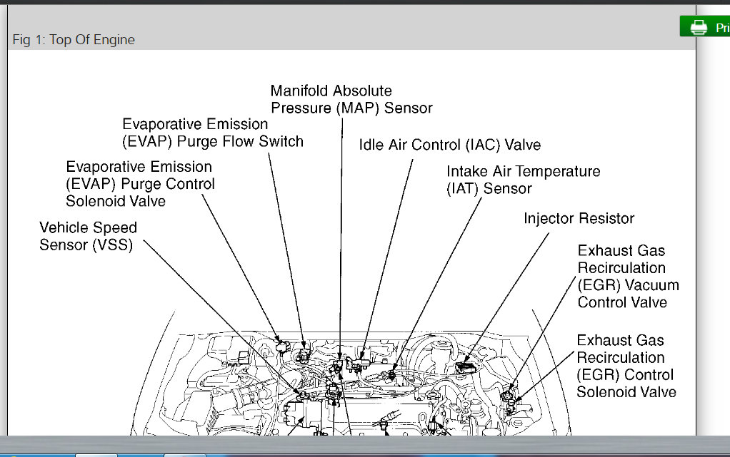

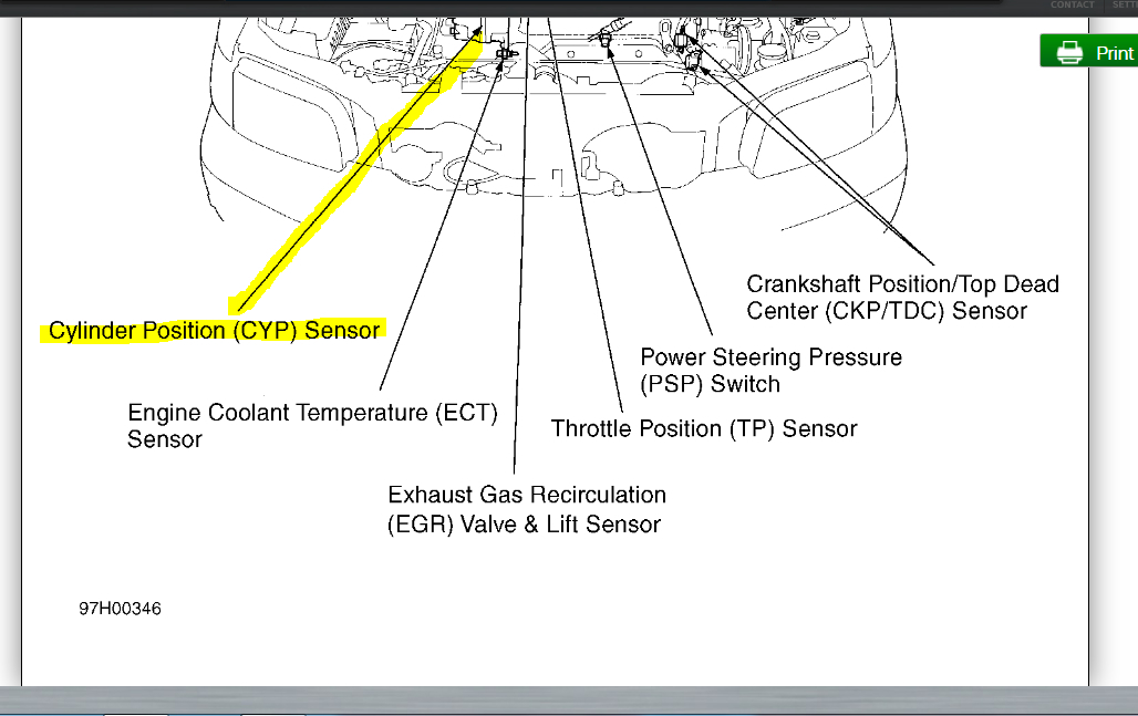

This could be a problem with your vehicle's Camshaft Position Sensor (CMP), or as it's known on your vehicle as the Cylinder Position Sensor (CYP). Your vehicle's Power-train Control Module (PCM) uses the signal to determine where your vehicle is in it's 4 stroke cycle and determines when to fire the spark plugs as well as the fuel injectors. I have included the location of your vehicle's CYP in the diagrams down below. Please get back to us with what you are able to find out.
Thanks,
Alex

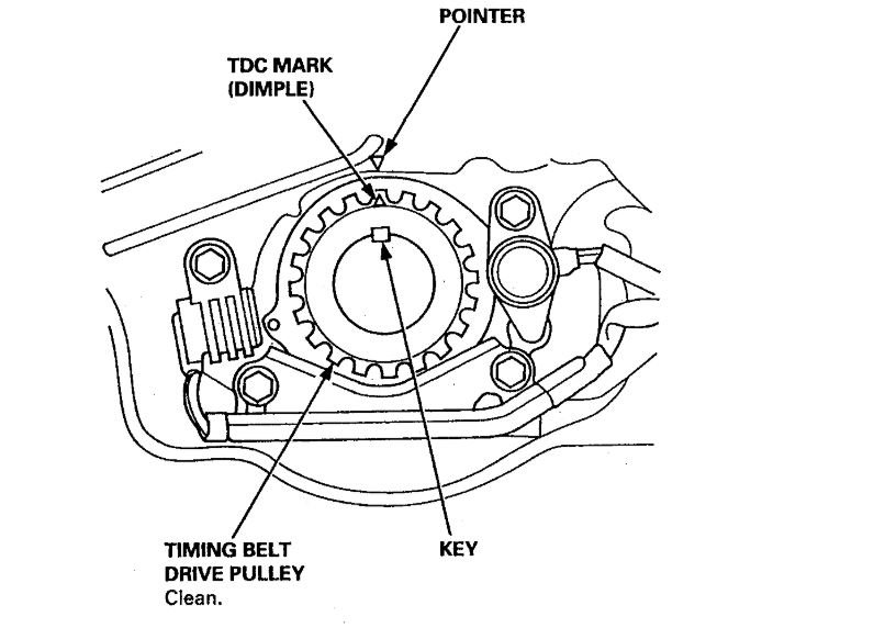

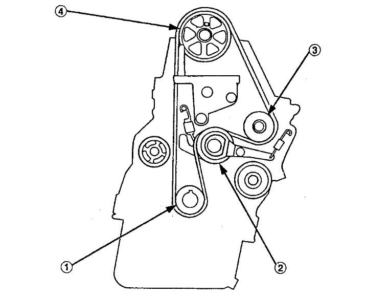

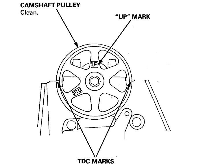

Before throwing some parts at it, make sure you have compression. The engine timing could be off not allowing the engine to start.
when you crank the engine, does the tachometer move up a little bit? That will tell us if the cranks sensor is sending a signal.
https://www.2carpros.com/articles/how-a-timing-belt-works

Thanks. That's your problem.
It looks like the timing belt has failed and needs to be replaced.
https://www.2carpros.com/diagrams/honda/accord/1997
