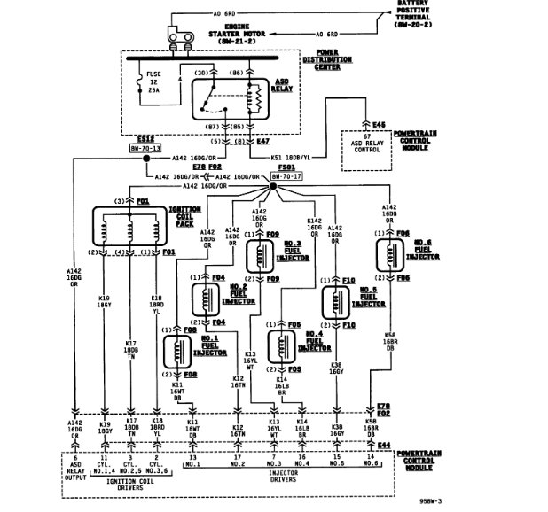

First you have to understand how these systems work. You had better not have voltage to the ignition coil unless the engine is rotating, (cranking or running). The coil pack, injectors, fuel pump or pump relay, alternator field, and oxygen sensor heaters all get 12 volts from the automatic shutdown, (ASD) relay, and that relay is turned on by the Engine Computer when it gets signal pulses from the crankshaft position sensor and the camshaft position sensor. In addition, the computer turns that relay on for one second when you turn on the ignition switch. You should hear the hum of the fuel pump for that one second.
There's two things you can start with. The first is to connect a test light to the dark green/orange wire at the ignition coil pack, any injector, or either smaller terminal on the back of the alternator. You can use a digital voltmeter for this instead, but most of them take too long to respond. You could miss something. With the test light, it should light up for one second when you turn on the ignition switch. In the unlikely event that is not happening, we'll have to go in a different direction.
What is important is if the light turns back on during cranking. Most commonly it will not, then those two sensor circuits become the suspects.

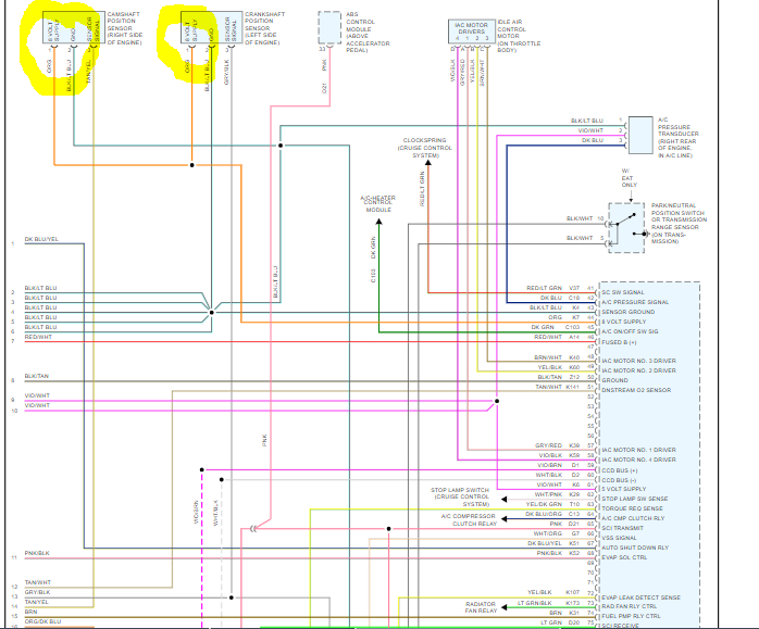

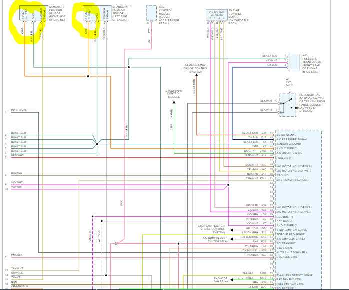

Good morning,
yes, it is very possible the PCM is the issue.
I attached a diagram of the crank and cam sensor. Please use a voltmeter and verify power to the terminals I circled to be sure there is power supplied to the sensors.
