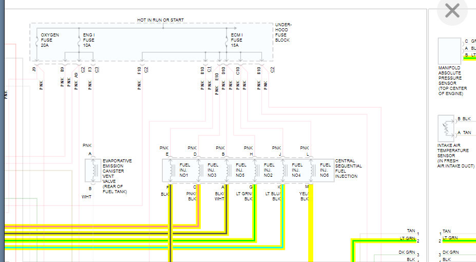

I've replaced the fuel pump, fuel filter, spider injection, MAP sensor, crankshaft position sensor, Idle air control sensor. All the fuses are good. She will start and run if you spray starting fluid in it. 60lbs of fuel pressure. Holds its pressure for days. I can hear the pump running. I'm stumped. Help
Friday, March 26th, 2021 AT 4:07 PM
6 Replies
If it will run on starter fluid then it is not getting fuel to the cylinders. The fact that it is holding proper fuel pressure then we have to assume the injectors are not firing. Here is a guide that will help test them. We need to see if the VCM is grounding them so that they open.
https://www.2carpros.com/articles/how-to-test-a-fuel-injector
I suspect they are not which means I would be looking at the VCM as the issue.

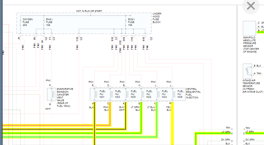

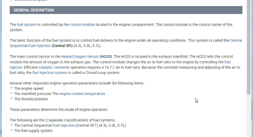

I attached the info below on how this works and the wiring diagram. Let me know what you find but if you hook up a test light you should see it pulsing when then injectors are firing. Let me know if you have questions on this.
