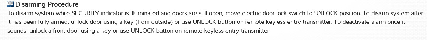

I am assuming battery has been tested for load test and is in good shape. Try another key if you have one not a new one, then make sure the battery terminal ends are clean with no corrosion. Finally try resetting security system there are two different systems on this car another key ois one option and other is in picture. Try that as well.

Did you try what I sent in picture? There are two different systems on this car security wise so I do not know what you have I have sent instructions for both. Is the scanner a auto parts one or professional one? You may a different key from owner if they have one.

Yes tried what was in picture with door locks the owner does not have a second key or the remote unock deal.

The only time the security light is on is when the ignition is off and all it does is flash when you turn the key on the light goes out all the way.
