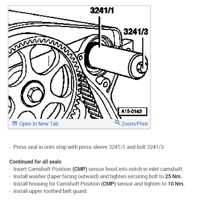

The car just cranks,it does not start at all.petrol is coming okay,we realized there is no spark at the plugs.so we wanted to change camshaft sensor.now we don't know where it's located.please help

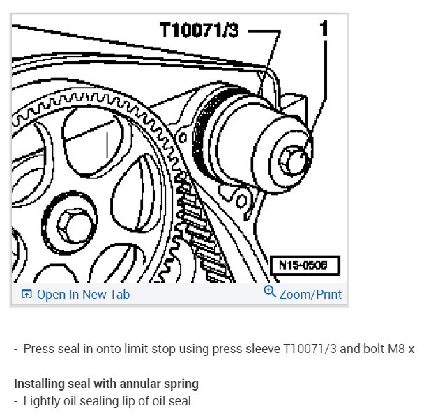

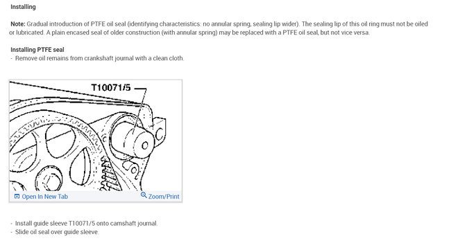

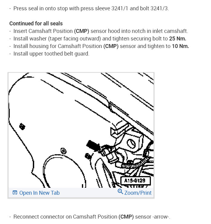

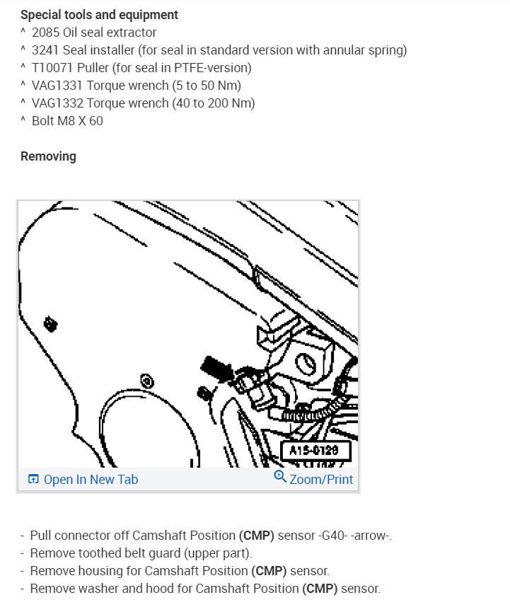

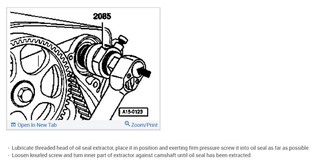

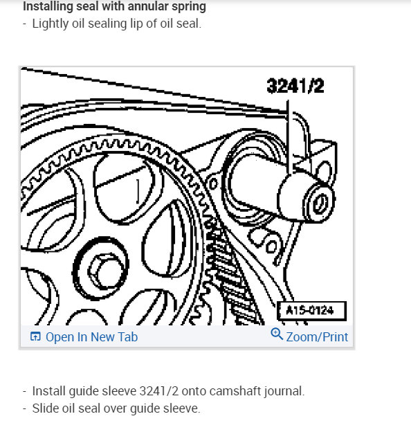

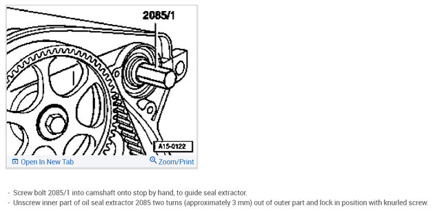

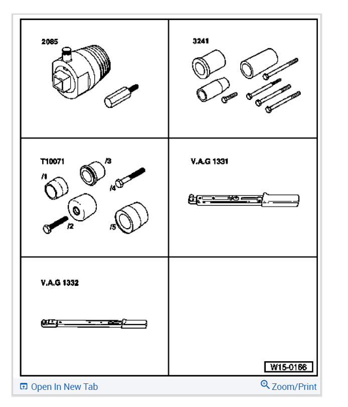

Can I ask if the engine sounds normal when cranking over? Can you please shoot a quick video with your phone so we can hear the noise? that would be great. You can upload it here with your response. Here are the camshaft sensor replacement instructions in the diagrams below.
