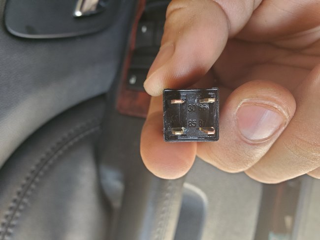

Okay, something is wrong with power off keys out relay clicks and compressor engages, but when I turn the key on relay loses power and compressor disengages. Is there a chance I'm doing the wrong pins on the relay? If I hold is this direction pins 30 and 85 are at the bottom but if I hold the opposite way they are on top?

You will need an ohmmeter to check for the pin. One end at the compressor and one at the relay. Look for 0.00 ohms.

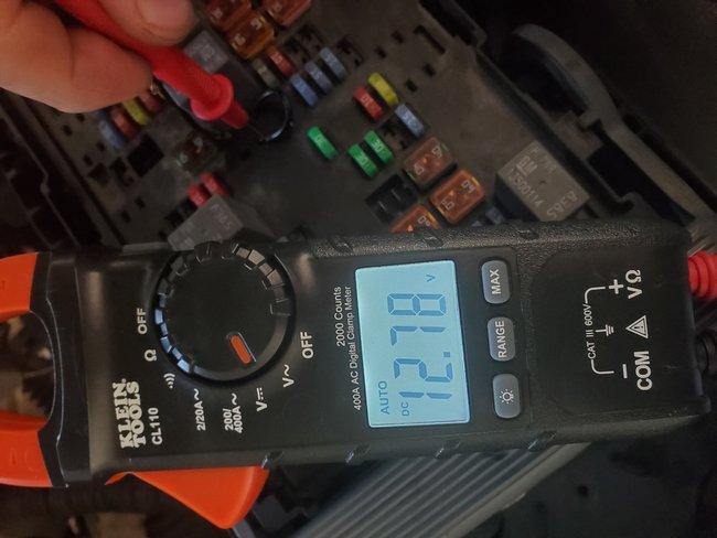

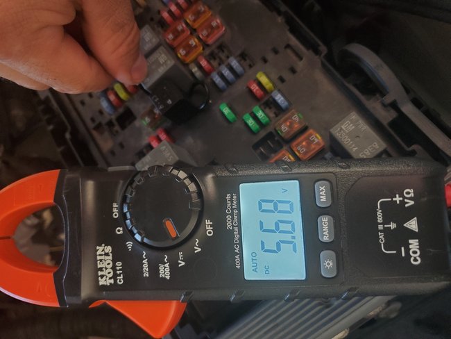

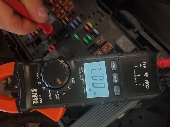

Okay, let me explain my self more clearly I took some pictures. This is with the car off.
When relay is out on lin 86 dos not get any voltage. But as soon as I put the relay then it click and pin 86 get a feedback voltage of 5 volts. First picture is pin 30 and 85 I get 12 volts. I do have a spare ECM switch I just bought.

  • 52,797 POSTS
My last answer did not post.
The 5 volts you see is not a feedback, it is a voltage drop between the relay and the PCM.
This sounds like a wiring problem between the relay and the PCM.
