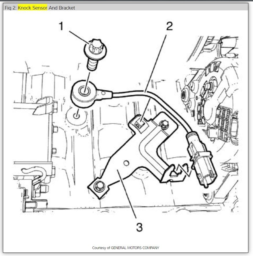

no power when taking off check engine light on
2015 CHEVROLET CRUZE
52,000 MILES • 1.6L • 6 CYL • FWD • AUTOMATIC
GEORGE ERDAHL
My check engine light came on. Takes a long time to get to full power. Took to mechanic and hooked up to a computer and they said it was a knock sensor. would that cause this problem?
May 22, 2017 at 4:48 PM
  • CAR REPAIR CONTRIBUTOR
  • 54,406 POSTS

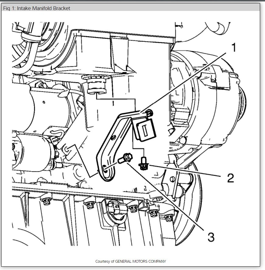

This means the knock sensor has shorted out and needs to be replaced, here is a diagram on the sensor and its location. It could be unplugged as well. You may need to jack the car up
