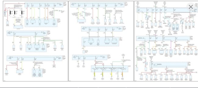

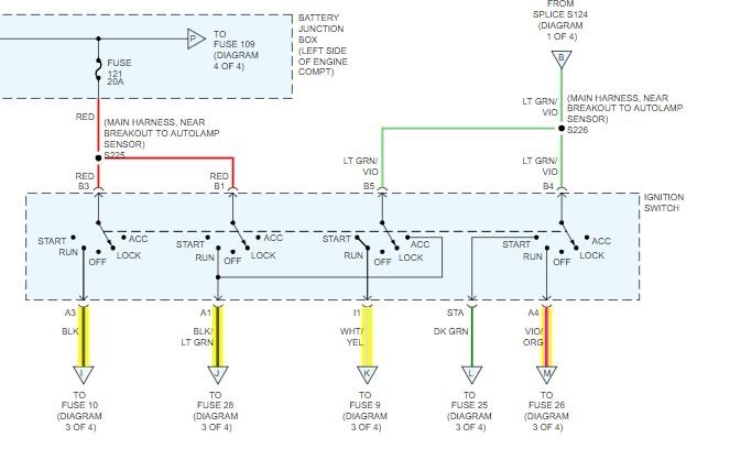

When I turn the key to ACC I get radio. When I turn it to start it or turn it to run I get nothing.
Sunday, April 7th, 2019 AT 3:45 PM
MECHANIC
52,796 POSTS
Good afternoon,
It sounds like the ignition switch. I attached a picture of the diagram for you to check the wire from the switch.
Check the wires highlighted for power with the key on as they feed all the accessories.
Do all other functions work?
