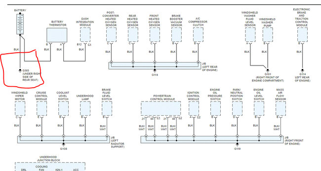

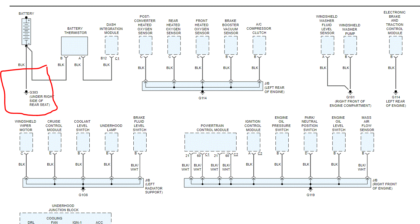

There isn't one fuse that will shut everything down and then slowly power it back. Either you have a dead battery or it's a ground issue. If you take a look at the attached pic, it indicated where one of the main grounds is located near the rear seat. Check it.
Also, take a volt meter and check the battery both with nothing on and then with the headlights on. See if it drops. Check continuity between the battery negative and a place under the hood where you can find a good place to ground the multi meter. I'm curious how much resistance there is. Also, and I don't know what all has been done, make sure none of the fuses are bad in the rear fuse box.
Let me know what you find.

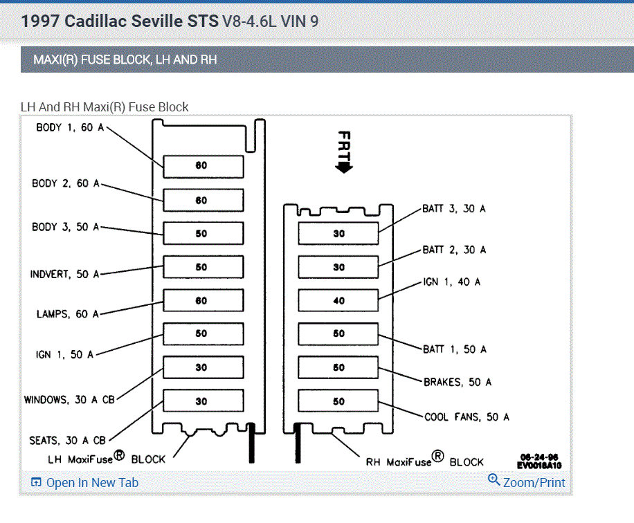

It could be related to the ignition switch. Have you checked the maxi fuses? See attached pic.
