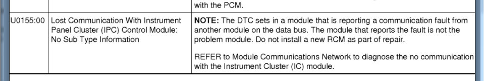

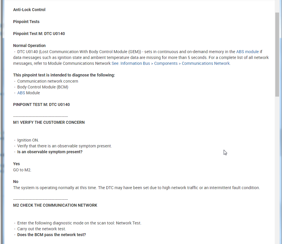

Can you recap where you are currently? Do you still have the U codes that you had prior?
I suspect there is an issue with the BCM at this point but we need to run through this testing to confirm it. It looks like you are going to need to run a network test but take a look at this info and let me know what you think.

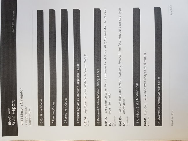

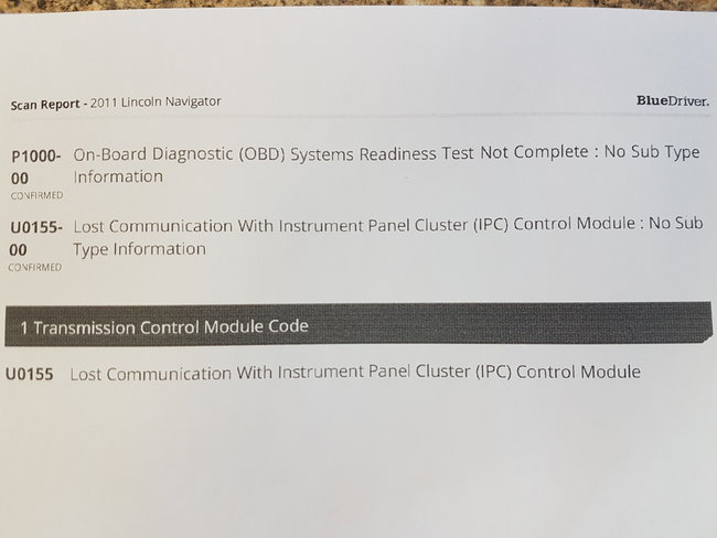

I did a scan again and I am going to attach the results. The attachments you sent does make a sense about BCM. Let me know about the network tests you want me to do. Seems interesting something new to learn.
Thursday, May 27th, 2021 AT 3:42 PM

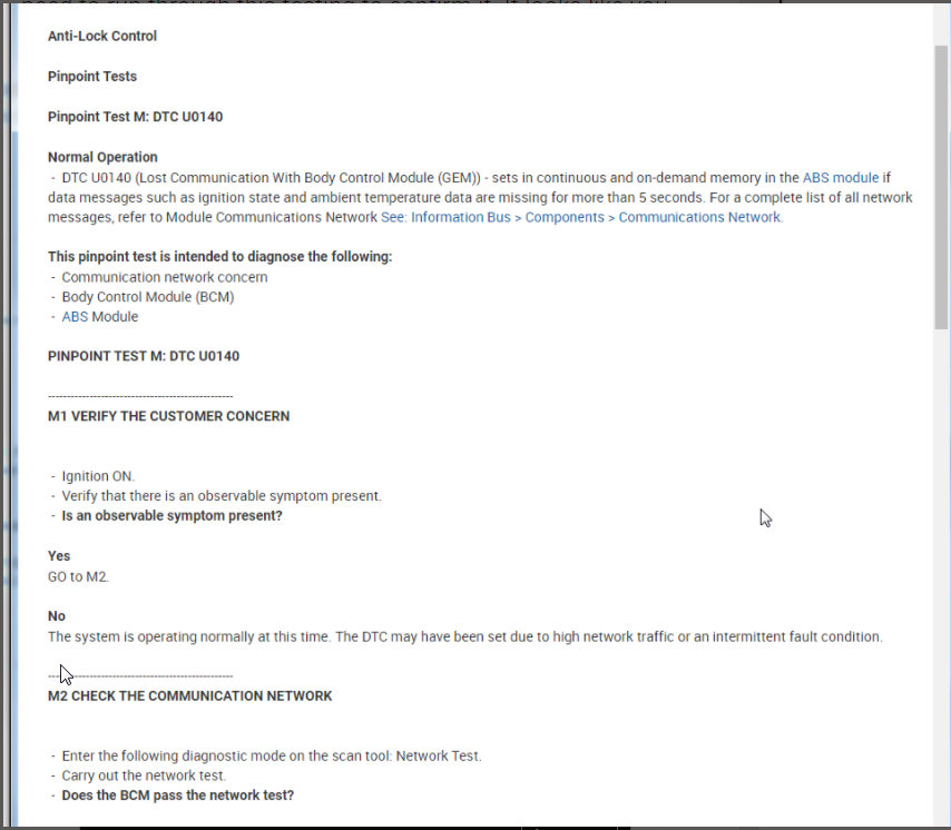

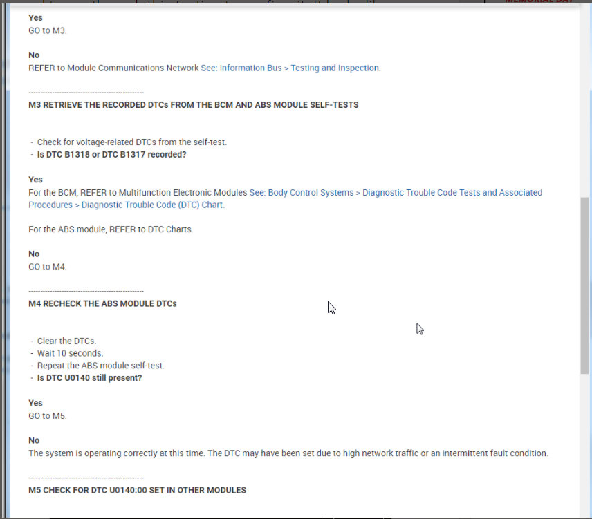

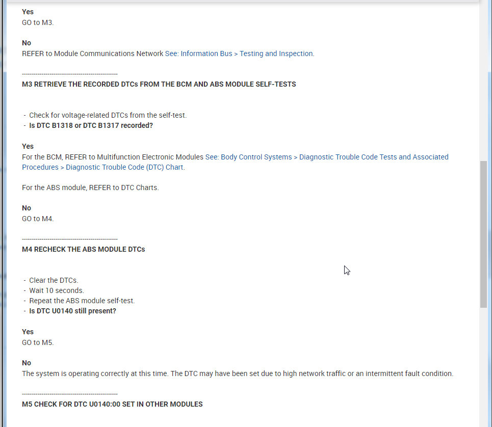

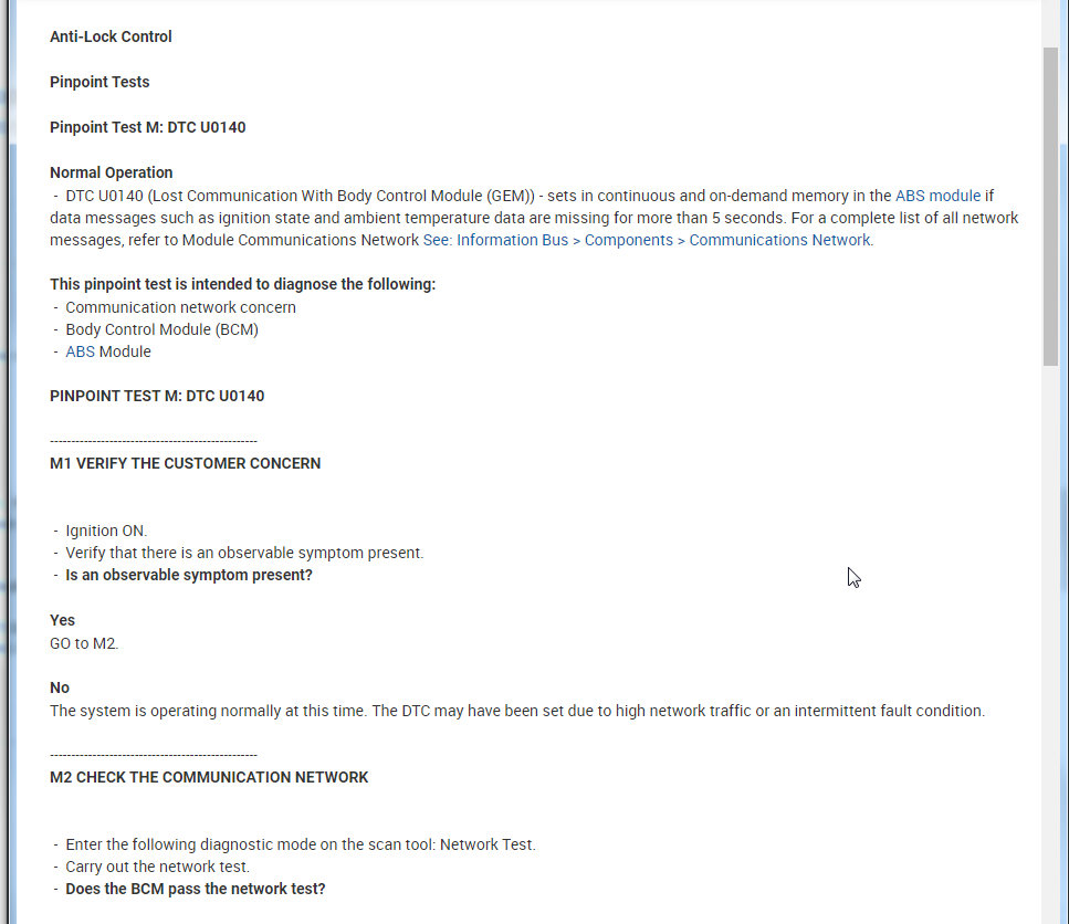

Okay. That is good that it is the same codes. So the network test is not something that we can do. It is a scan tool function but it is not something that the generic scan tools will do. This is an OEM or equivalent tool.
Take a look at the attachment below and it is M2 that talks about it. What I would do is just check around for a shop that has a tool that can do it and just have them run through this testing and pay the diag charge rather then buying the tool. Unless you are going to be doing this type of diagnostic work more frequently it really is not worth buying. They are normally a few hundred dollars at a minimum and you will pay less to have a shop do it as you will likely not need to do it again.

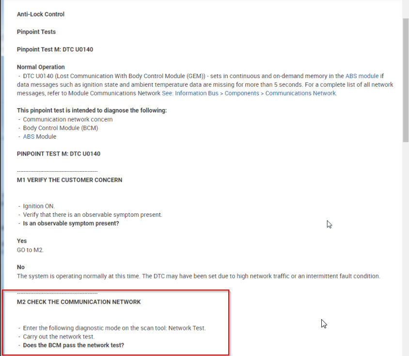

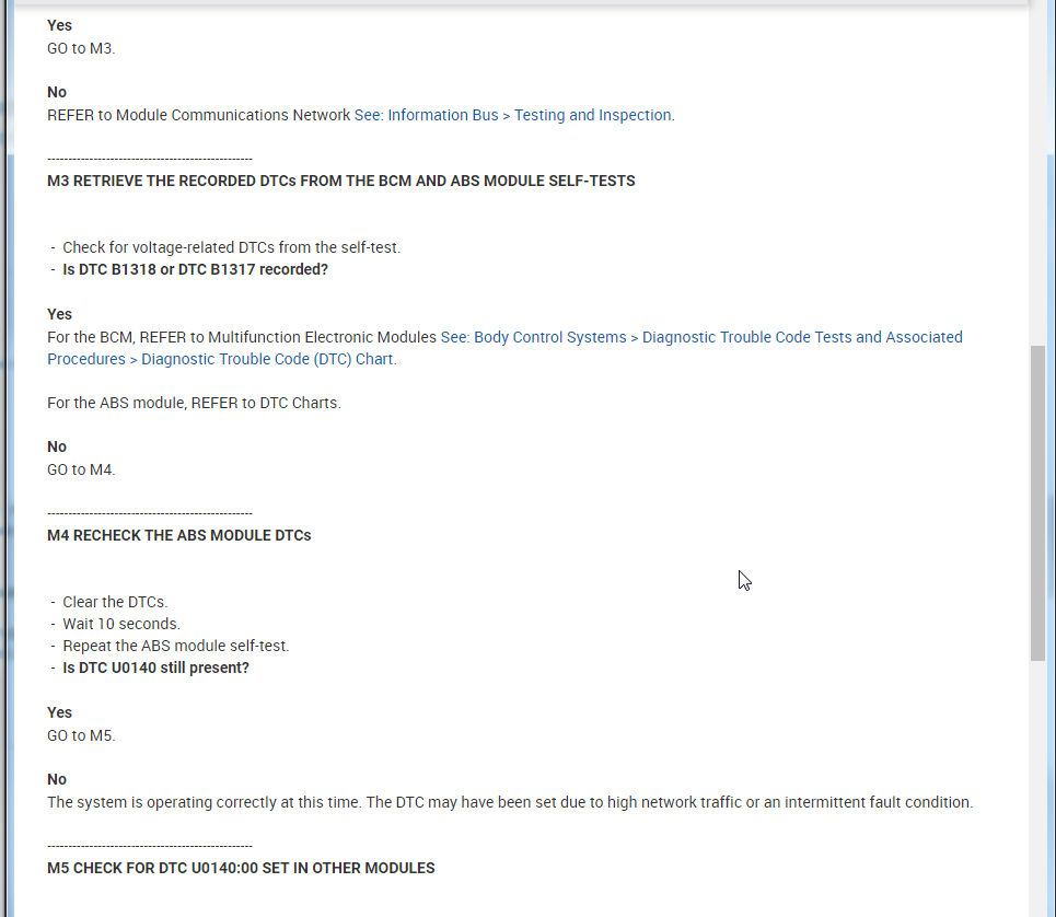

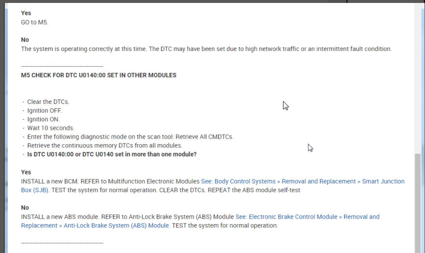

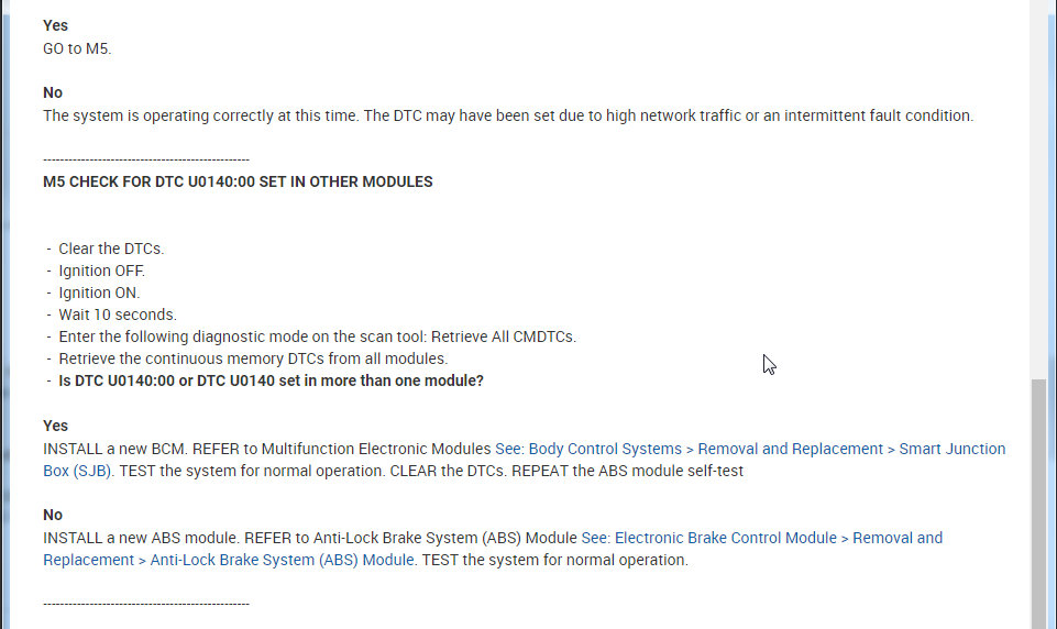

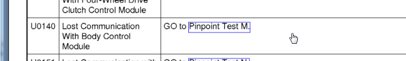

However, based on your codes, I am not sure you need it. Basically what the U0140 in the ABS is saying is that it is not getting the proper message from the BCM.
This could be due to the communication network, the BCM, or the ABS module.
If you read through the test and make the assumption that the BCM will pass the network test which means it is not a wiring issue or other network issue then it leads you to replacing the BCM after you answer the remaining questions.
So you can get this tool as it does a lot but replacing the BCM may be the solution to these codes. Depending on the price of the BCM, I may just go with that rather than a scan tool that you may not sure all the time.
Run through the testing and confirm you are seeing the same thing.

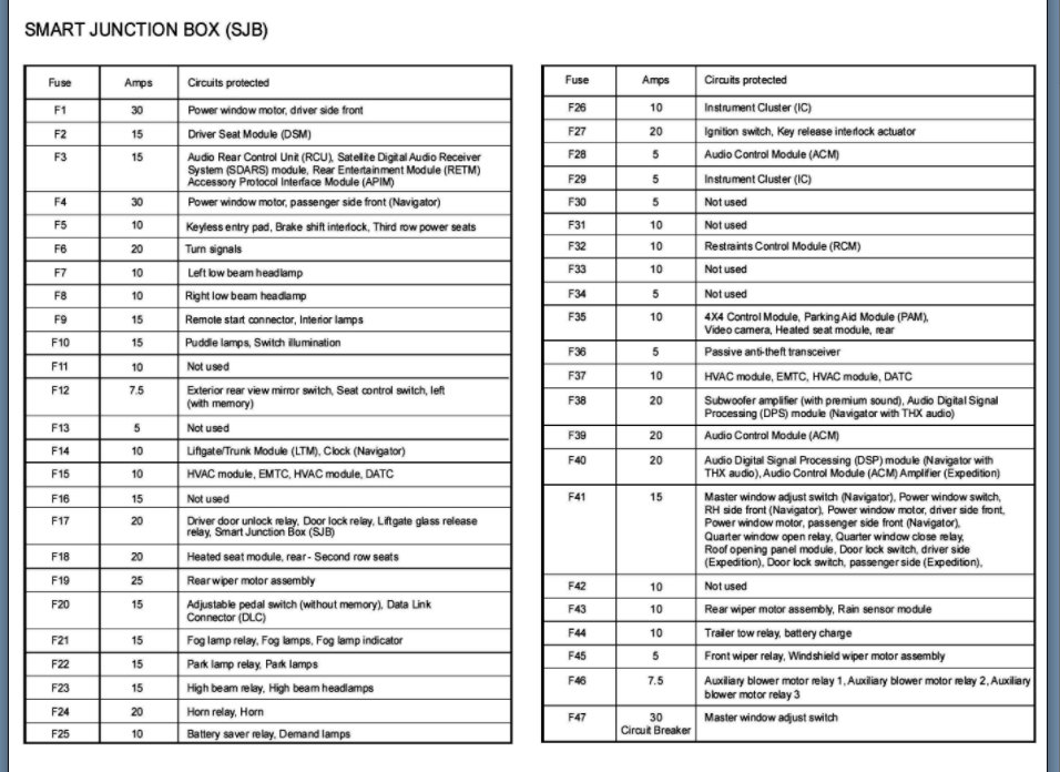

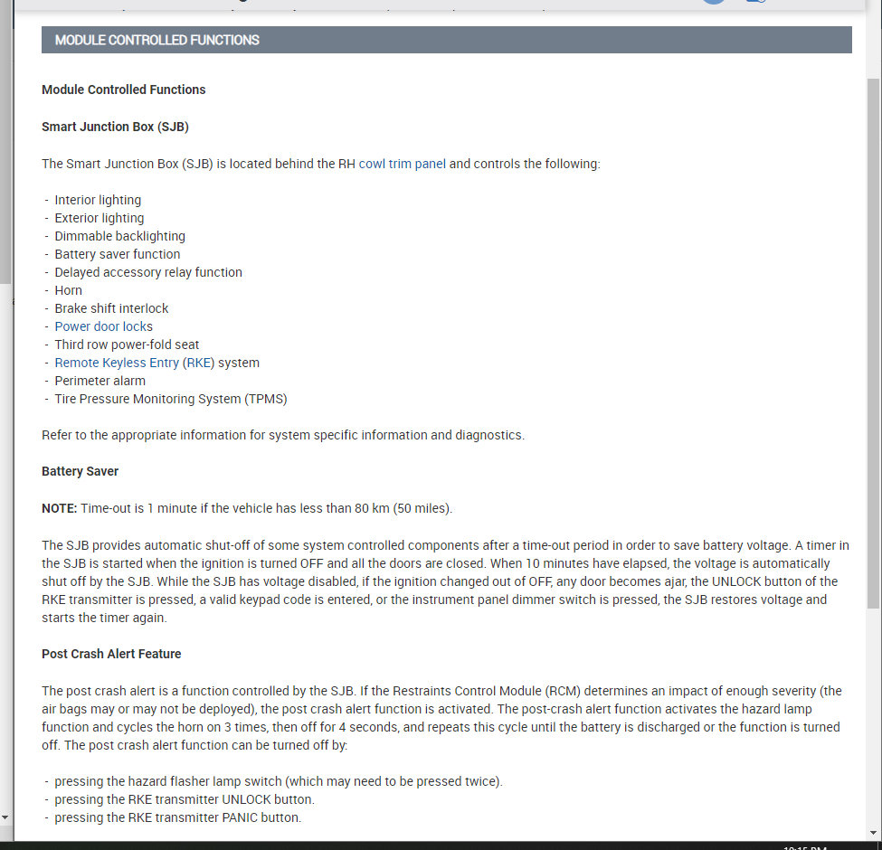

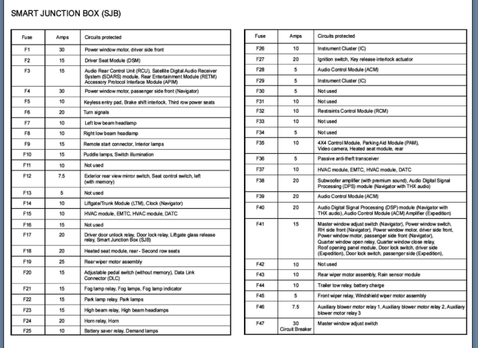

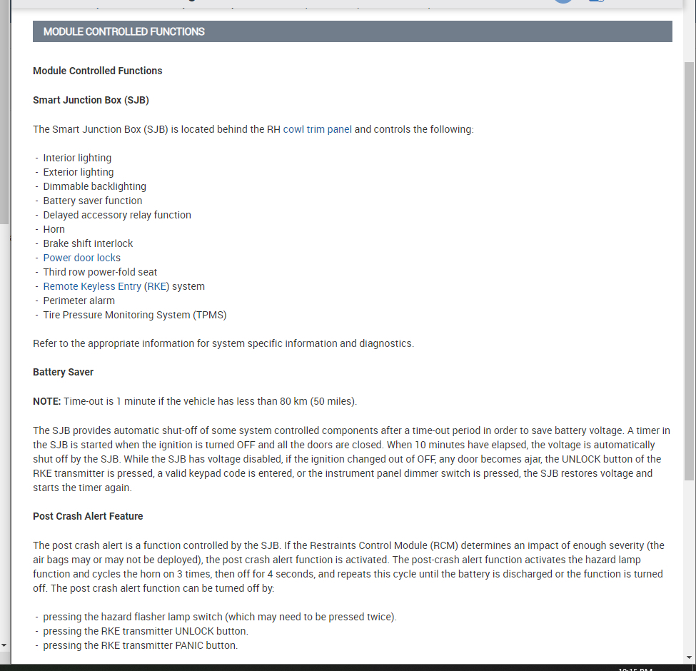

I think the issue you are having is the body control module is a pretty generic term. On your vehicle it is called the smart junction box.
Take a look at the info attached that gives more detail on this.

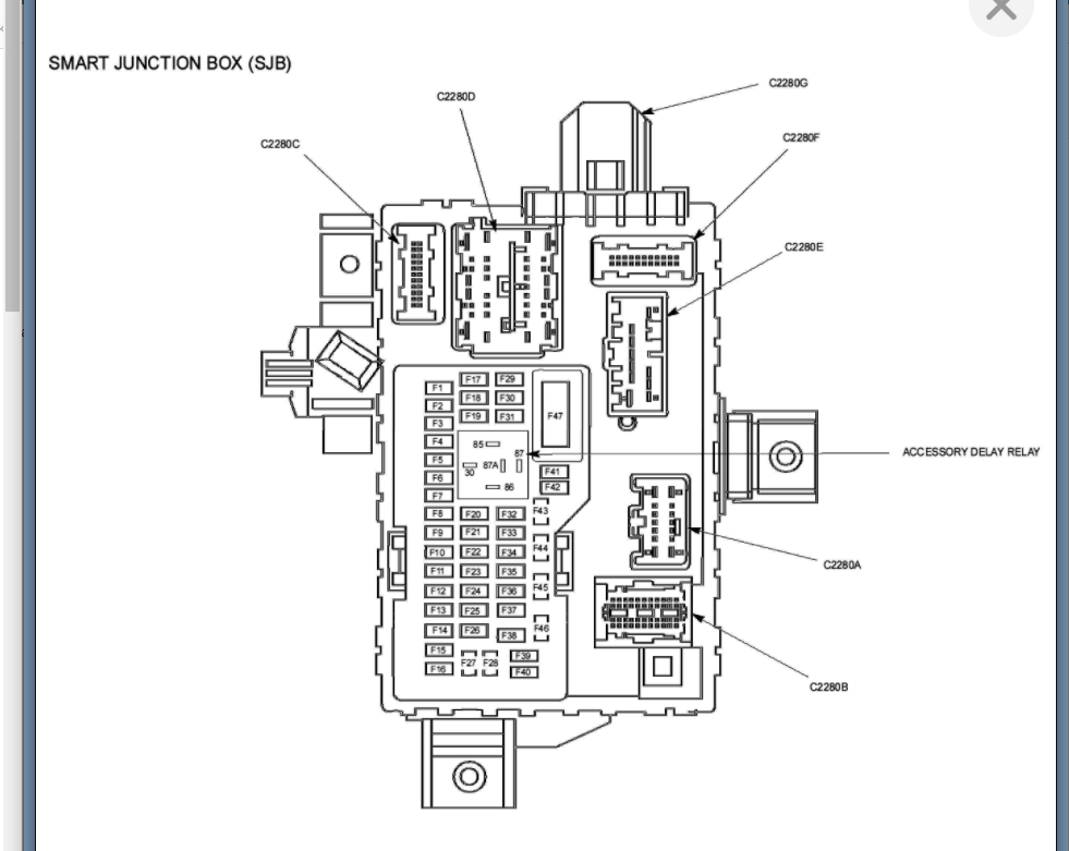

I went to dealer with my VIN and the VIN of the vehicle the wrecker gave to ask if the parts are interchangeable between these 2 VINs and told that I am planning to buy SJB for my vehicle and they gave me a part number BL1Z 15604-B and told me parts are interchangeable between them and the part number is same on both. When I took out the kick panel fuse box which I assume is called SJB the part number is different on it which is BL1T 15604 AA. I will take the fuse box to the dealer to show them the part number on it. Just wanted to confirm with you that the kick panel fuse box is the SJB unless I am missing something. Please advise me.
Thursday, June 24th, 2021 AT 1:30 PM

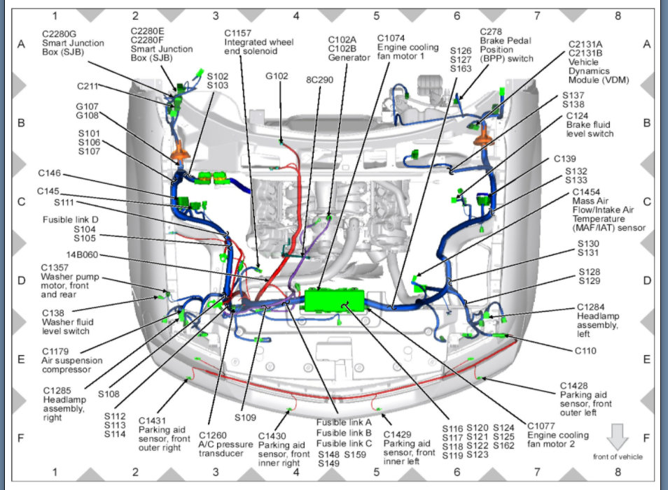

Those are not identical part numbers but more than likely there was change made to the part and when that happens they change the part number slightly.
I suspect they are correct that they are interchangable. However, they should be able to confirm that by checking that part number.

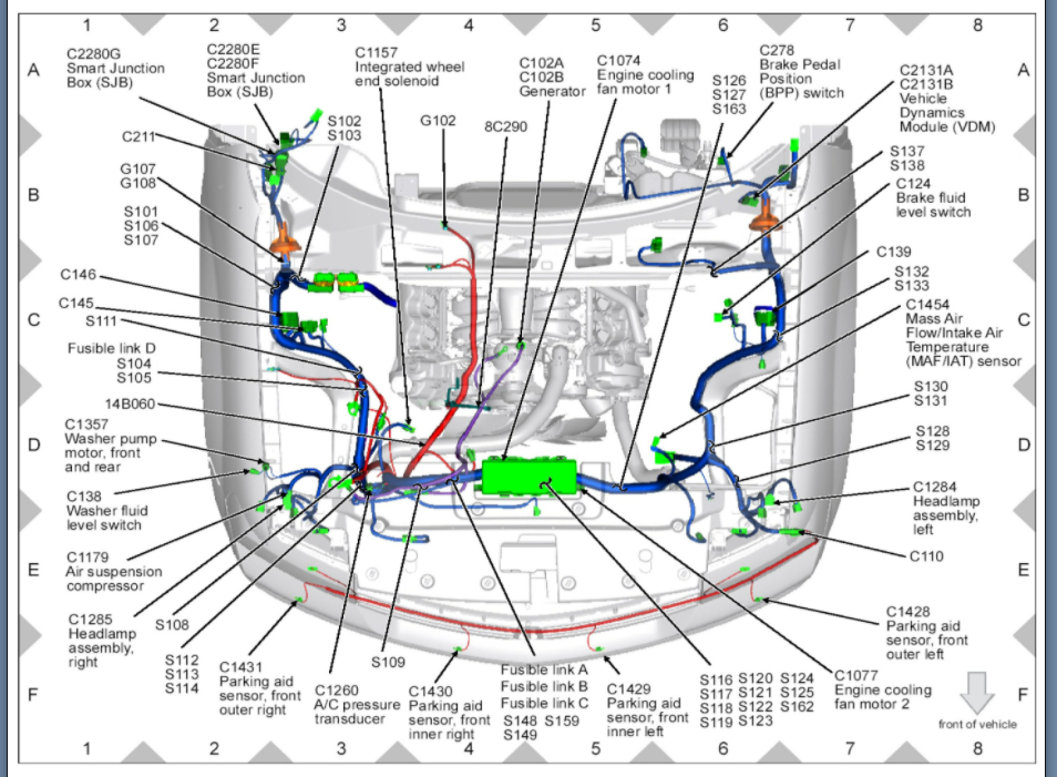

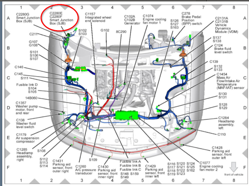

Take a look at the diagram for the location of this. Thanks

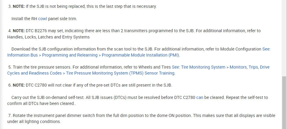

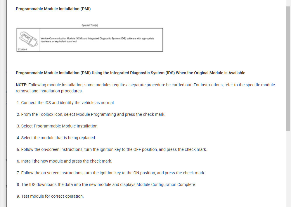

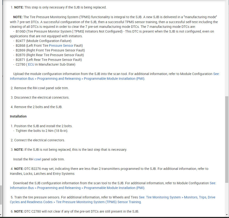

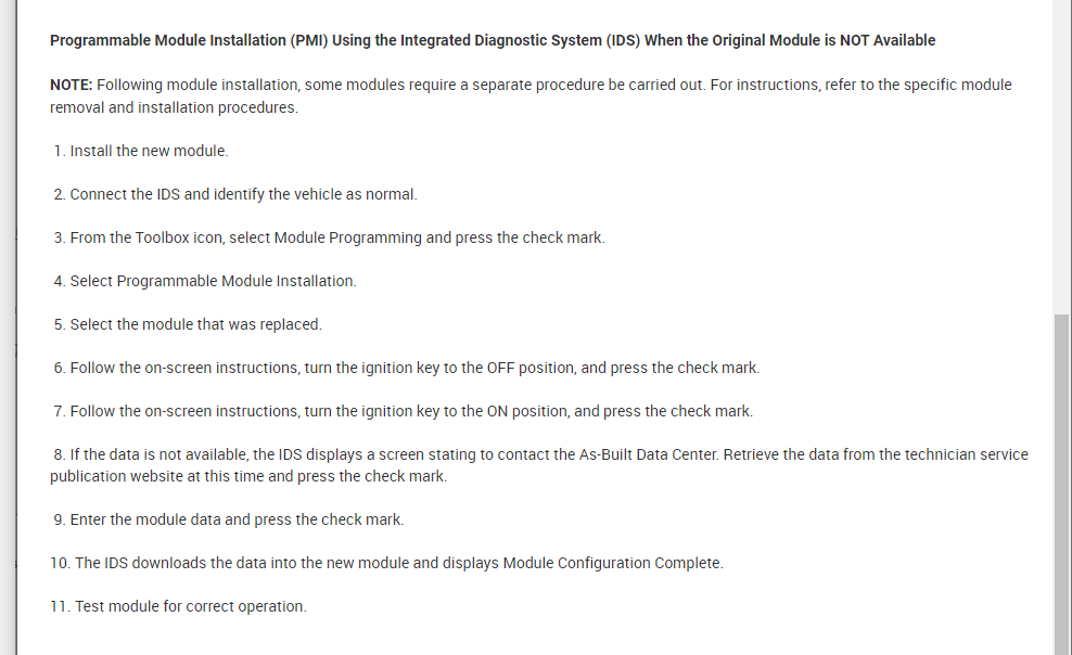

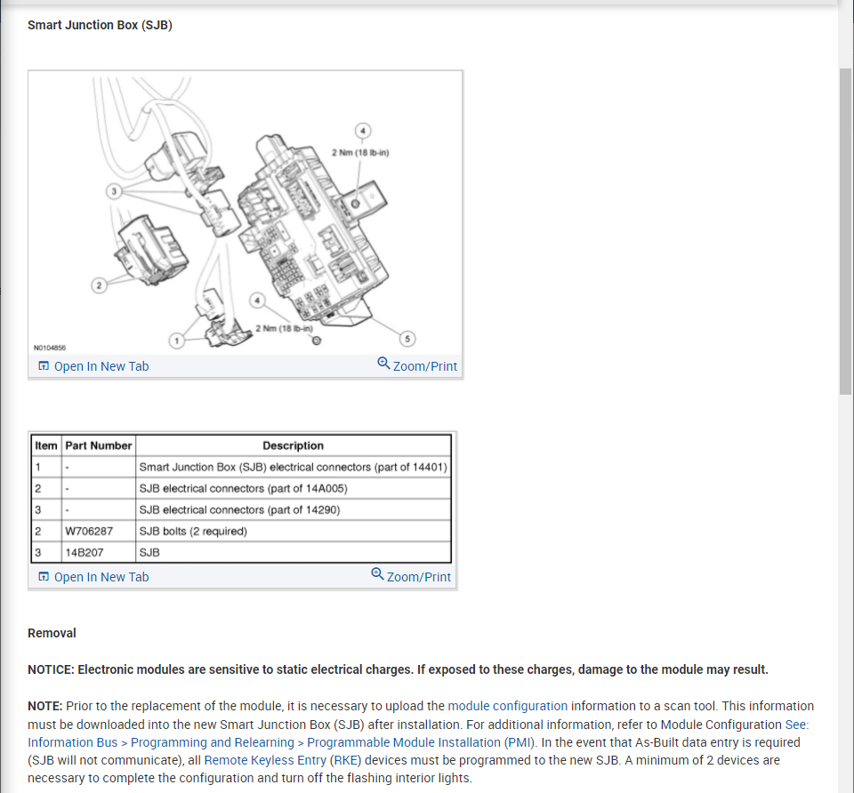

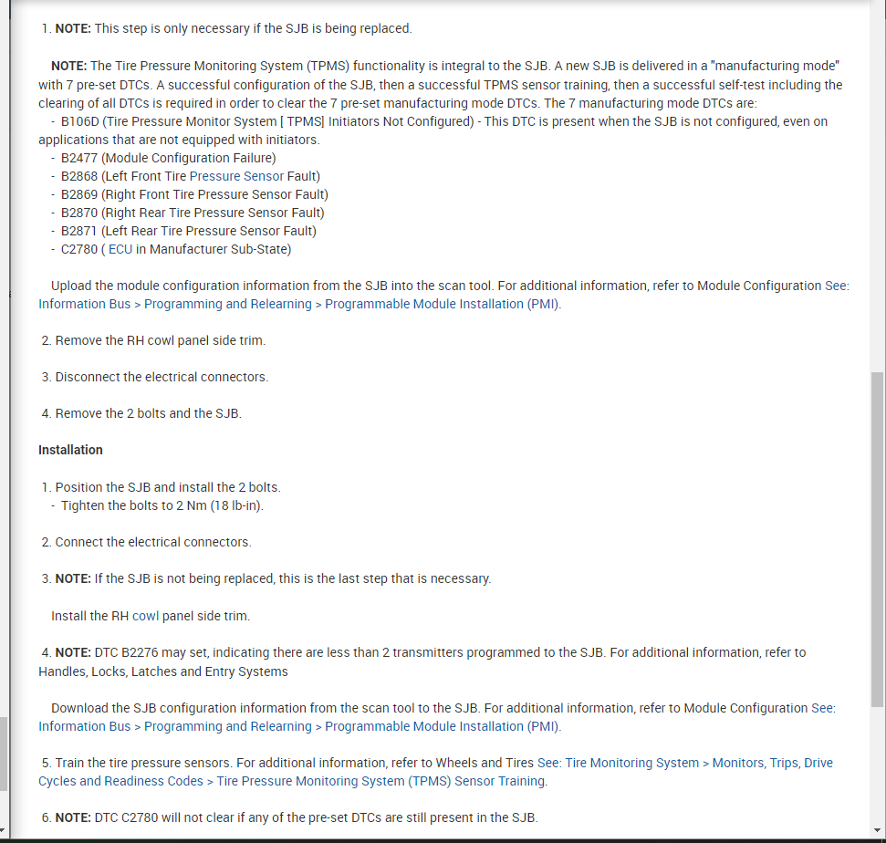

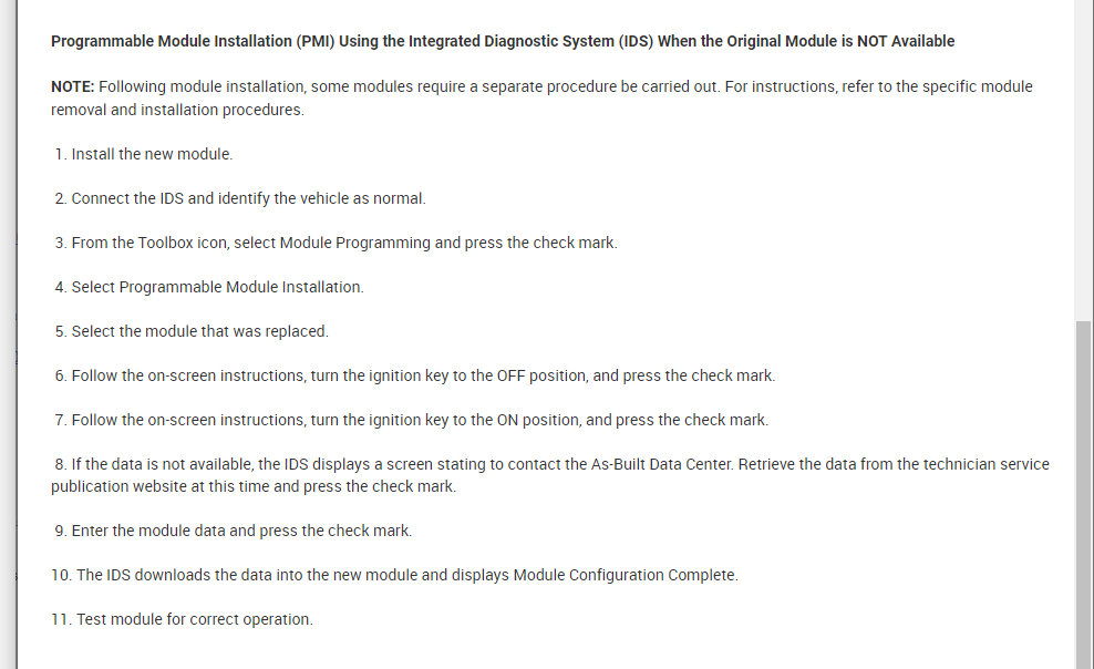

I just bought brand new SJB. Is it complicated to copy data from old SJB and transfer to new SJB? What kind of equipment do I need to do it?
Thank you
Tuesday, July 6th, 2021 AT 5:58 PM
There is a process. You need to upload the current SJB info and then put it into the new one. You can do it when without uploading the info but either way it requires a scan tool that is capable of performing this function.
Attached is the process that you will need to follow. If you don't have a scan tool then we will need to find a shop that can perform this for you.
