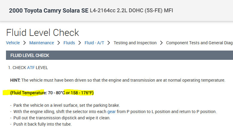

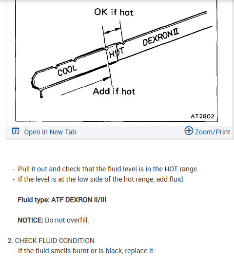

I am attaching the directions for testing the fluid. This is from my manual, so it is accurate. If you have already checked it this way, let me know. Also, let me know if you are able to get your hands on a scanner that can read all the codes.

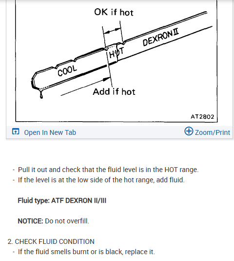

See the pictures below. Note that when you are actually checking the fluid, the engine should be running and the transmission in park.

do the fluid level suppose to be on cool mark when engine cold and rise up to hot mark when engine hot??
Dec 11, 2024 at 12:53 PM
  • 54,520 POSTS
I would start with three quarts, and yes, the fluid level cold is for when the engine is cold.
