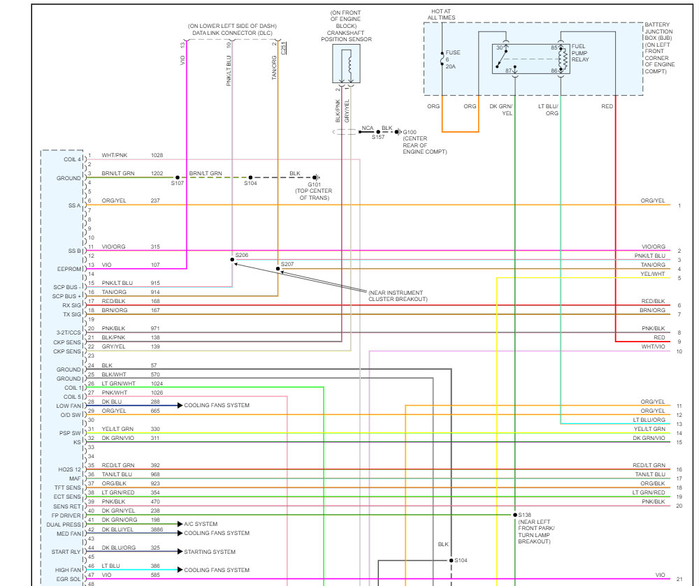

I would like to test the power connection as well as the ground to the PCM but am having a difficult time locating a wiring diagram for this year and model.
At this point I suspect the PCM is out. Is there any way to have a PCM tested out of the vehicle? Can a Ford dealer test them? Or am I missing something else that could be the problem? Does anyone have a PCM wiring diagram for the vehicle listed above XLT (3.0L V6) by chance?

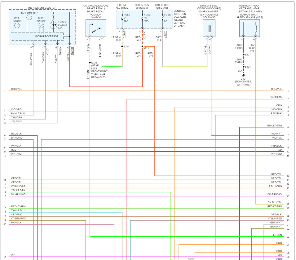

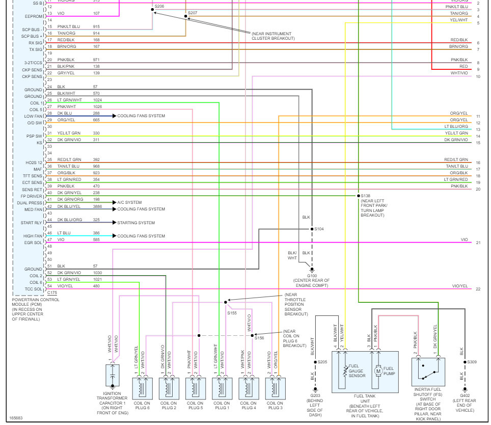

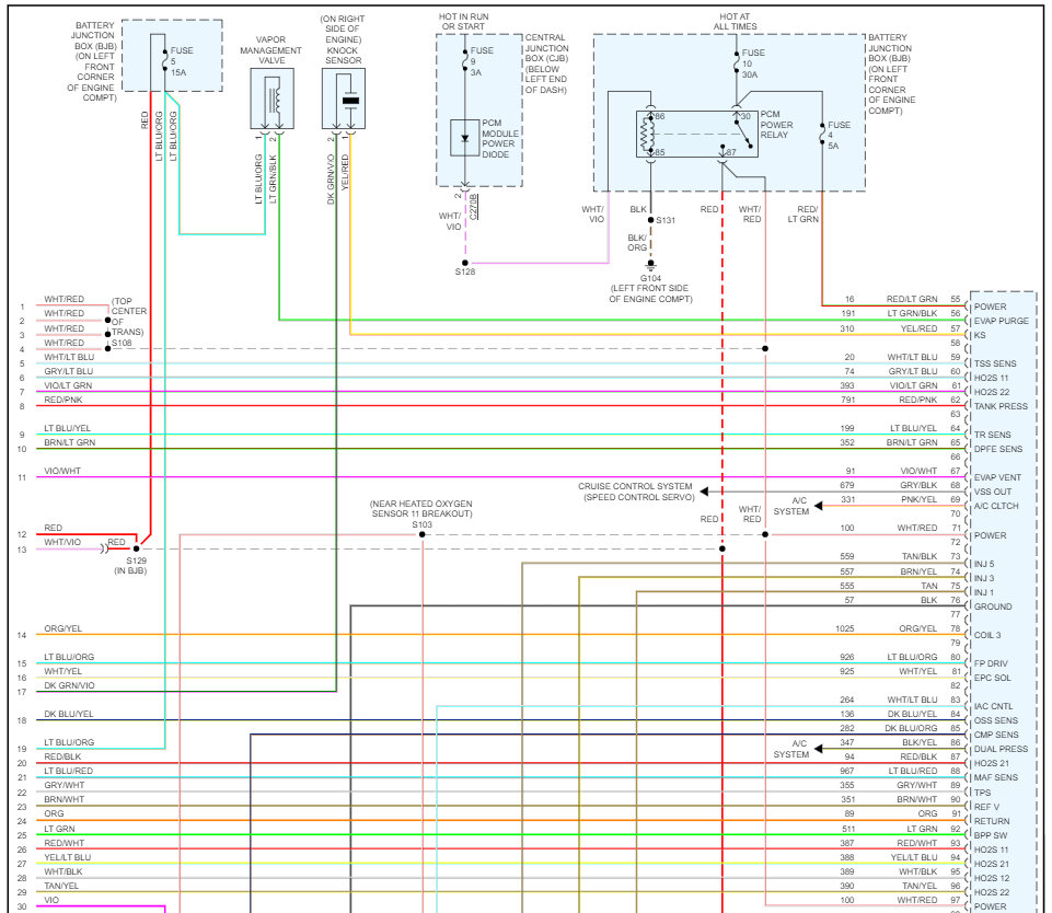

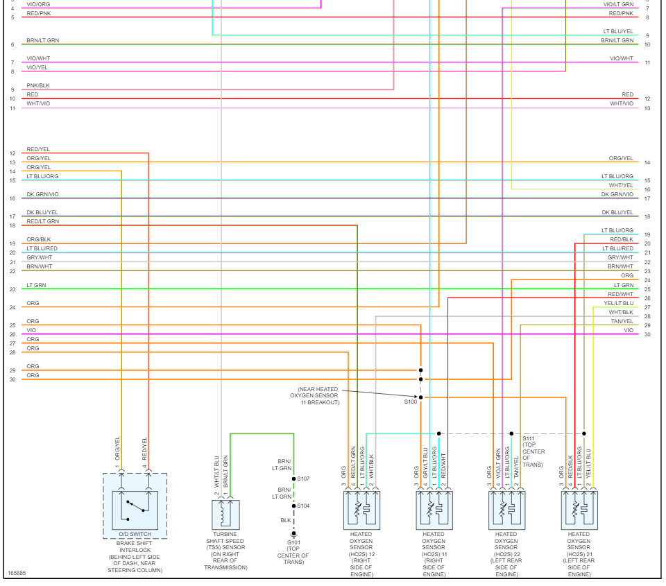

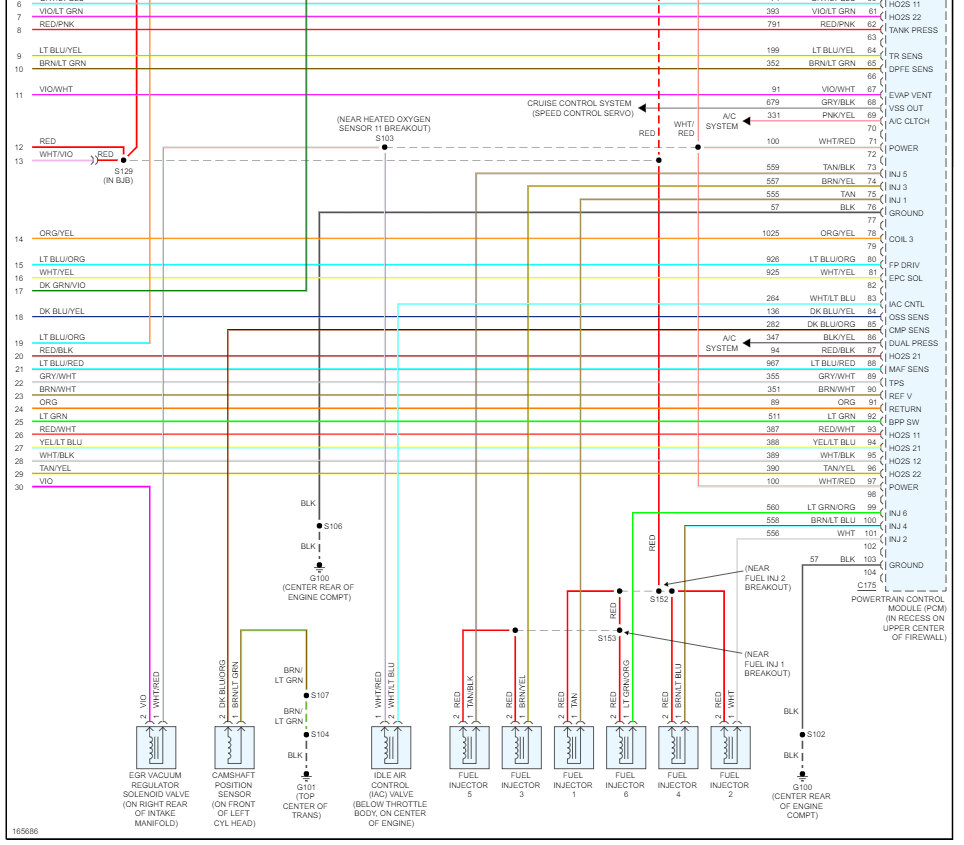

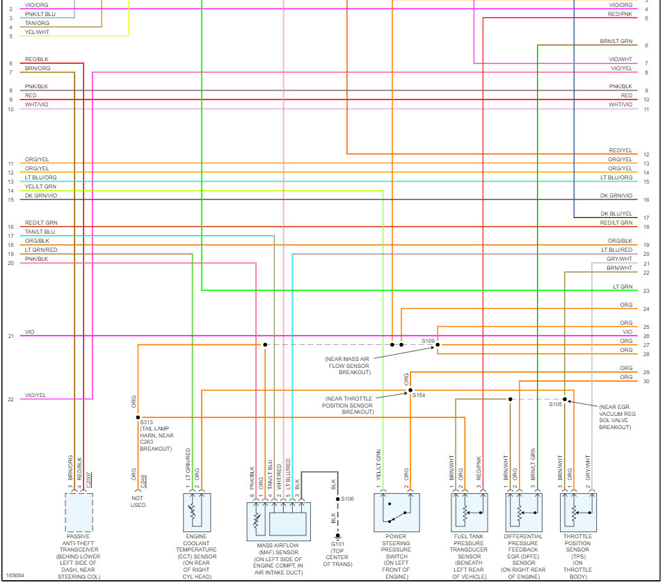

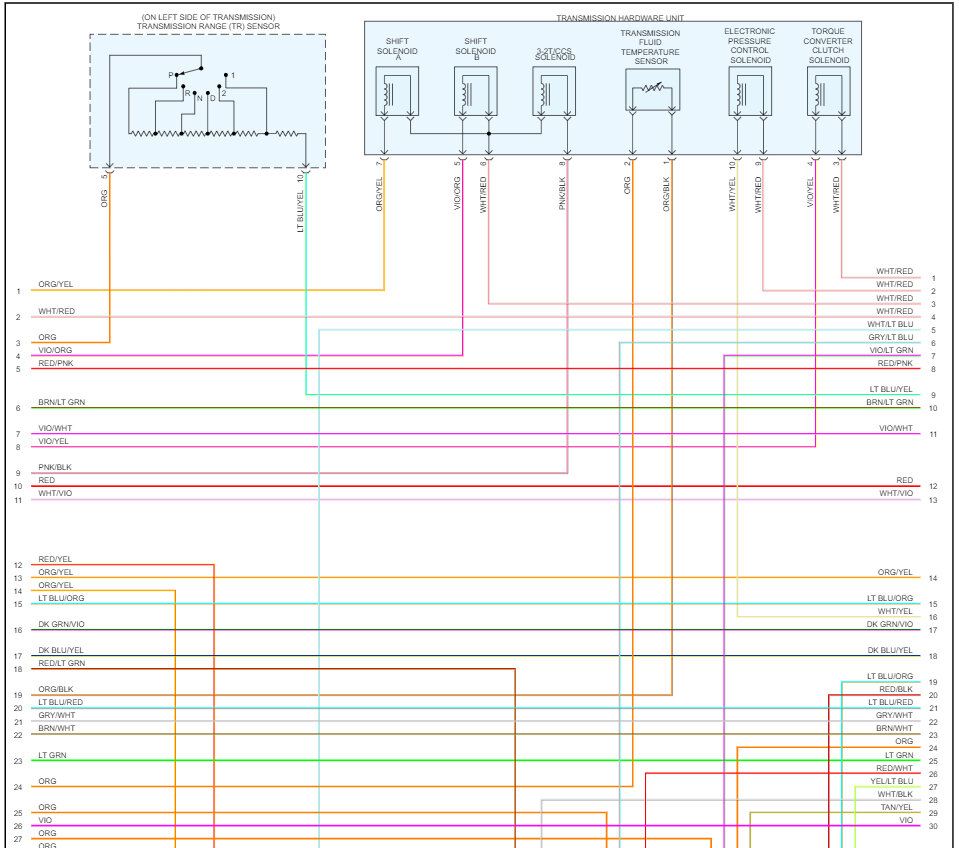

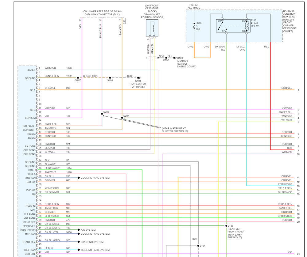

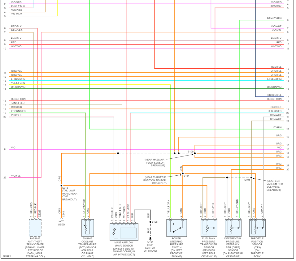

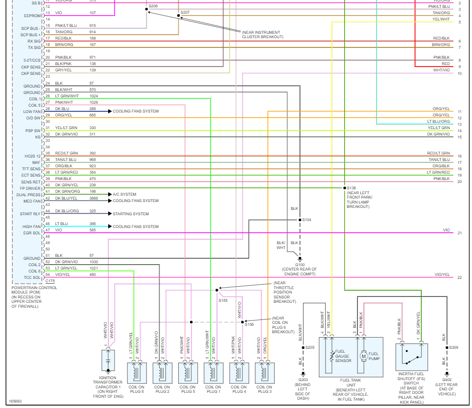

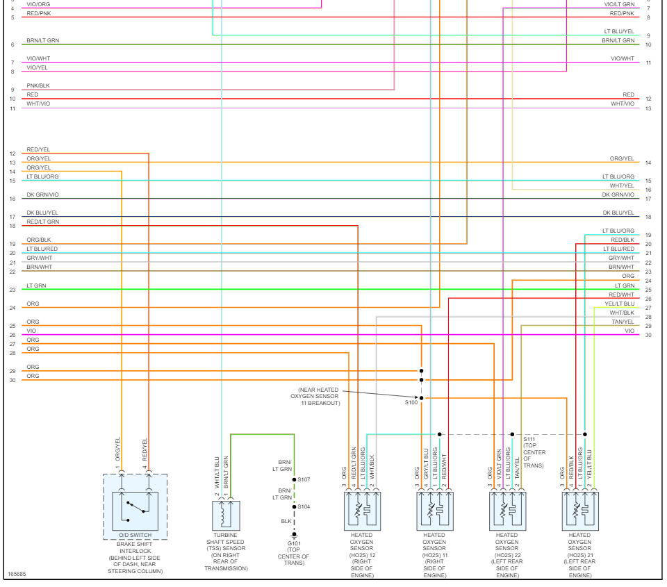

Yes, you can send the PCM into a rebuilder and they can test it for you. Here is a guide to help you test the PCM wiring and the PCM wiring diagrams I have included in the diagrams below:
It does sound like the PCM went out to me. Check out the images (below). Please let us know what happens.

Thank you for those wiring diagrams. Using them I was able to verify power and ground to the PCM. At the connecting block that plugs into the PCM I get the following:
Power
Pin 55 - 11.78v (Key On), 12.25v (Key Off)
Pin 71 - 11.78v (Key On), 0.0v (Key Off)
Pin 97 - 11.78v (Key On), 0.0v (Key Off)
I performed a voltage drop test on the grounds and all but one gave a 0.1v drop with key on.
Pins 3, 24, 25, 51, 76 and 103.
Tests were done with the PCM removed from the vehicle. If I plug it back in what would be the best way to test it?
Update: I just reconnected the PCM and checked the 5v Reference that comes from pin 90 for the throttle position sensor and I only get 1.2v with the key on. Is there something else that you recommend I test? Any ideas would be greatly appreciated.

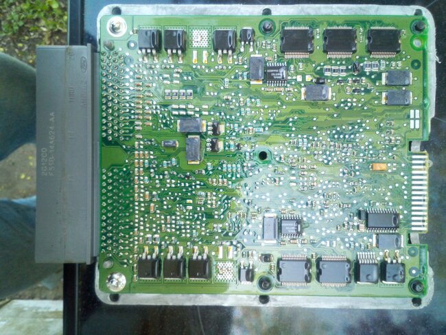

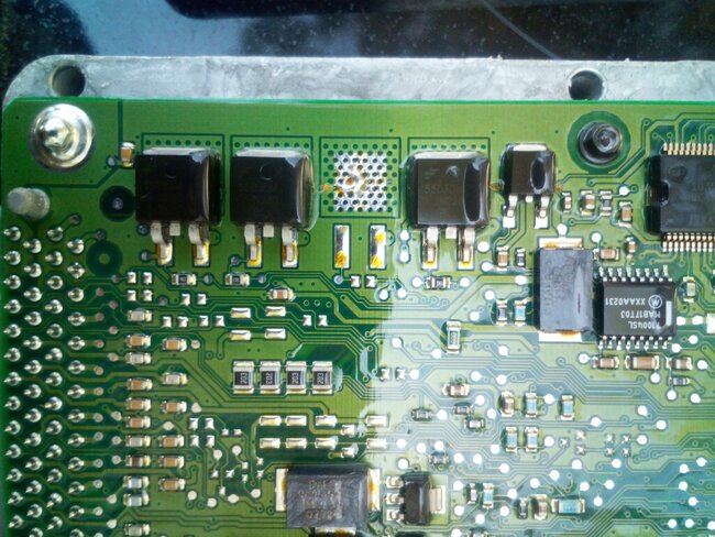

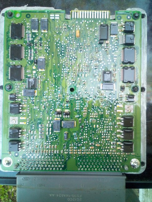

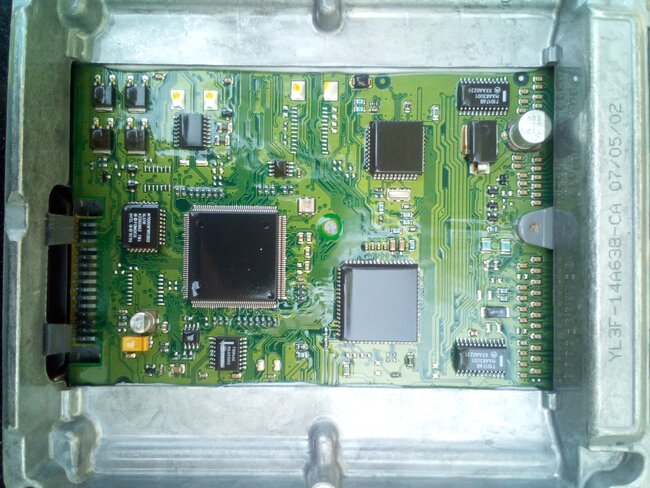

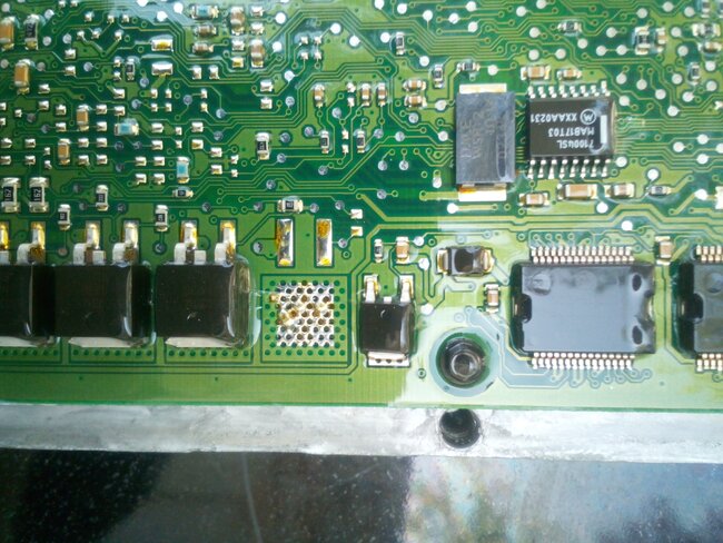

Ken, maybe you have a suggestion for me. I received the PCM back from the place I had sent it for repair. After reinstalling it I still get nothing. Cannot communicate with it through OBD2. No crank, no start condition. Checked the 5v reference and I am only getting 1.3v. Upon inspection inside the PCM I cannot determine what was repaired or replaced. I did find 2 spots that looked as they may have been missing chips so I took pictures and emailed the company. Now I have no idea if these are spots missing chips or not but they certainly gave me pause. I will attach the pictures I sent the repair company. The company had said the issue with the PCM was found and repaired but never said exactly what they found or repaired. They also didn't respond with anything when I brought up the 2 spots on the board so I can only guess that is not an issue.
Do you have any suggestion on where I should send this to be repaired? Reason I was trying to have it repaired instead of replaced is that I am under the impression that I would have to have 2 new keys cut and programmed if I replaced it due to the pats. I was only provided 1 key when I purchased the vehicle. So, in order to program 2 new keys I would have to first obtain a second key, have it cut and programmed. Would the vehicle need to be towed to a dealership in order to program the second key? Then I would have to buy the new PCM and 2 new keys, have the keys cut, and then I believe as long as I have the 2 "first" keys I could reprogram the "second" 2 keys. Suggestions on where to have the PCM sent and repaired would be greatly appreciated. Info about what is required if I had to replace the unit would be helpful as well. Thanks again for any help with this matter.
Here is what I send and received back as far as email goes:
SENT: Today I received back a PCM for a 2003 Ford Escape and it is not working. Still am unable to communicate with it through OBD2 and still not operational. Upon inspection I am unable to determine what was replaced or repaired on the board. I do find 2 spots that look as if they may be missing chips possibly? I have taken pictures and will attach those. When this was shipped I included a very detailed explanation of everything that was tested to ensure that no other problems were present.
RECEIVED: OK. You can send it back or I can issue a refund. There must be an intermittent or latent fault inside the computer. The nature of intermittent faults is that they appear and disappear at random, and therefore make it very difficult (sometimes impossible) to detect. It tested OK after we worked on it, but it just might not have been failing then. Or, there could be something wrong with our equipment. If you send it back, there is a possibility that the damage is too latent or extensive for repair.

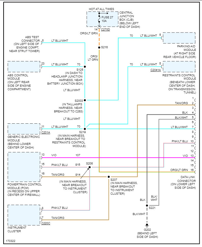

Thanks for the images, if you are getting power and ground to the PCM I would get a rebuilt unit and not have it repaired, because like you said the intermittent problems are difficult to detect. Also, here are the wiring diagrams for the ALDL connector so you can check for power. Also check the battery connections as well and make sure the battery is good and charged. You can get a preprogrammed unit by searching Google or Ebay. Check out the images (below). Please let us know what happens.
Monday, May 15th, 2023 AT 9:44 AM

Problem Solved: Turns out that there was a wire broken for the EGR Pressure Feedback Sensor. When unplugged and tested it must have been making contact. Thank you, Ken, for your help and input with this matter. I greatly appreciate it.
