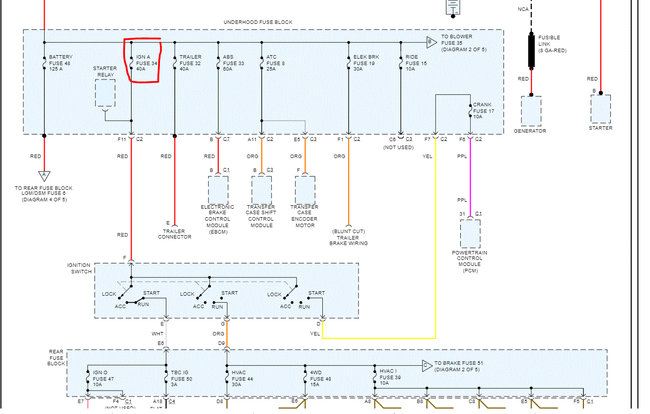

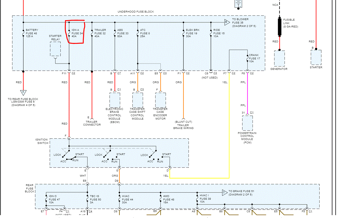

Hi, no power to gauges in cluster, but do have warning lights, fan motor wont run, no power to windows or key-less entry no radio. The engine will turn over if I jump the starter relay.

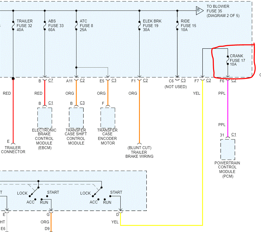

Okay. I need you to check a couple fuses for me first. I attached two pics. The first pic shows Ignition fuse A. It is located under the hood in the fuse box. Fuse number 34 (40 amp). In addition to checking the fuse, make sure there is power to and from it. Also, check the starter fuse in pic 2.
In addition to this, I need to know what all is working. For example, do the headlights, turn signals, hazard, horn, wipers and anything you can think of work? I am looking through 6 pages of power distribution schematics and trying to determine where the break is
Here is a link you may find helpful when testing:
Let me know. Check out the images (below). Let us know what you find.

Okay, so I checked those fuses. (17 and 34) both are good, Both are giving me green on the test light, while I was there I checked the fuses close by and noticed fuse 35 (blower) was blown.

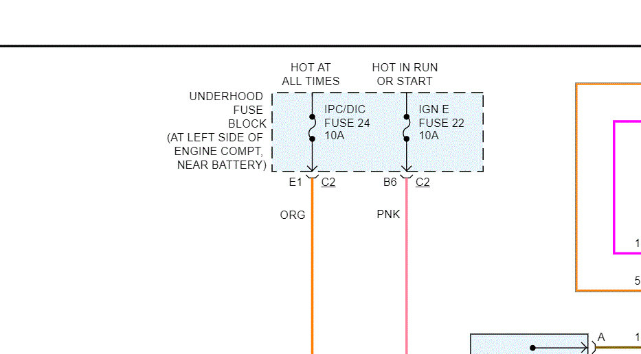

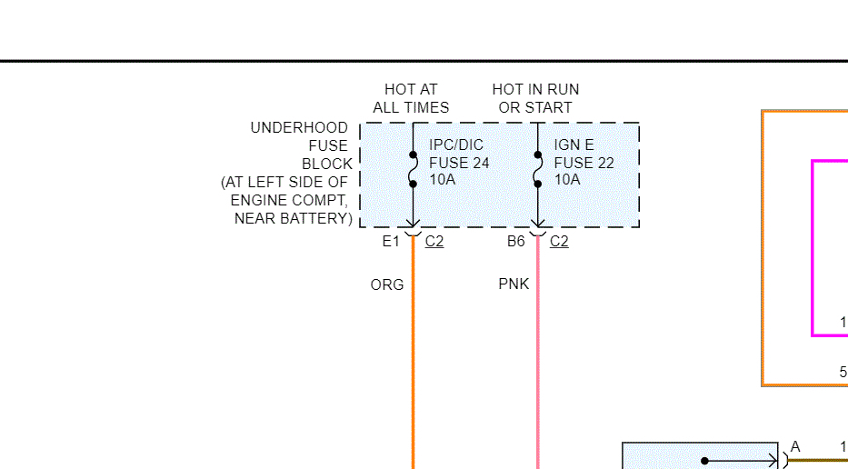

Check fuses 22 and 24 in the under hood fuse box. See attached picture.

Hey Joe, 22 and 24 are good!
Saturday, April 11th, 2020 AT 10:54 PM
  • 110,194 POSTS

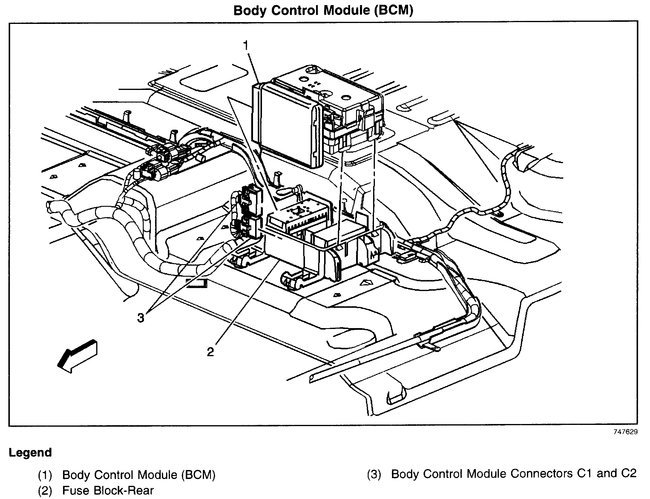

Okay, I'm not liking this. Those fuses power the instrument panel which isn't working. Now, make sure the connector at the body control module is tight, not corroded, or damaged.
See pic 1

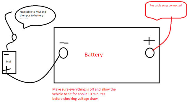

What I need you to do is this. Remove the negative battery terminal and charge the battery. Next, place your volt meter or multi meter between the battery negative terminal and the negative battery cable without connecting it. Let me know how many volts show up.

I checked the connections on the BCM and checking all the fuses for connection and power, everything looks good there.
But i'm not sure I understand what your wanting me to do with the battery and multi-meter. Do you still want me to keep the positive connected? I just left the positive connected and tried not to touch anything with the negative, it was bouncing between 1? And 3 volts. (If I was doing it right.)

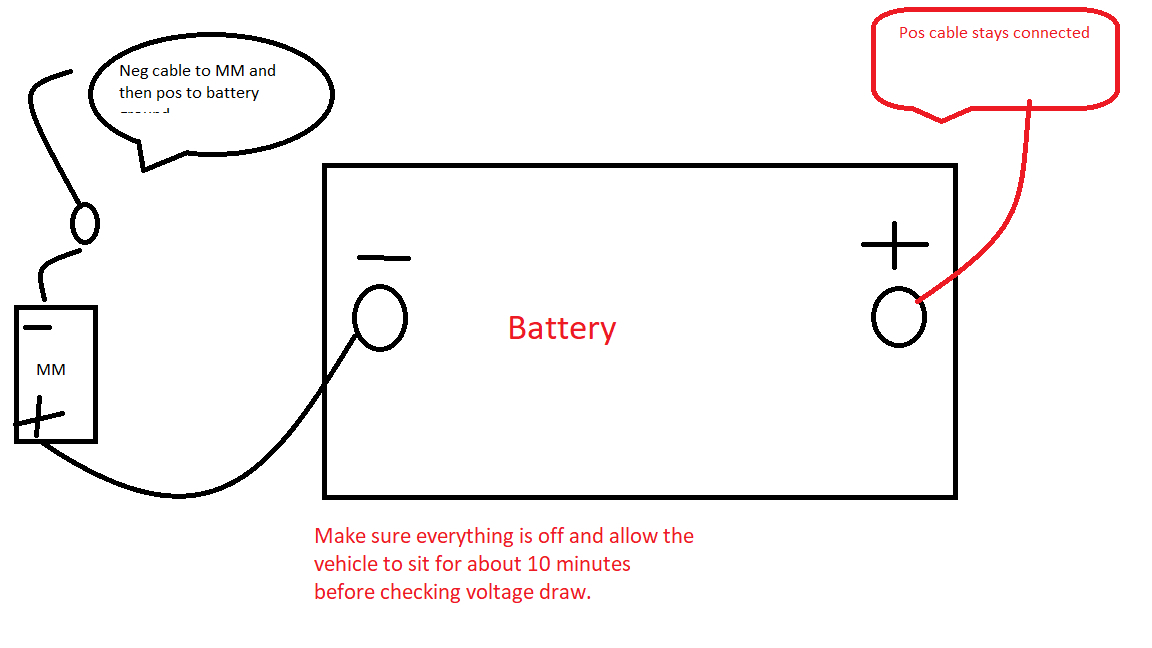

I drew a sad pic of how to set it up. Take a look at it and let me know if it makes sense and helps.

Okay, so I did that, and it just reads 00.0, but I tried to start the vehicle again just because, and the battery was dead again, but the dash lights, interior lights, and headlights were flashing, and a bunch of relays in both fuse boxes was clicking out of control.
As I'm typing this, I kept hearing a faint noise. I thought it was something outside my garage, got to see what it was, and it was coming from my vehicle, the cluster lights are flashing, and the doors are trying to lock and unlock. (Ignition is off and keys aren't in it) but the window did work this ti, me. (Which hasn't worked since we started this journey)

I pulled the # 24 10 amp fuse for the IPC/DIC and the flashing of the cluster stopped and the doors stopped locking and unlocking. Could all of this be because of a bad cluster or are there multiple things going on?
Thursday, April 16th, 2020 AT 10:57 AM
  • 110,194 POSTS
Was the battery dead when you checked for the draw? There should always be some amount of draw and you indicated there was none. Also, if the battery was extremely low, it can cause HVAC with relays and other control circuits. If you have recharged it, has it stopped clicking? If so I would change out the cluster. This video can help walk you through the steps.
