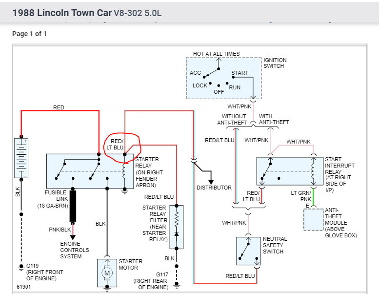

The car, (sitting in garage for a few months) does not crank, replaced the starter and solenoid but still no luck. (Motor is not seized)
When you turn the key, you get just a clicking under the dash (glove box area) when you put the key in the start position.
Even tried starting the car in neutral to no avail.
Any advice appreciated. Thank you.

If you hear a click on the right side of the dash, that is likely the starter interrupter relay. If it clicks, it's actuating.
Here is what I need you to do: Locate the red wire with a light blue tracer on the starter solenoid. Have a helper turn the key to the start position. Does that wire get power? If it does, do the same thing with the black wire at the solenoid. If that shows power with the key in the start position, go to the starter motor and the black wire is what triggers the starter motor. See if it has power at the starter with the key in the start position.
Let me know. Also, I attached the starter wiring schematic below, so you have a reference.
Let me know what you find.

Yes, that is correct. The relay on the inner fender. If you look at the picture, note there is one wire direct from the battery and another power wire from the key/neutral safety switch. The one wire which is solid red is hot at all times. The red with a light blue tracer will only have power when the key is in the start position. Once that occurs, the black wire (the trigger / power wire to the starter motor) is energized and the starter should engage.

I have no power at any of the aforementioned places you mentioned.

If you have no power to the solid red wire at the relay, either we have a broken wire, a dead battery, or no connection at the battery. The solid red wire should have power at all times.
Make sure the connections are good at the battery as well as the cables, including the ground wire. If we have no power to multiple places, I suspect one of the wires at the battery isn't making a good connection or even the ground to the body and engine block is faulty.

It could be the ignition switch. However, you said there is no power at the relay coming from the solid red wire. That is where the likely problem is. That should have power at all times. The red/blue should get power when the key is placed in the start position.
Have you been able to trace the red wire to see if there are any issues?
