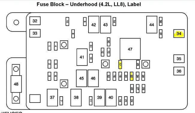

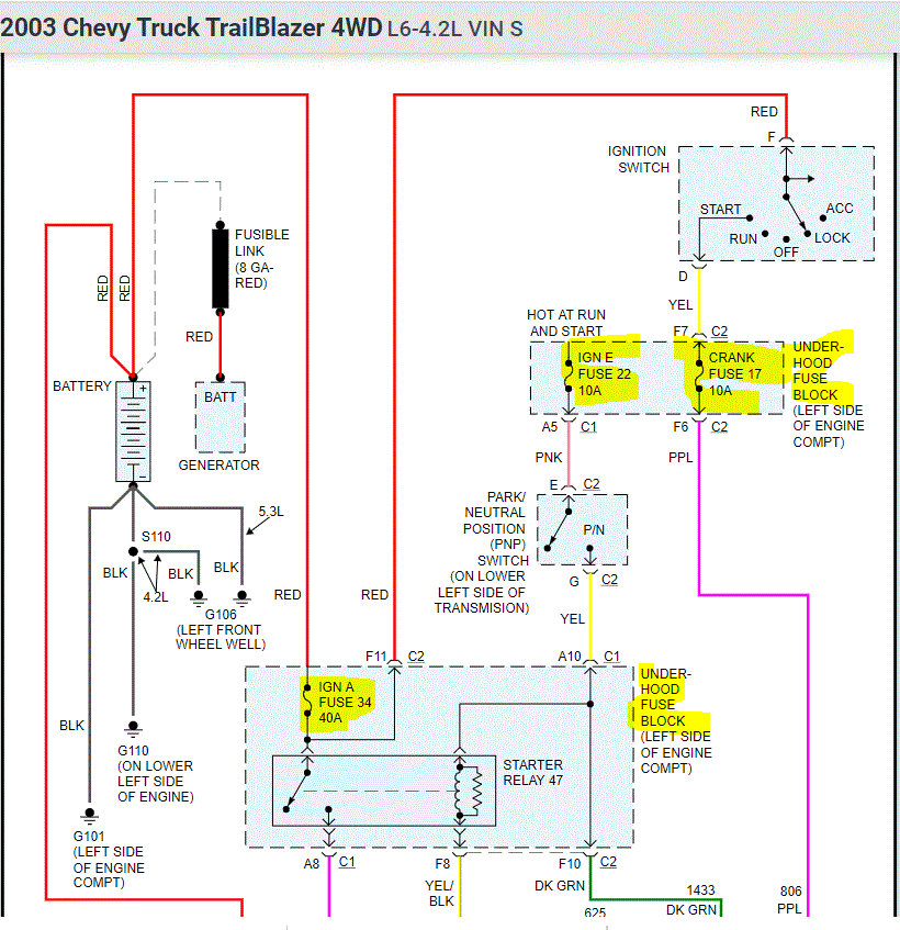

I replaced battery, ignition switch, ignition relay and starter. Still nothing. All fuses look great. Any ideas? I'm 61 year old lady that works on my SUV but I'm dumb founded on this one. Please help me.
Wednesday, December 23rd, 2020 AT 1:06 PM
  • 110,194 POSTS
We need to start by checking three different fuses. However, just for the heck of it, see if it will start in neutral.
Pic 1 below shows a portion of the wiring schematic related to the starting system. I highlighted three fuses which are all located in the underhood fuse box. Pic 2 shows their locations.
Now, in addition to checking the condition of the fuse, I need you to check if there is power both to the fuse and out from it. Here is a link you may find helpful:
Do this and let me know the results.
