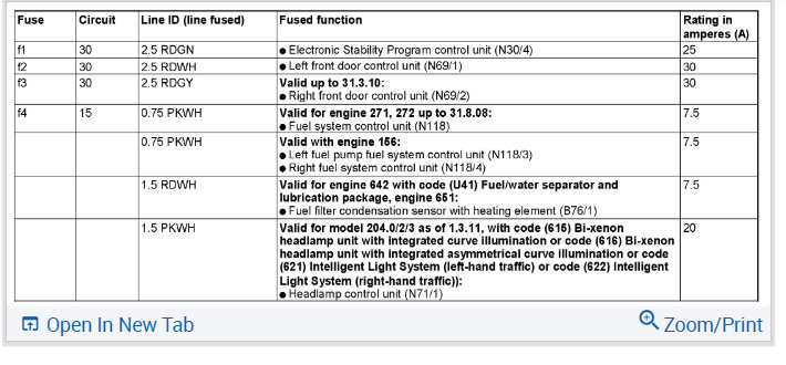

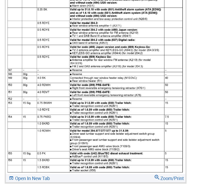

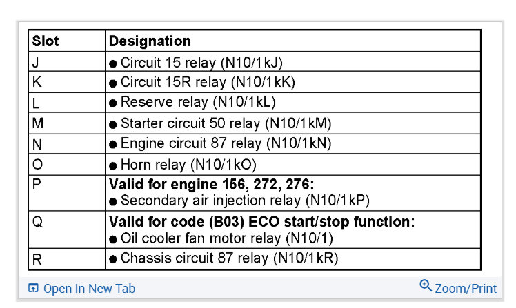

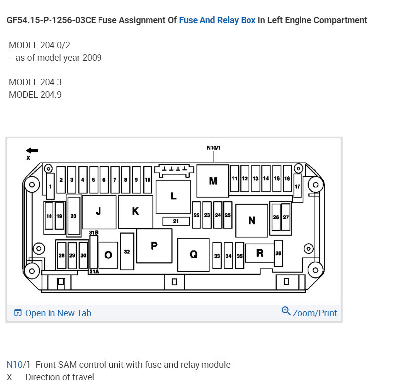

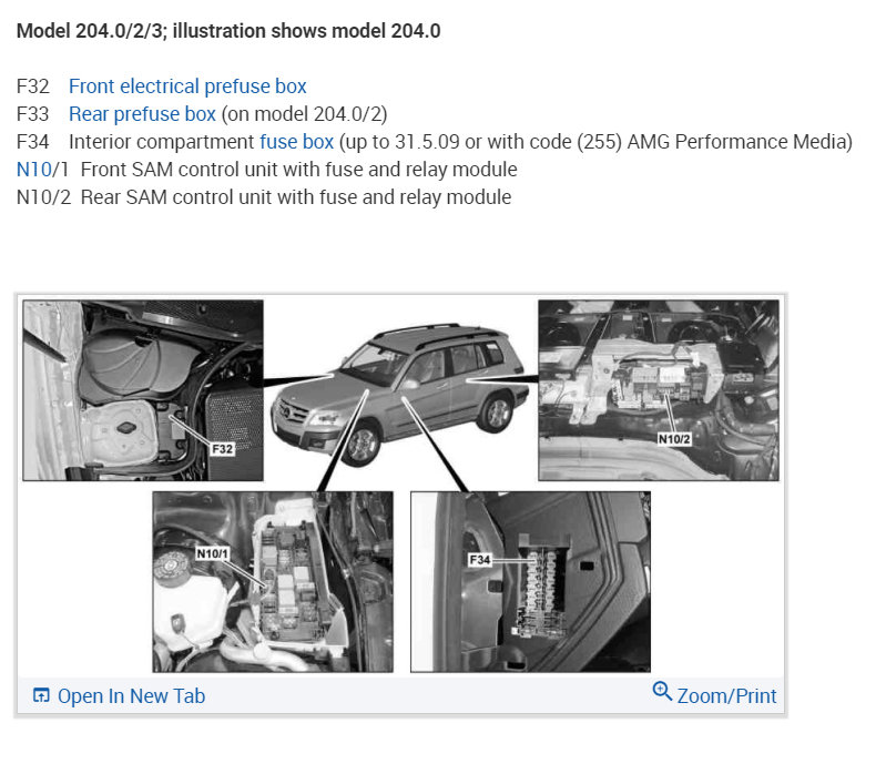

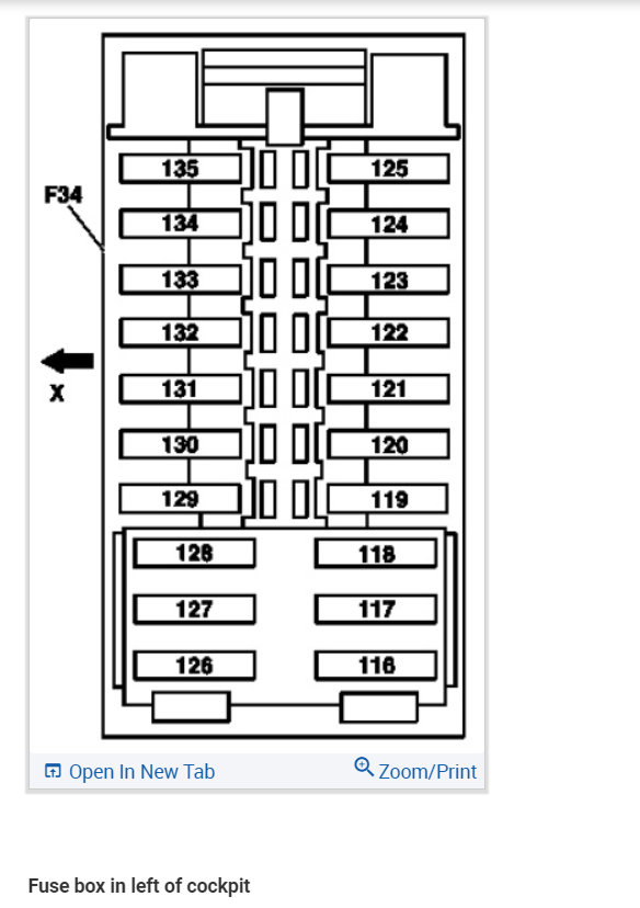

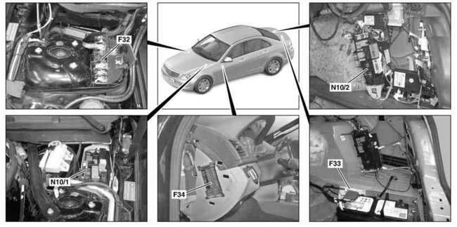

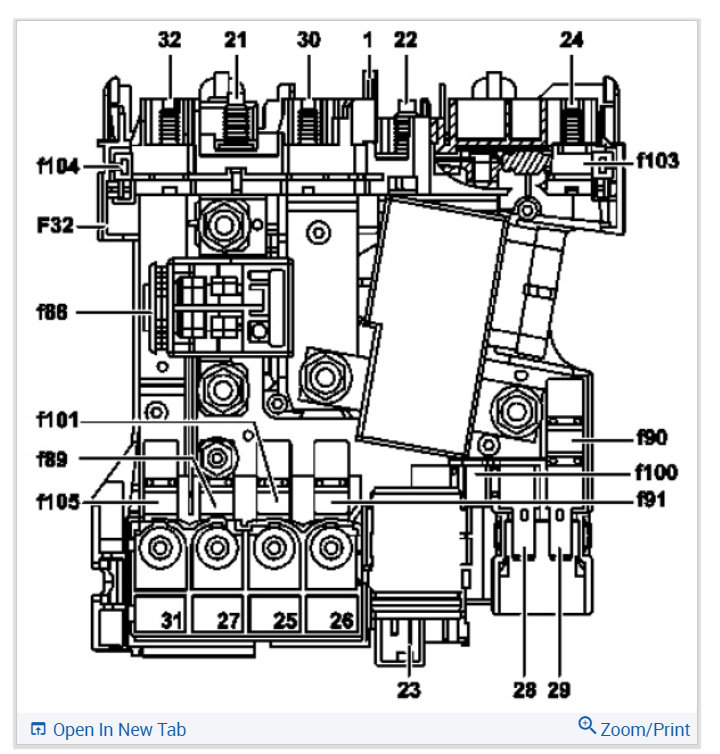

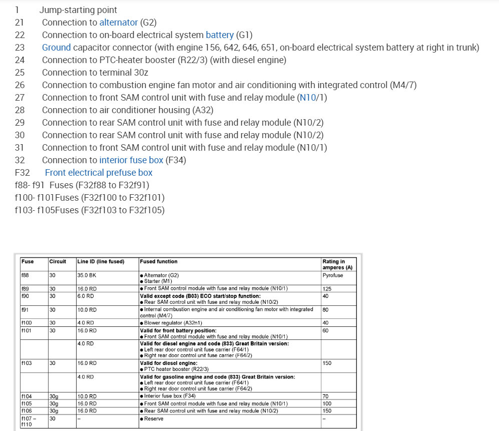

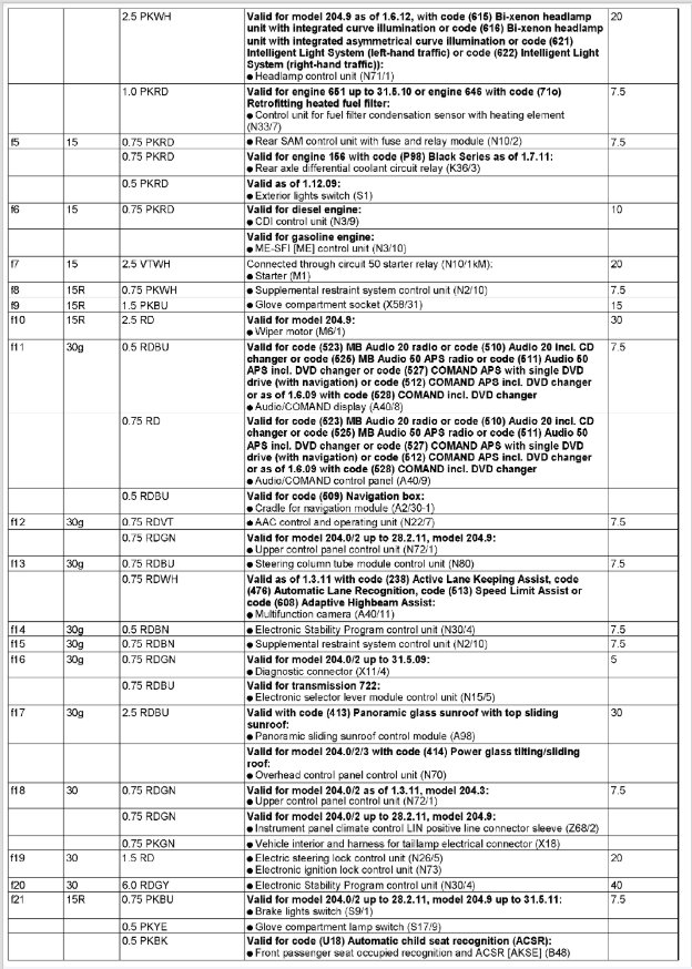

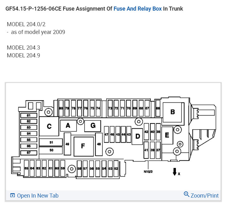

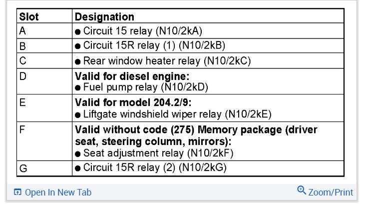

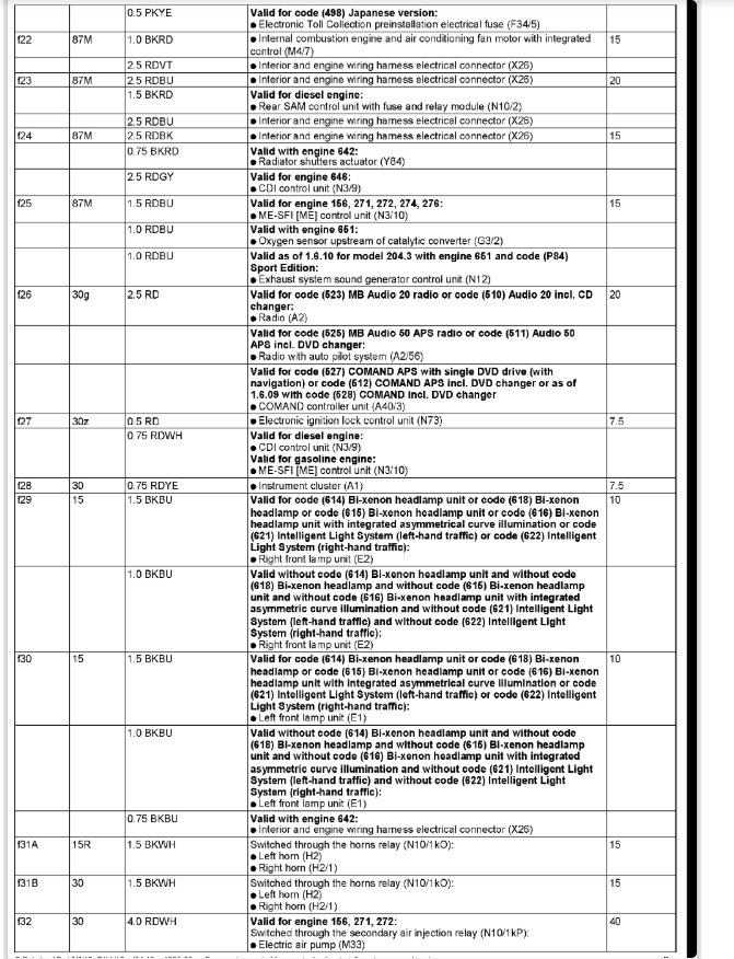

Is that the code? No-communication with transmission control module What is the number please? Lets begin by checking the fuses. Here is a guide to show you how and the fuse locations and definitions for your car below:
Here are all fuse and relay locations for your car please check the fuses with the key on. Check out the diagrams (below). Please let us know what you find. We are interested to see what it is.

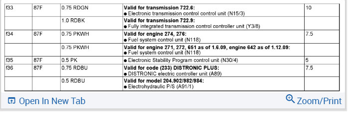

Fuse #33 10 amp (front SAM control) check with the key on does it have power?
