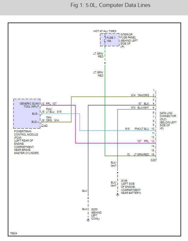

I have tried several scan tools with the same result no communication. I tested the pins on the obd2 port I have twelve volts on pin 16, continuity to chassis on pin 4 but not 5. I have no voltage or continuity to chassis on pins 2 and 10. I even tried a different ECM with no change. So I found the same color wires as pin 2 and 10 on the connector to the ECM and there was no continuity. That is all I know and I am at a loss and need some help.

You must be losing connection somewhere. Here is a guide to help you test the wiring:
And the ALDL wiring diagrams to help see how the system works.
Please run this test and get back to us.

Okay here is an update. I am pretty sure the OBD port is disconnected somewhere on the way to the computer. On the bright side I found the EEC-IV data link connector in the engine compartment and jumped the (T/O) wire for circuit 914 and the (PK/LB) wire for circuit 915 to pins 2 and 10 on the OBD port. One reads five volts and the other 0.27v. I still got no communication is this because pin 5 is not grounded? If so does it need to be grounded to a wire coming from the ECM or is the chassis fine?

I think you found the problem number five must be grounded. You can create own own ground to tap into the circuit.

Okay, so I now have every wire on the OBD-2 port jumped to their matching colors on the ECM and seem to have all correct voltage a resistant readings no shorts detected, but I still get no communication. I now again tried changing ECM's still nothing. Also let it be known I am using an Innova 3100 diagnostic tool.

I just tested it on my 2009 Ford focus and no problem communicating. Do circuits 914 and 915 have to connect to anything other then the PCM to get a reading. As I said before they did not seem to get a connection into the cab to the odb port so I jumped the wire directly to the PCM. So maybe it is not connected to some other device in those circuits. Also, this van also has four wheel ABS system and the ABS light has been on and I cannot communicate with that control module either.

Can you confirm you have power at 16? And ground on 4 and 5?

Yes 4, 5 are grounded 16 has 12v and 2 has 5v and 10 has 0.27v and 13 has 0v.

Yep that's everything sounds like you have a computer that is down. I would try plugging in a used one to see what happens.

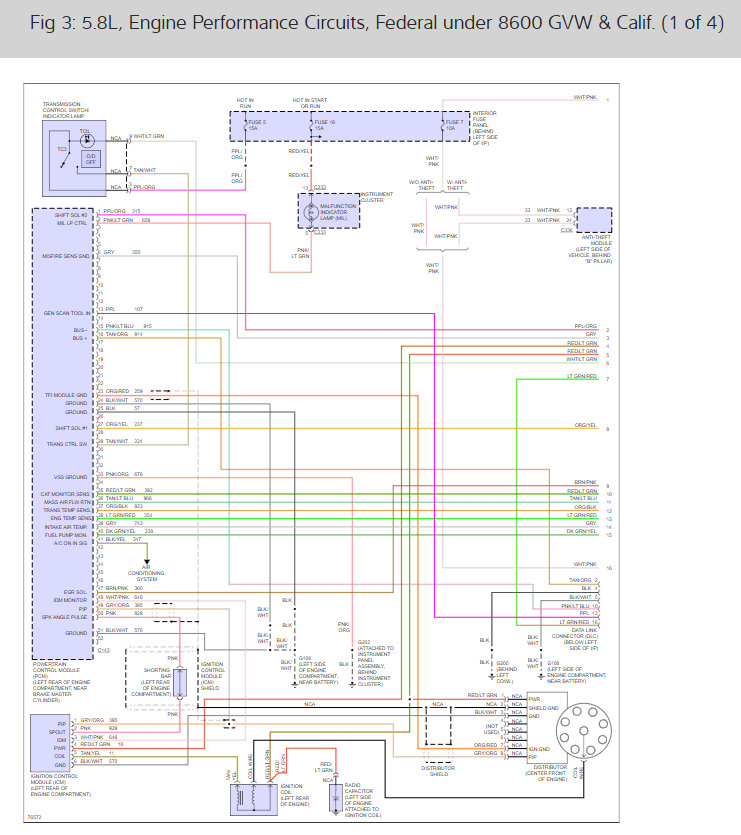

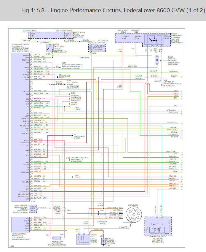

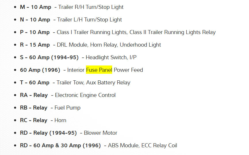

Okay the computer must not be powering up here is a wiring diagrams for the PCM please check the power and grounds.
Check the PCM power relay

I don't know if that is the right diagram I have a 104 pin PCM
-1
Monday, April 2nd, 2018 AT 12:32 AM
KEN L
  • MASTER CERTIFIED MECHANIC
  • 55,266 POSTS
Okay here are the other options for every engine they show. Are you viewing these on a mobile device?

Scanner will not link with vehicle. Tested OBD II connector and do not have ground at pin 5 (signal ground). Can this be grounded or does this ground through the PCM? (PCM just replaced with a cardone re-manufactured unit)
Tuesday, August 25th, 2020 AT 5:06 PM (Merged)
PATENTED_REPAIR_PRO
  • 1,853 POSTS
It is supposed to be grounded to G106 which is lower right front of engine compartment on frame rail.
