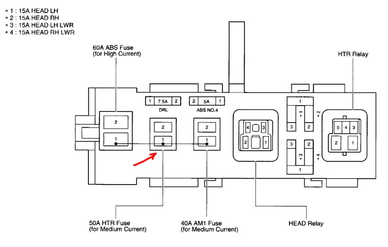

No Blower Motor. How to check 50 amp htr fuse and htr relay in engine compartment? Have dmm but unable to remove fuse or relay to test.

Here is how to test the 50-amp fuse as requested:

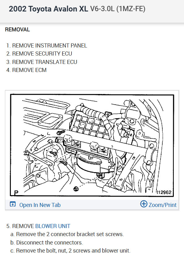

Here is the location of the blower motor and how to change it out in case the fuse is okay, and the blower has power and ground. Check out the images (below). Please upload pictures or videos in your response of any problems so we can see what to help you with.

Fuse looks good visually and relay clicks with key in On position.

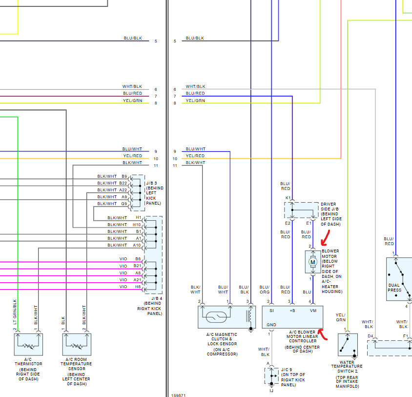

I'm getting +11.77 vdc at blower motor connector with key in "on" position.

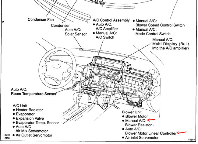

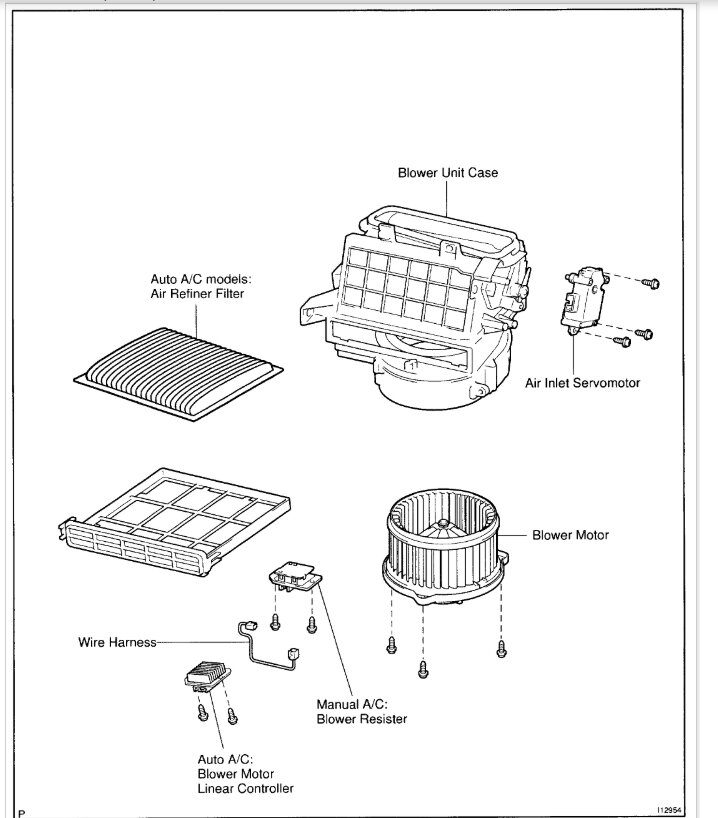

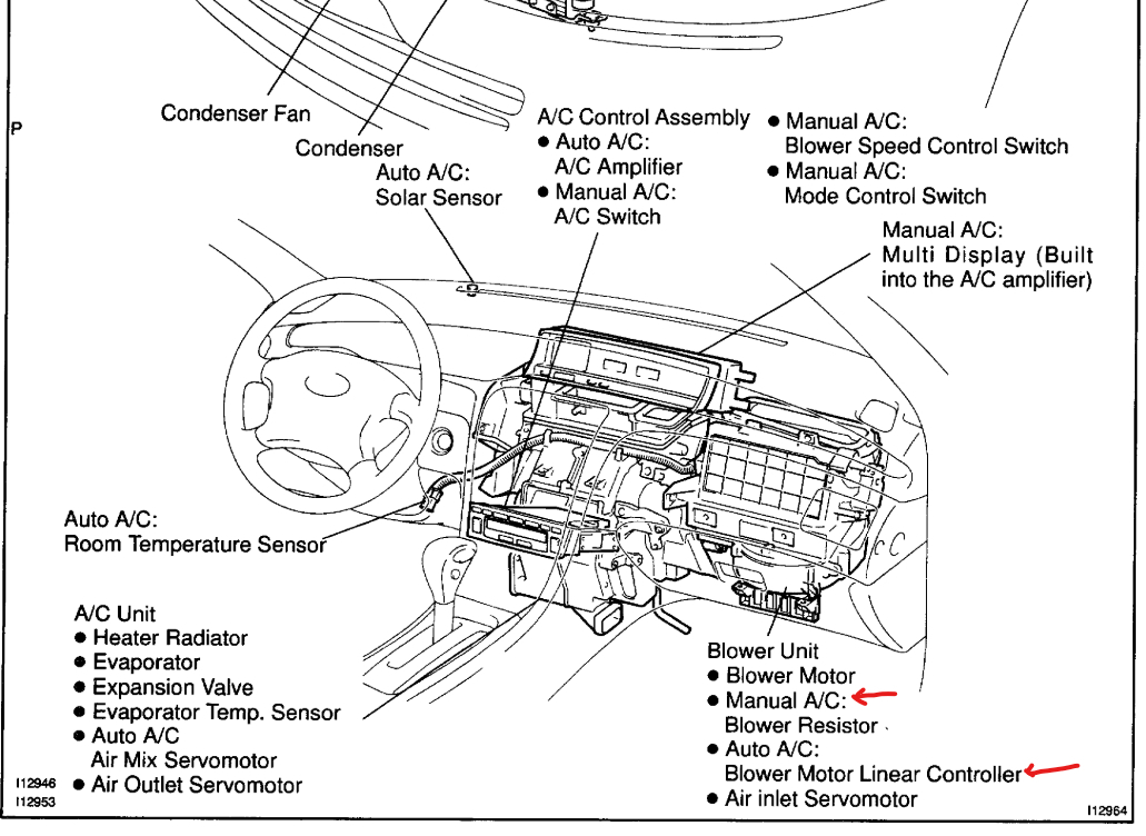

Okay, then the liner controller behind the center of the dash sounds like it has gone out. Here is the location so you can swap it out which should fix the problem. Check out the images (below). Please let us know what happens.
Sunday, December 8th, 2024 AT 9:51 AM

Check resistor also? If so, how to test? Can linear controller be tested?
Monday, December 9th, 2024 AT 7:00 AM
KEN L
  • MASTER CERTIFIED MECHANIC
  • 55,488 POSTS

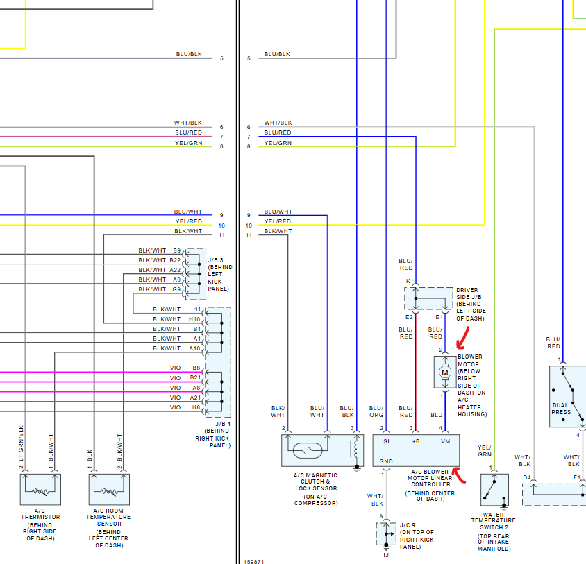

I don't know why they say resistor and then a linear controller, it must be one is for the auto system and the other is the manual system. Here is the wiring diagram so you can see. I would bypass the controller to ground and if the blower starts working you have found the problem.
Monday, December 9th, 2024 AT 8:52 AM
CA7922303
  • 165 POSTS
Can you be specific per the wiring diagram, how to bypass the controller to ground? Thanks.

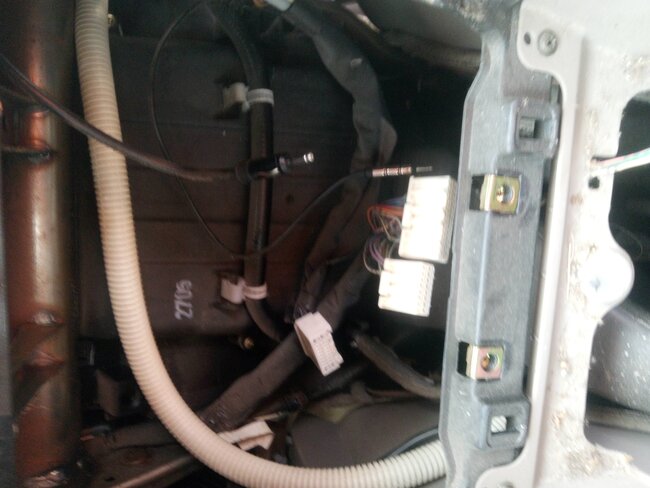

CA7922303
  • 165 POSTS
Wiring diagram shows linear controller behind center console. Removed a/c controls/radio and only see connectors, no component.

Yes you can ground the blue wire at the blower motor, and it should run, also it looks like the controller is lower in the HVAC assembly which can make it under, can you look lower?
Friday, December 13th, 2024 AT 1:01 PM

Disconnected the resistor connector, reconnected it, put everything back together and now have blower motor operation. Never did find linear controller, but the wiring diagram for the controller was what was plugged into back of resistor. Is it possible that controller on this one is the resistor?

Yes, it could have one or the other, I would check the connection for overheating, also, when blower motors go bad they will start and stop like that FYI.
