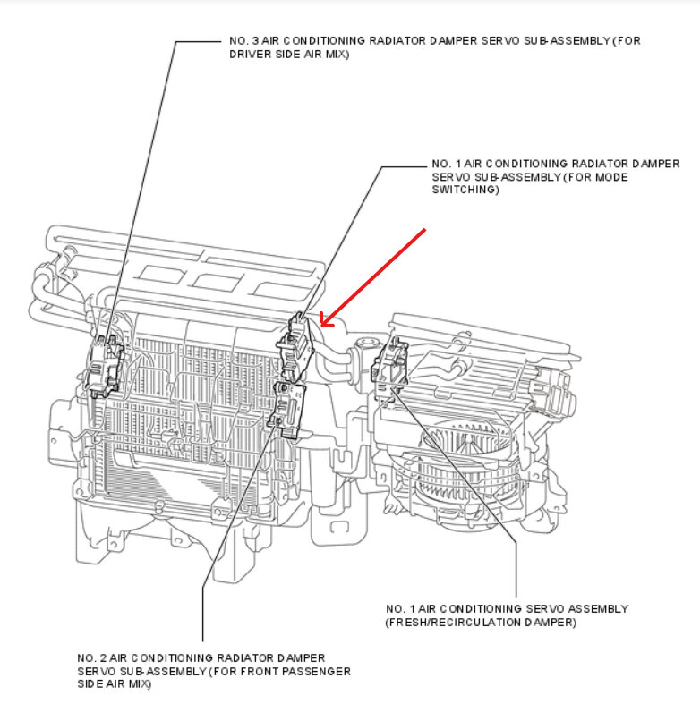

Mice ate up the cabin filter. I cleaned it out & replaced the blower motor but now there is no airflow even though the fan runs.could it be the blower door actuator? Where is that located?
Apr 17, 2026 at 4:04 PM
  • 54,487 POSTS
Yes the mode actuator can cause this issue, you can remove it and then while still being plugged in work the HVAC controls (engine on) to see if the actuator moves. Here is a guide to help and the location of the actuator in the images below.
https://www.2carpros.com/articles/low-or-no-air-flow-from-vents
Check out the images (below). Let us know what you find. Ken
