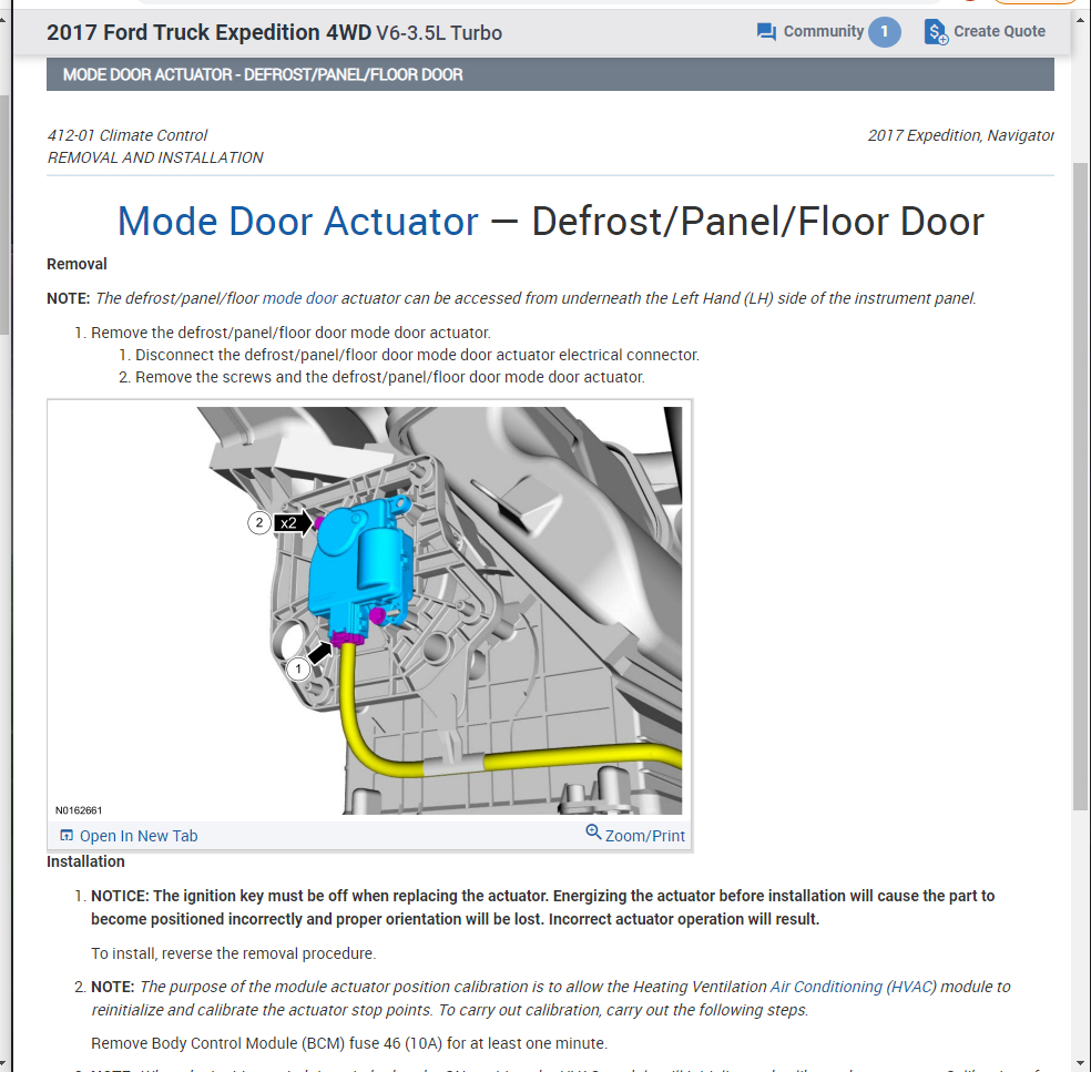

I have no air from front vents . Back works fine, but zero from front.
Jun 26, 2021 at 9:21 PM

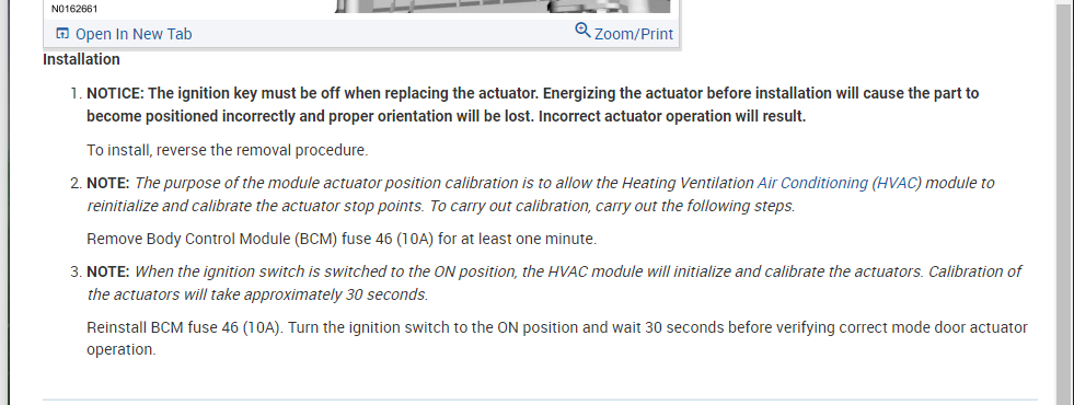

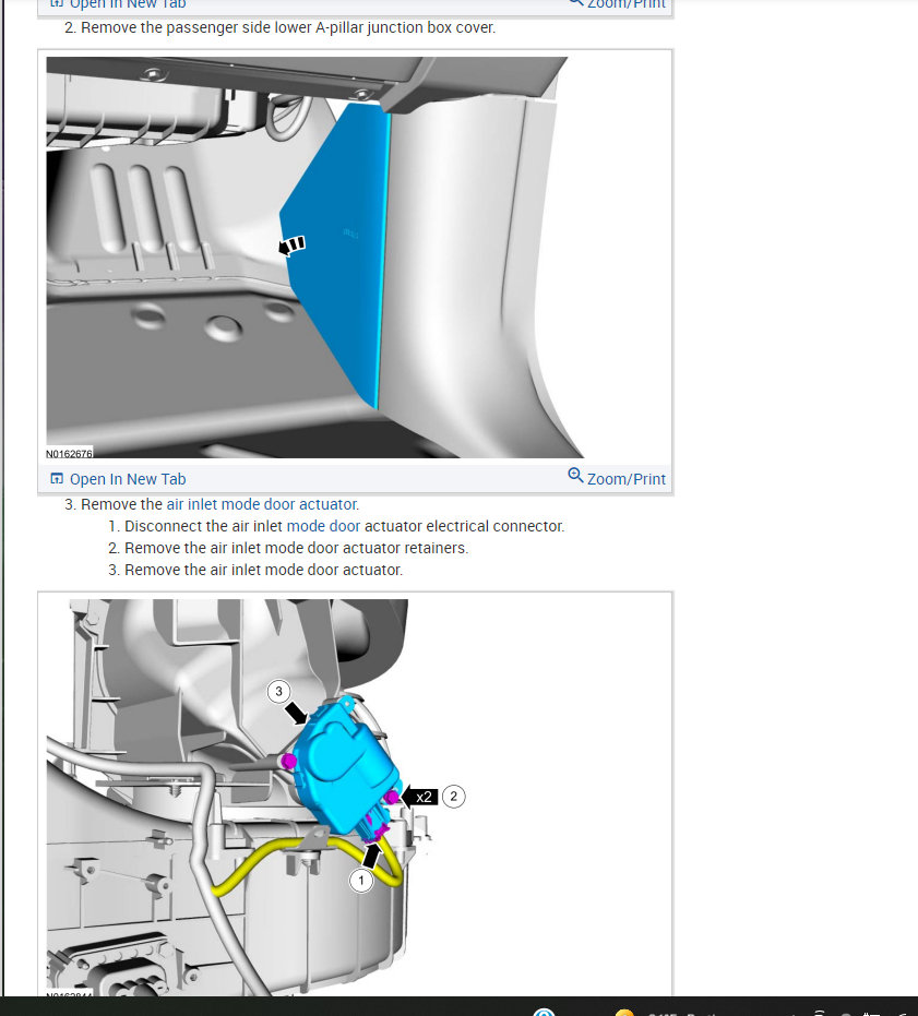

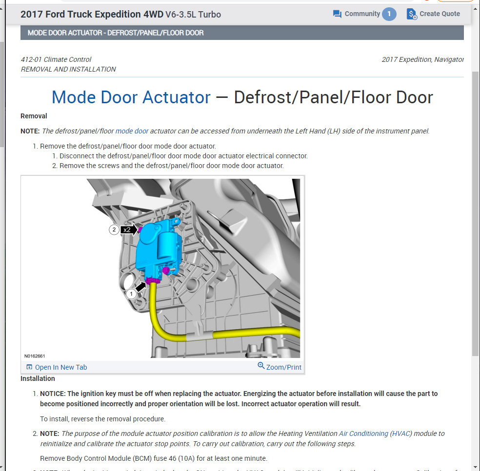

This is usually always a mode door actuator as this is what controls the direction of the air flow. However, you have two mode doors. One that controls which vent the air comes out and then one for the air inlet.
https://www.2carpros.com/articles/low-or-no-air-flow-from-vents
I suspect the air inlet actuator is the issue is the issue but we need to inspect both doors and make sure they are moving. So access them and then change the position from defrost to the floor and see if they move. The air inlet should move when you change the position and switch from fresh to recirculate.
So we need to make sure they are working and replace them accordingly.
Please let me know if you have questions on this. Thanks
