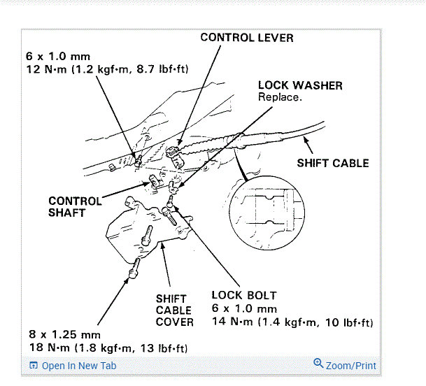

Good morning,
Do you mean you can shift to drive and no further?

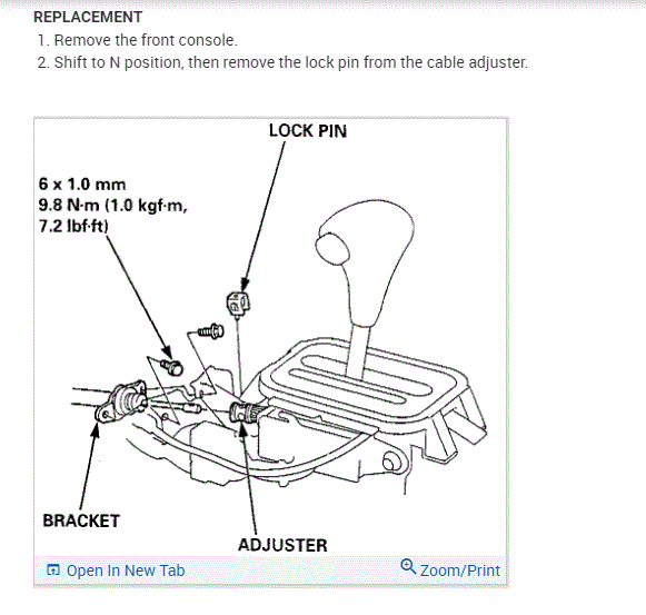

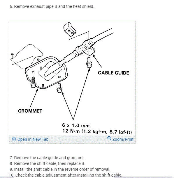

This sounds like the shift cable is seized internally.

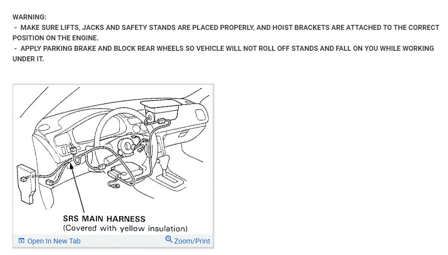

I attached the procedure for you of the replacement below
Let us know if you have any other questions.

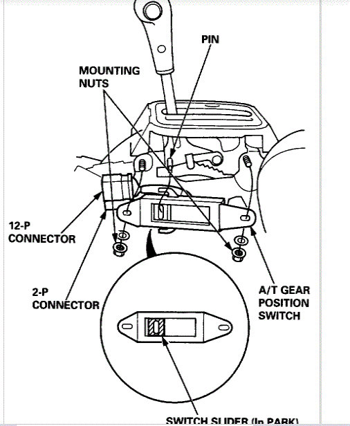

I attached the location of the transmission position switch for you.
See if there is any damage to this switch.

I was dirty so I cleaned it. The shifter lock has to be pushed to get the shifter to move.
Saturday, May 21st, 2022 AT 6:59 AM
Cleaning does nothing. It is not reading correctly and must be replaced.

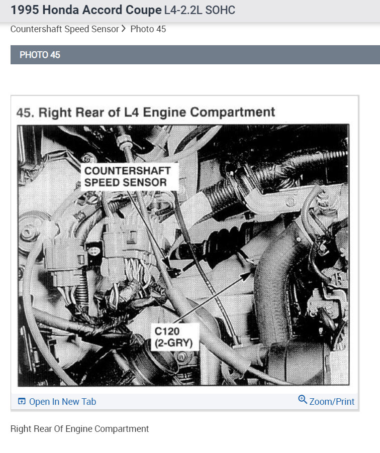

Okay, so far, I have done the drain and fill. I have replaced the VSS and TCM. I have 2nd gear and reverse. 3rd and 4th gear acts like neutral. All gear position lights work properly.

So physically you can move the shifter, but the transmission does not respond, correct? I have seen the counter shaft speed sensor cause strange issues. The fluid is not full and not burnt, correct? Here is the sensor location so you can make sure it is plugged in. Check out the diagrams (below). Let us know what happens and please upload pictures or videos of the problem.
