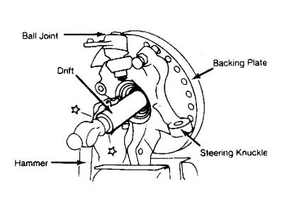

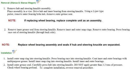

What is the procedure to replace front wheel bearings
