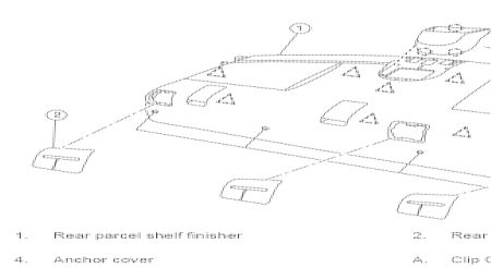

I want to replace my rear speakers, but can't figure out how to access them.

Need to remove rear parcel shelf see diagram

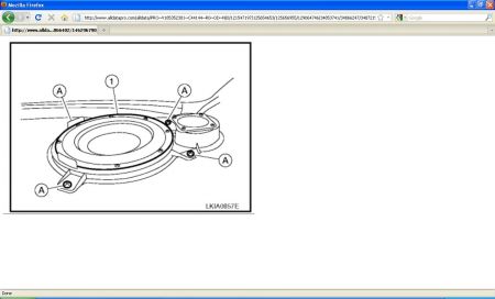

REAR SPEAKER
Removal
1. Remove the rear parcel shelf finisher.
2. Remove the rear speaker screws (A), disconnect the rear speaker connector and remove the rear speaker (1).
Installation
Installation is in the reverse order of removal.
There you go.
