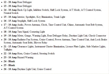

1992 Nissan Stanza 4 cyl Two Wheel Drive Automatic
just bought car all works except Horn and Cruise Control. Any connection? If not how do I trouble shoot Cruise control and Horn?
ernie
Tuesday, November 4th, 2008 AT 8:01 AM
IMPALASS
  • 3,112 POSTS
Hello
I have attached what some of the fuses do. It looks like fuse 22 controls the horn and cruise. Check that fuse with an ohm meter. Visual isn't always good. The fuse panel is located on the left hand side of the instrument panel.
Let us know if this doesn't fix it.
https://www.2carpros.com/forum/automotive_pictures/248015_Fuse_1_2.jpg
