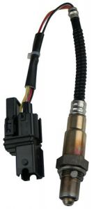

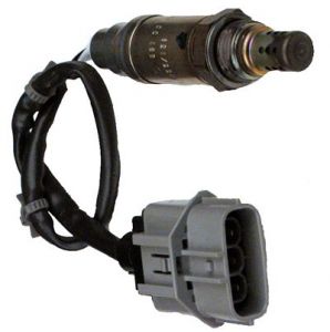

Having idle problems. Changed the cam sensor, but i'm still getting the code PO154. Any suggestions
Thursday, November 13th, 2008 AT 1:21 PM
ZACKMAN
MECHANIC
4,202 POSTS
P0154 is for your O2 sensor, front right.
Bosch 15955 if non CA (clean air) package (3 wires)
Bosch 15372 if CA package (4 wires)
As for your idle problem, describe the problem a little more detailed.
