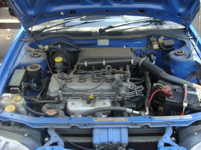

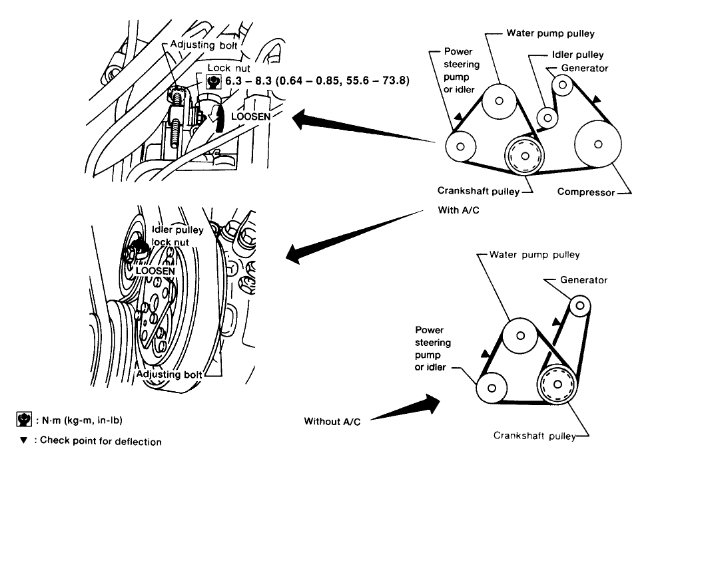

Ive loosened the lock nut and adjusting bolt and still can't get the pulley to release the old belt. Is there a pivot point/bolt or am I just missing something? And, is there a diagram to show me this? Thanks again guys.

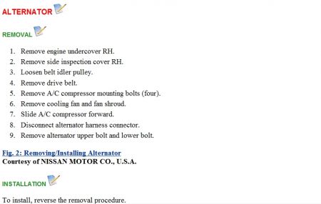

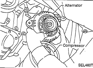

The belt has an idler pulley that keeps it tensioned, loosen that pulley.
Here is a guide that will show you everything you need to see to change the alternator and all belts in this scar.

1.6L GA motor..
https://www.2carpros.com/forum/automotive_pictures/261618_Graphic2_103.jpg

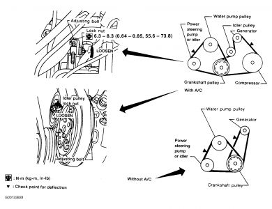

Hi. I have a 1998 nissan sentra, 1.6 L. I need to replace the power steering belt. I have the part, it's just that getting in there to loosen off the worn belt is a really tight fit! How can I squeeze in there, and how can I replace it with a new belt? Do I have to jack up the vehicle and do it from the underside?

Hey PARAONZE,
Replacement of the belt is a straightforward job. You need to loosen the alternator adjusting bolt and pull at the belt to loosen it.
Here is a guide that will help along with a diagram, please let me know if you know anything else.

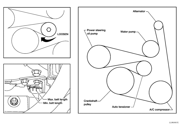

Replace alternator belt?

Rotate the belt tensioner in direction of arrow and remove belt from pulleys. Install new belt according to belt direction.
