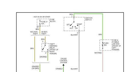

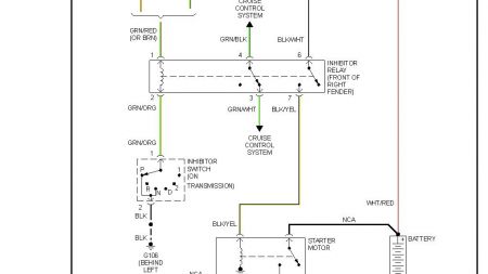

I turned the key, and I heard one click sound and the car would not start.
Friday, June 20th, 2008 AT 8:12 PM
MECHANIC
75,992 POSTS
Check the battery and connections-if okay possible causes are starter, starter inhibitor relay, tranny inhibitor switch and ignition switch.
