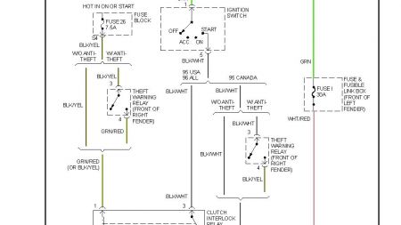

The car started up when I left work to go the store. When I got back in the car, it now does not want to start. The interior lights, radio, and A/C come on, but when turning the ignition it does not start. The battery, alternator, and starter were all replaced about 5 years ago. We tried jumping and we even tried using a power supply box, still would not start. What do you think could be causing the car not to start?

Do you mean it cranks and refuses to start or just won't crank at all -nothing?
Wednesday, August 20th, 2008 AT 11:34 AM
JAY HANSEN
The car will not crank at all. You turn the ignition and nothing.
Wednesday, August 20th, 2008 AT 11:40 AM
  • 75,992 POSTS

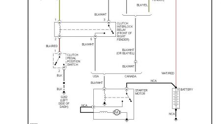

Okay-check fuse no.26 7.5amp if okay-find the clutch switch at the clutch pedal arm/bracket disconnect it and jump the connector and attempt to start-still nothing see probable causes in the starter EWD below
