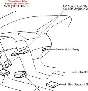

Hello, I'm having trouble locating the blower motor relay on my 2000 Maxima. I purchased a Haynes manual but it was no help at all.I believe it's some where under the driver side dash . Please help if you can.Thank you!

Hello, It is located on passenger side under dash
https://images.2carpros.com/forum/automotive_pictures/188069_00nissanmax_1.jpg
