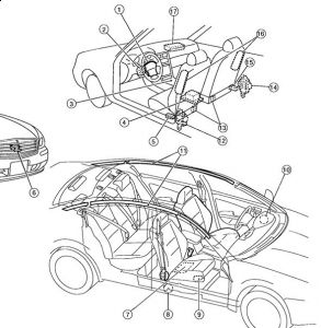

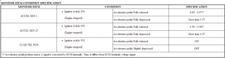

The p2138 has to do with the accelerator pedal position sensor circuit, which is consistent with the pedal message and the symptoms of no acceleration..
This car has no cable going to the throttle but rather a sensor on the throttle that picks up a signal from a sensor at the pedal.
https://www.2carpros.com/forum/automotive_pictures/30961_alyi_1.jpg
IF anyone has moved the throttle plate manually, then I would suspect the throttle position sensor at the throttle bore either needs to be relearned or replaced.
HAs the throttle bore been touched at all?

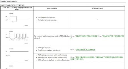

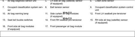

I'm not sure what code numbers you have but I have learned there is a problem with the wiring harness under the front seats and that has been a fix by replacing it.
"ASSIST A/B MODULE [SHORT] [B1068] or [B1073] Front passenger air bag module circuits [wires] are shorted to each other.
ASSIST A/B MODULE [OPEN] [B1065] or [B1070] Front passenger air bag module circuit is open.
1. Visually check the wiring harness connection. 2.Replace the harness if it has visible damage. 3.Replace front passenger air bag module. 4.Replace the air bag diagnosis sensor unit. 5.Replace the related harness."
IF it has been deployed, I also learned this:
"HARNESS CONNECTOR DAMAGE IS COMMON AFTER DEPLOYMENT. In particular, the push in locking device (usually black) gets damaged if not released before removing the connector from the bag. Driver side common melting problems requiring clockspring replacement. The locking device also serves to release the airbag shorting bars so, if they are damaged or missing, you will get a "short circuit" code. Try with 2ohm - 1/4 watt resistors in the harness side and clear codes."
For diagnosis, this is where we start:
Turn the ignition key on and foolow the air bag light for the following patterns and get back to me:
https://www.2carpros.com/forum/automotive_pictures/30961_nis4_1.jpg
Thursday, June 4th, 2009 AT 4:05 AM

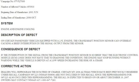

You need to call the dealer with your VIN and ask about any open recalls, specifically pertaining to reprogramming or the crankshaft position sensor.
This may not apply to your current problem, but a reprogram for free accompanied by a potential problem fix will be worth it. I am still working on the problem as you described.

I ran the VIN, and found out the car was involved in car accident in 07/2007 and the air bag was deployed, that s why I think it s not working now.
I have problems reading the attachment of the Airbag system and the three first indications are missing.
