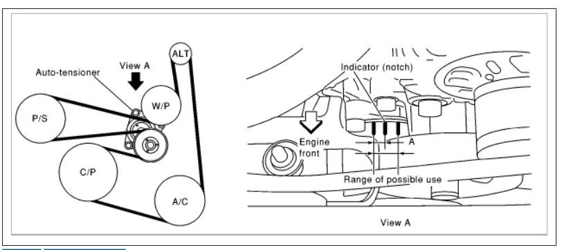

How do you replace the serpentine belt. I need a belt routing diagram. Please help me I need it and I love this site!

Here is a page that has the diagram you are looking for
https://www.2carpros.com/diagrams/nissan/altima/2002
Here is a guide on how to change the belt

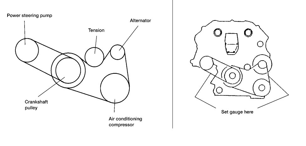

Here is a diagram on the serpentine belt replacement you asked for (below) I have included both engines in case someone needs them.
