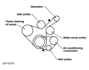

I need to know the correct way to install the alternator belt. I have it on, but I am not sure if it is correct?

A/C belt is on outer ring of pulley and has to come off first.

There is a tensionier that holds the belt in place. The automatic tenionier turns. Take a wrench and turn the tensionier in the direction to loosten the belt and slip the belt off.

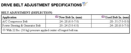

https://www.2carpros.com/forum/automotive_pictures/55316_97altimabelt_1.jpg
https://www.2carpros.com/forum/automotive_pictures/55316_97altimabeltdeflect_1.jpg
You have two serpentine belts. A larger one controls all but the AC pulley, an the smaller one runs that.

Once you have the manual, turn to page 1-17.
Adjustment - all models except the 2.5L engine.
Belt tension is adjusted by moving the idler pulley. To adjust the belt, loosen the lock nut (or adjuster) and turn the idler pulley adjusting bolt (usually on the bottom).
Replacement - all models except 2.5L engine
Loosen the drive belt adjustment bolt, slip the belt off the crankshaft pulley and remove it.
Remove the AC belt first to gain access to P/S, Alt, W/P belt. It is a very good idea to remove both belts at the same time.
Mark each belt and its appropriate pulley groove so the replacement belts can be installed in their proper position.

Belt broken so need diagram to replace

https://www.2carpros.com/forum/automotive_pictures/261618_Graphic_227.jpg

https://www.2carpros.com/car_repair_information/tec_info/1997/nissan/altima/1997_nissan_altima_drive_belt_routing_diagram.htm
'98 should be the same
