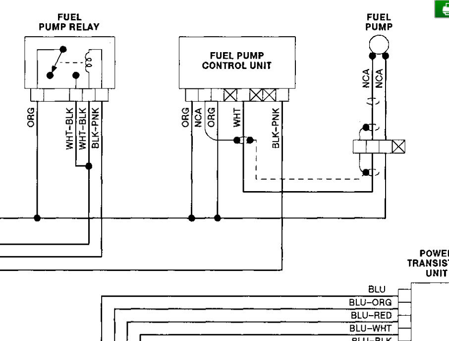

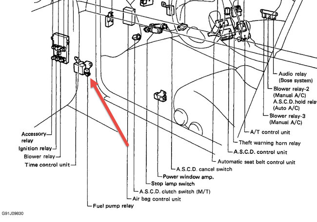

check fuel pressure with a gauge auto parts rent it. also, see if pump is getting power as most have a relay see picture, behind left kick panel. you also have a fuel pump control unit which could be bad as well which the ECM turns it on via the pink/black wire going to it. you should have forty three psi and may need an adapter because it has to be checked by fuel filter.
Apr 4, 2017 at 10:46 AM (Merged)
SAVERIO LUCIFERO
  • 14 POSTS
hey we checked the fuel pump and it wasent working so we fixed it and know its running fine and the engine still wont start whats the next step if the fuel pressure is fine and the gas is running threw the gas lines take into consideration the car wasent started for 4 years thanks
HMAC300
  • CAR REPAIR CONTRIBUTOR
  • 48,601 POSTS
pressure for fuel pump should be 43 psi if not pump no good for both turbo an d non turbo. check for spark as well scan for codes

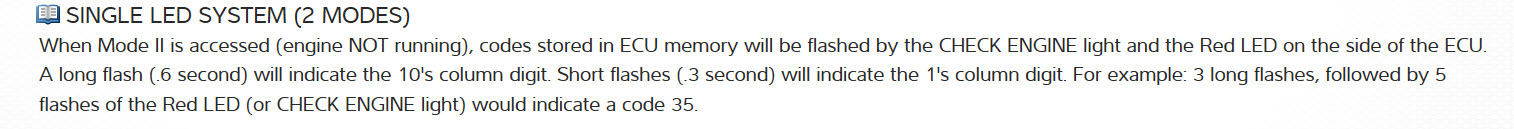

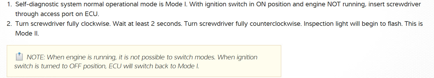

it cold be but you need to scan for codes see pics on how to do it then get back with code if any check all fuses if no ignition signal injectors will not fire so hold off on that.
SAVERIO LUCIFERO
  • 14 POSTS
I got code 55 what does that mean
HMAC300
  • 48,601 POSTS

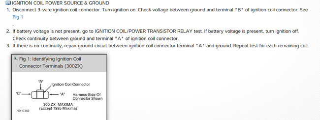

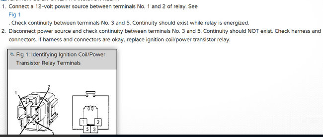

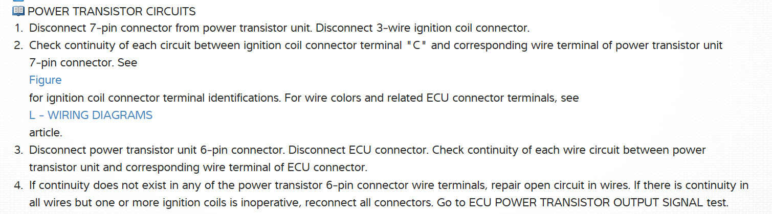

no faults are detected. so try this link i'm sending pics and do these tests to see if it's an ignition problem. do these in order also check resistance of coil from one post to another it should be .7 ohm

we tested all coil connectors they were all good and all had power
HMAC300
  • 48,601 POSTS
have you tested the 3 items in pics I sent a couple replies ago? if you have then check compression then have a local guy look at it.
SAVERIO LUCIFERO
  • 14 POSTS
It started the problem was the spark plugs thanks

Sorry for the delay in answering. Seems to be having connection problems. After going through your question and the schematic, I realised I forgot to mention the anti-theft system. Since you have power to the dash, it should not be any fault with the power supply as they have to pass through the ignition switch and there is no specific starter related fuse. It could be caused by the anti-theft system and you have to check if the relay is working when cranking. Check the clutch interlock relay power supply as well.
https://images.2carpros.com/forum/automotive_pictures/192750_RelayClutch90Nissan300ZX_1.jpg
