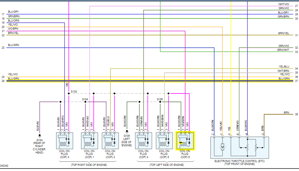

We switched all the coils and checked everything will even change the wires going from the spark plug coil up to them main output I think it’s the ECM and it still doing the same thing I don’t know if it could be a module or something inside the actual computer causing it to not fire on one cylinder? And every once in a while you can feel and hear that cylinder kick in? I don’t know what to think.
Sunday, September 8th, 2019 AT 4:01 PM
DANNY L
  • 5,648 POSTS
Hello again.
I've attached a wiring diagram below for the coil on plug system. It is controlled by the PCM (power-train control module) Have you checked to see if you're an electrical signal to coil on the affected cylinder. Let me know. Hope this helps and thanks again for using 2CarPros.
Danny-
Sunday, September 8th, 2019 AT 5:48 PM
COXDAN
  • 12 POSTS
Yes, we tested the wires at each one of the coils and there seems to be 12v of power in all 6 of the wires leading into the coils. It sounds like the plug fires right when it’s started and every once in a while it sounds like it fires but not much.
Monday, September 9th, 2019 AT 6:34 AM
DANNY L
  • 5,648 POSTS
Hello again.
If your getting power to the coils and the coils are working it sounds like there might be a glitch in the PCM. You might want to try cleaning/checking the PCM harness connection for debris/dirt/corrosion first. Use a small wire brush and an electronic type aerosol spray cleaner. Disconnect the battery first. Hope this helps and let me know if you find anything.

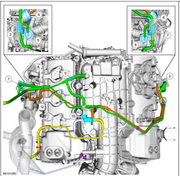

Hello again, thank you very much. I’m going to have a look at the PCM right now but that sounds right to me. I’m wondering if because I had someone not qualified to do the work if maybe the vacuum lines have been hooked up wrong as well. I know for some reason they don’t look right, but I’m not 100% sure. Anyways if there was a vacuum problem could that possibly be a reason that I’m getting a misfire or no fire I should say? I thought maybe if the sensors are getting the wrong signals that may throw something off? Also there is what I believe is a brake assist vacuum that sits right behind the drivers side headlight roughly or just under it, That I had to take apart and rebuild because of my very isolated community and limited funds ordering new parts is only a if totally needed option. Could that possibly lead to my problem as well?
Tuesday, September 10th, 2019 AT 7:56 AM
DANNY L
  • 5,648 POSTS
Hello again.
Yes, a vacuum line being disconnected/wrong/broke/cracked can cause a lean misfire. I've attached a vacuum line diagram below. Hope this helps until I find something better. Did you check the PCM connection?
