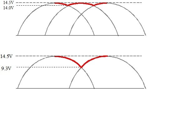

When we see high ripple voltage, along with, in this case, around 30 amps as the most we can make the generator deliver, we know it has a defective diode. Due to the time it can take to replace a diode, or more commonly a block of diodes, it is a hugely better value for you that we replace the entire generator with a rebuilt one with a warranty. Even worse, due to GM's design, it is almost impossible to disassemble their generators without damaging other parts. The thin, flimsy tabs on the diode block usually break off rendering the entire diode block worthless, and once you do get everything apart, there's no way to test the voltage regulator. It can also be responsible for the dead charging system. Given the difficulty in disassembly, you're going to replace that regulator too. There are rebuild kits available at many farm and home stores that include all these parts, plus the bearings that have a known failure history, but they typically cost more than twice as much as for a Ford or Chrysler product, and you'll have hours involved that again, turn it into not a good value.

In my sad drawings below, the top graph shows normal voltage, and therefore current output. The three gray curved lines represent the voltage developed by the three circuits, or phases, in the generator. The red line on top is what you would see at the generator's output stud, and at the battery. The difference between 14.0 and 14.5 volts is the ripple voltage, which here is very low.
In the lower drawing, one of the three phases is missing. Ripple voltage is 5.2 volts which is very high. That's our clue that a diode has failed.
