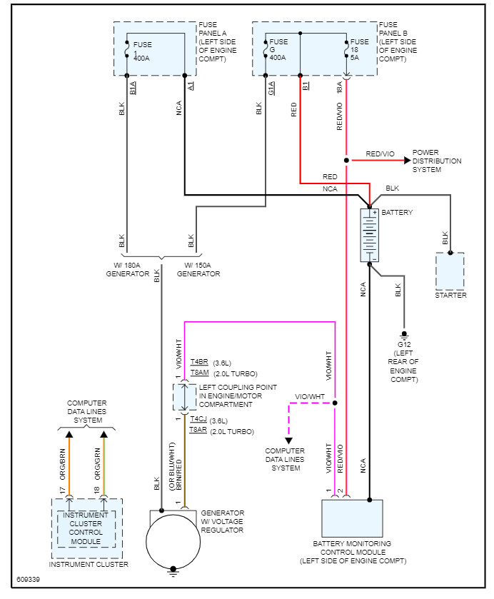

The battery keeps draining every few days. i have replaced both the alternator and a new battery the new alternator is still not charging the battery.

If the alternator is not charging let's check fuse # 18 - 5 amp and fuse G 400 amp in the fuse panel B in the engine compartment. Also fuse 1 - 400 amp in the fuse panel A on the left side of the engine compartment. Here are the wiring diagrams so you can see how the wiring system works for the alternator.

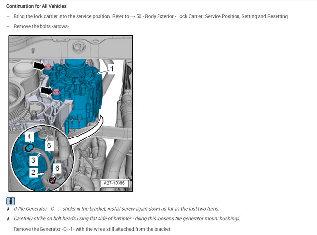

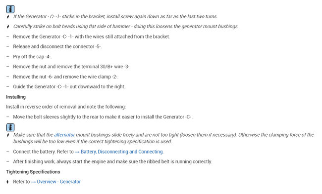

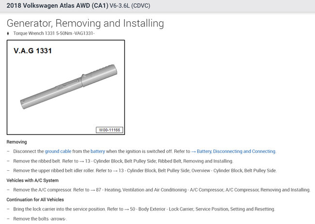

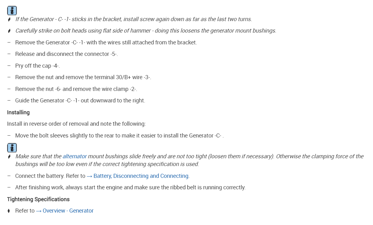

If the fuses are good double check the connection at the rear of the alternator if that's okay, you may have a defective alternator. Here are the instructions for the replacement to ensure the job is being done correctly. Check out the images (below). Please let us know what happens.
