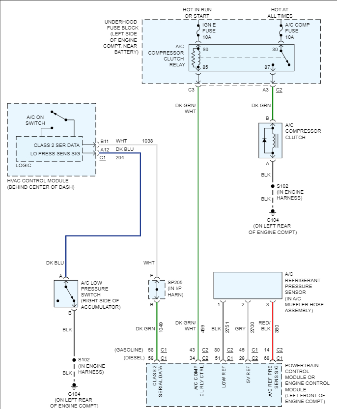

I had just replaced the A/C compressor condenser and accumulator and both pressure switches and the compressor still won’t turn on to take a charge. I checked the relay and fuses both good, and then jumped the A/C compressor at the relay crossing 30 to 87 when the key was on, and the compressor click, but still haven’t figured it out.

I just found under a TSB that in some cases the A/C compressor will not be allowed to come on if there are Trouble Codes stored in the ECM. So, you may want to scan it for any codes as well. I'll check the rest of this for any other conditions that may impede the compressor's operation. Did you replace the Expansion valve or TXV when you replaced the interior A/C components?
As check the cabin air filter is clear, the engine idle is not too low or unstable, cooling fans operating, overcharged/ undercharged, A/C high pressure switch on compressor looks like a pressure transducer 3 wire- 5volt, Ground and Signal.

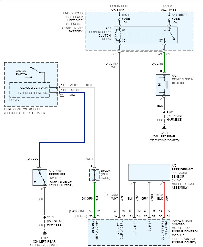

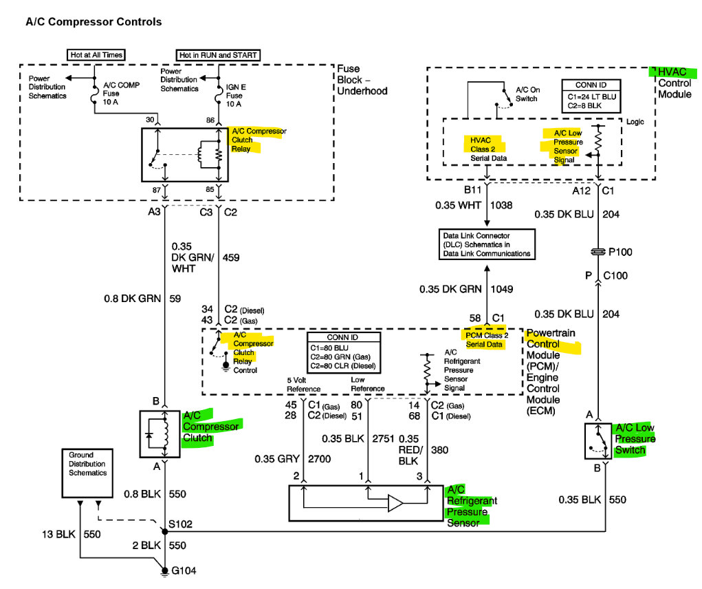

And the Low-Pressure switch on the Accumulator just Grounds the circuit threw the switch so the dark blue wire should be Grounded, and the HVAC control module will turn on compressor through GM 2 Serial Data to PCM and PCM then grounds the A/C compressor relay to engage the clutch.

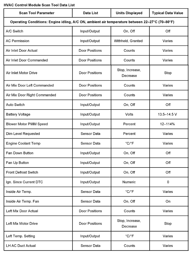

Yes, the climate control module can directly control the ac compressor through the GM Serial Data to the PCM. The A/C request isn't a top priority to the engine computer, because of the load that the A/C puts on the engine. If there's any faults or anything hindering the engine performance, it can keep the compressor off. That's why if there's any misfire codes for example it can keep the compressor off because it will lower the engine performance even more and that can affect the vehicle emissions. You would have to do a full system scan to detect any faults in the HVAC module, because it's a different module, a regular engine computer scanner will not read codes from other modules. The scan tools they use at AutoZone and advanced auto only scan the engine ECM, so they don't read codes from ABS, BCM, HVAC, etc. If you have a Scan tool that can read live data from the engine, you might be able to see an a/c request data PID, things that pertain to engine load will be displayed and could give you an idea if it's the engine computer not allowing the A/C compressor on. Or fault codes that have to do with the engine. Anything affecting emissions will leave a code set. Thats why the check engine light only usually comes on for engine issues.
Does your truck have an automatic A/C system, where you can set a certain temperature and it will keep it there, or is it a manual A/C where you just set the dial to cold?

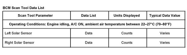

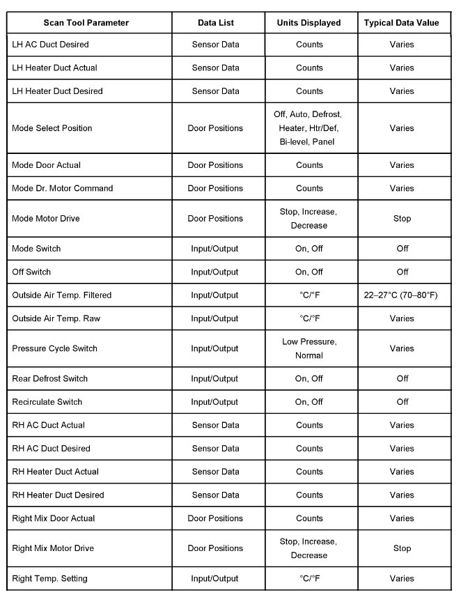

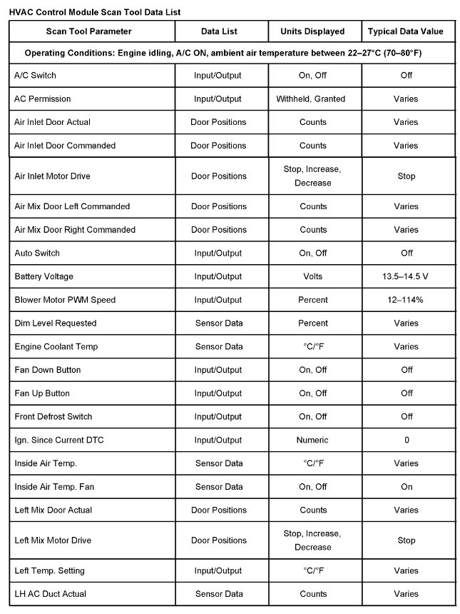

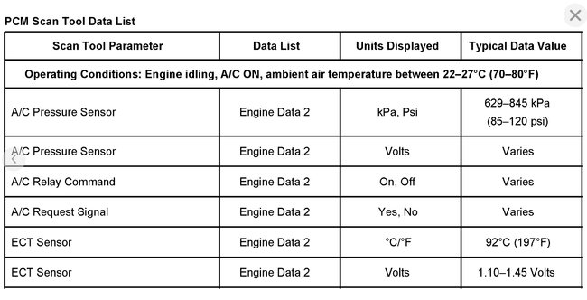

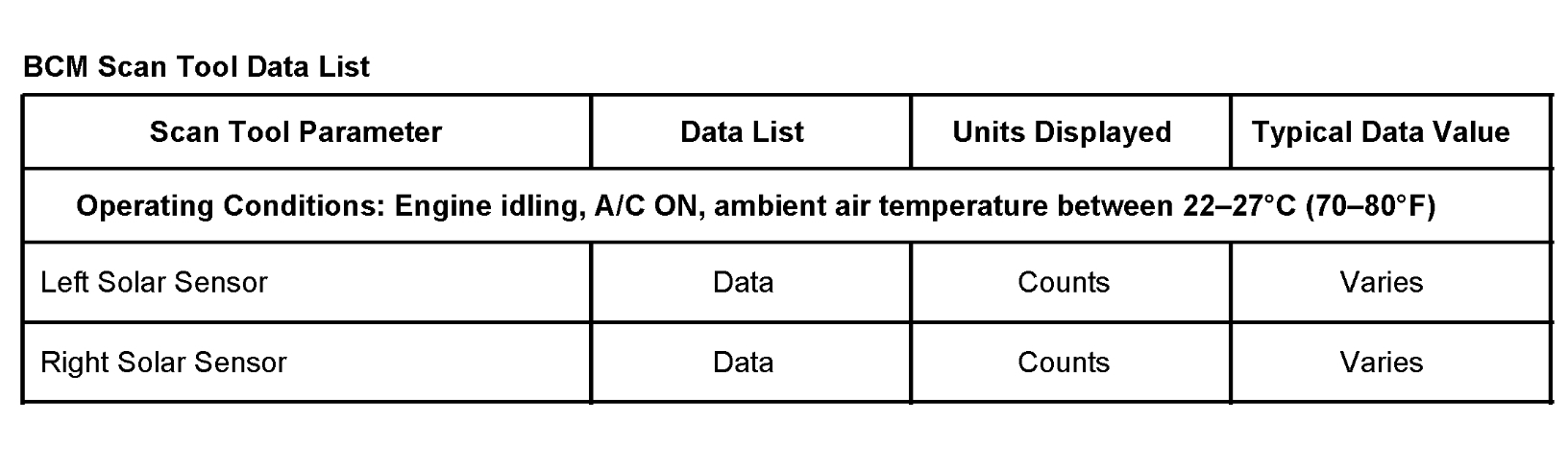

Here's some live data PIDS for the A/C system from the Body Control Module, HVAC module (2), and the PCM. You can see in the last diagram for the PCM there is an A/C Request and then an A/C Command. So, there can be the request but not a commanded on.
