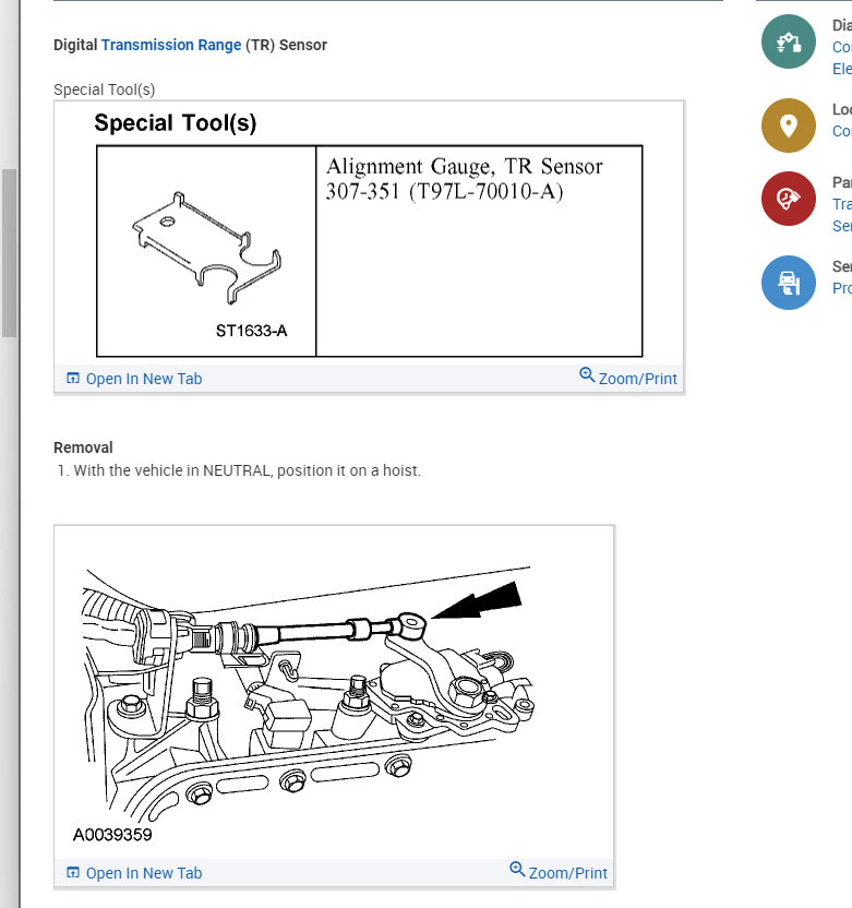

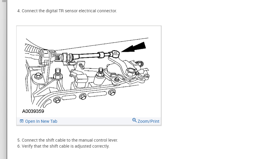

Replacement transmission a little while back with a used one truck has only been starting in neutral since. Is there a certain specs or procedures to aligning the neutral safety switch correctly? I tried to adjust the one on the transmission and now my truck won't start at all, it just cranks over. I've tried moving the neutral safety switch a little at a time and it just seems like it goes from cranking to no crank at all like I can't seem to find the correct position! Any advice or help is greatly appreciated as this is my only means of transportation!

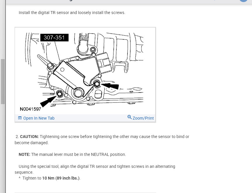

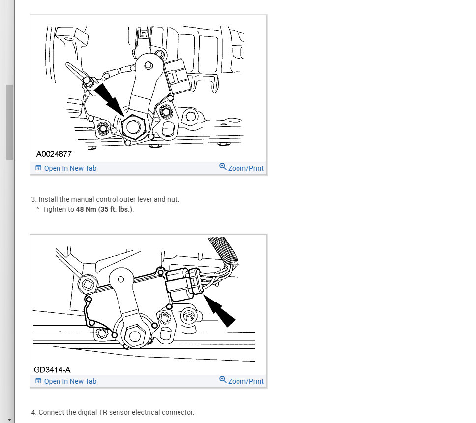

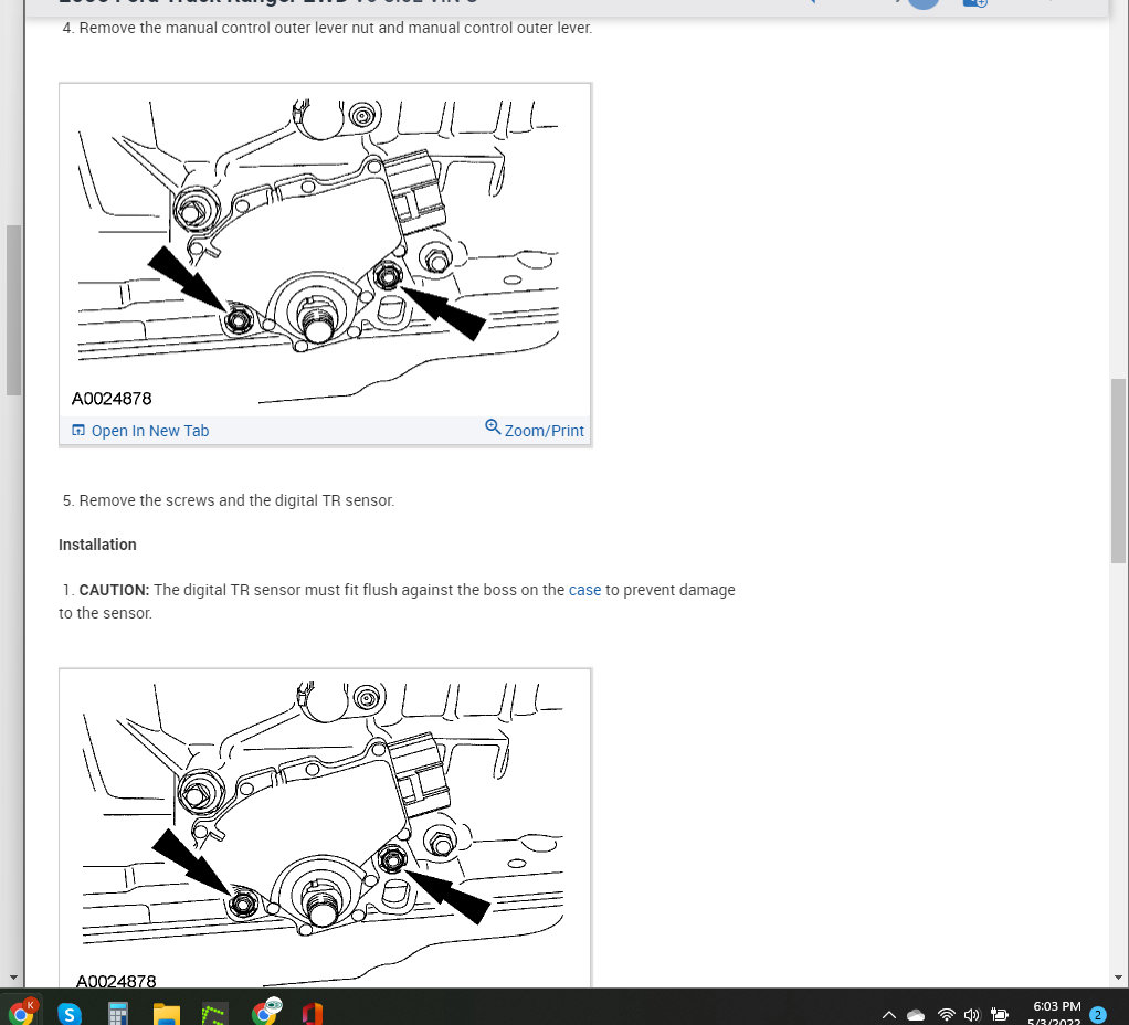

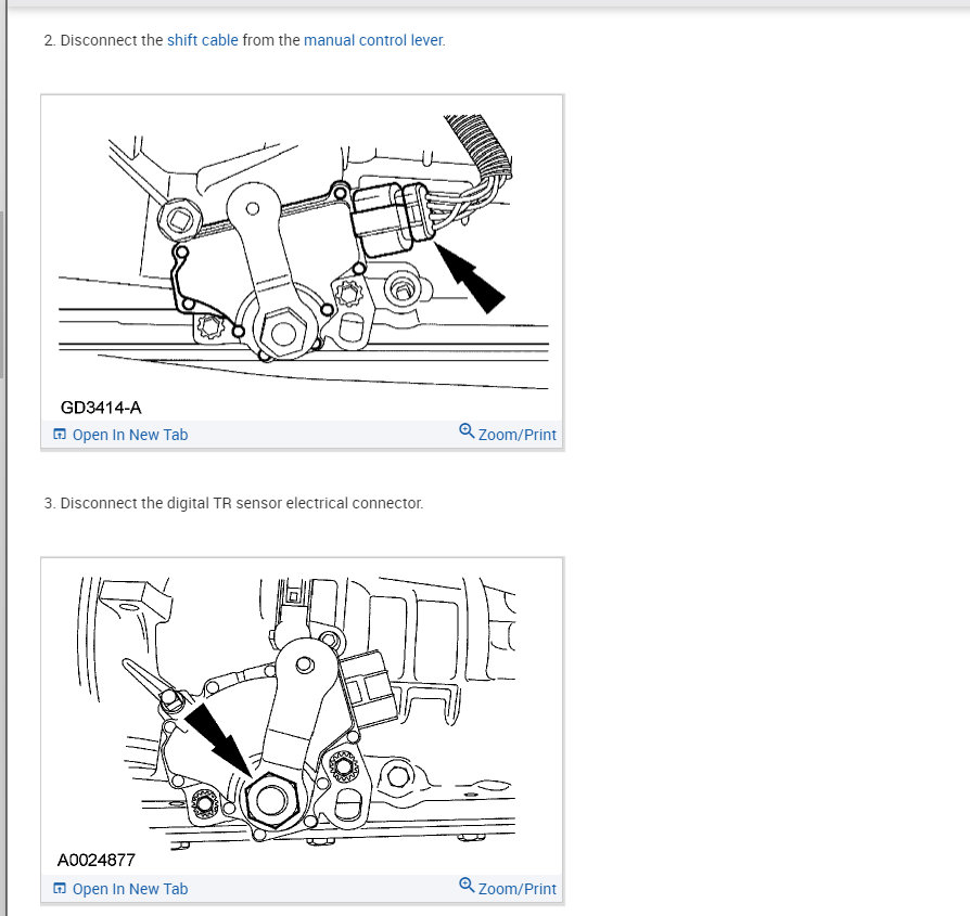

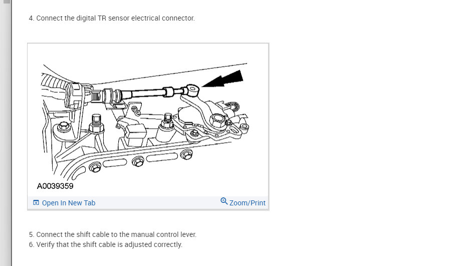

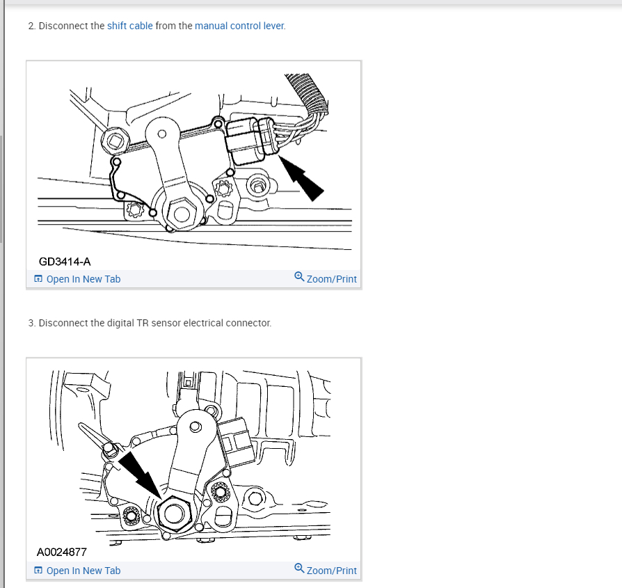

As for this issue, there are no adjustments for what is called the transmission range sensor.
Basically, what we have to do is use the special tool that is shown below to align the TRS properly and then it will recognize the park position.
However, if you have already tried to adjust it then it may be damaged and require replacement.
So, I would get the tool which is available at most any parts store or online and try to align it properly and then see if it works. If not, I suspect you are going to have to replace it.
Let me know if you have questions. Thanks

The TRS is aligned, out of curiosity would an out of alignment TRS cause something like that?

Sounds good. If the TRS is not aligned or defective, then it will not allow the engine to crank. Basically, the PCM needs to see the proper voltage showing park or neutral. If it doesn't then it doesn't allow the starter to turn.
So, if the engine is cranking then the TRS is most likely not the issue.
