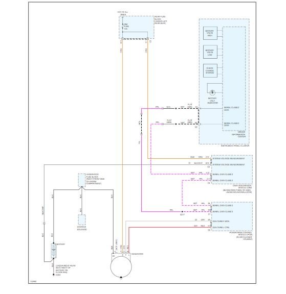

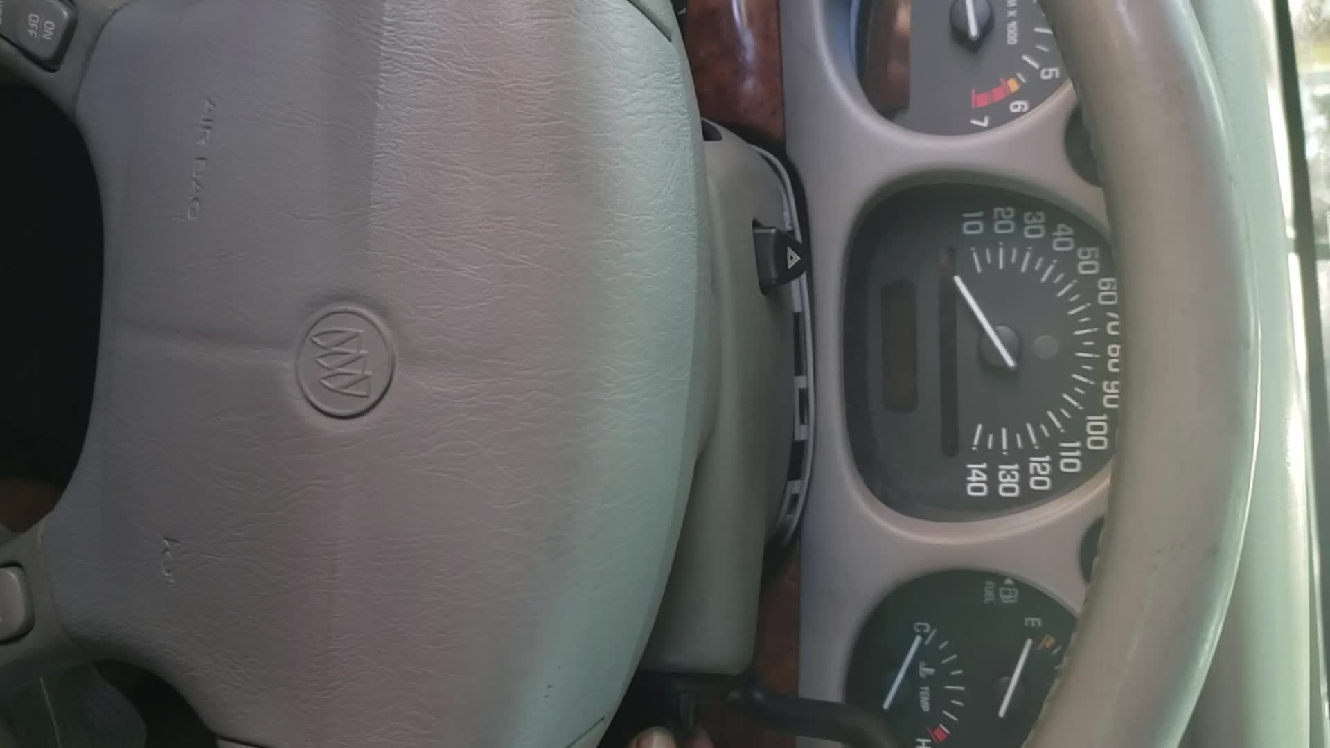

I can't find the neutral safety switch on the car listed above. please any help. I looked everywhere in the car inside and out and no luck.
Aug 7, 2019 at 11:08 AM

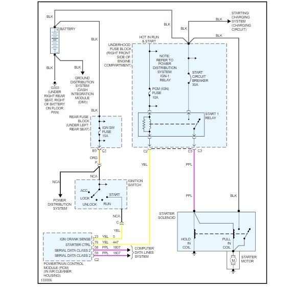

Good afternoon,
There is no neutral safety switch. The PCM and the starter relay control the operation of the starter.
The ignition switch sends a signal to the PCM. Then the PCM looks at the position sensor on top of the transmission to be sure it is in park or neutral. When it gets that signal, it sends power to the relay.
Aug 7, 2019 at 12:15 PM
CALOBETO IBARRA
  • 25 POSTS
Thanks so much for your help, please can you guide me? My car shut off while I was driving did not started back up. no crank when I turn the key to the crank position lights on the dash go off even when the battery is fully charged. so everything indicated that it was the neutral safety switch, but there is not a one. I can only start it jumping the starter on the relay but the alternator doesn't charge the battery back up, but if i put power on the alternator connector i think is a 3 or 4 pin (red wire) alternator looks like charge it. I test all the wires coming from the ignition switch but everything seems to be fine I m lost, because I search for the part and it is one but i can't see it.

Start with checking the fuse listed as PCM fuse at the relay. Test it for power in the start position.

I check all the fuses and relays everything is good. when I turn the key to the crank position while I turn the key lights go off and when I return the key lights go on in the dash key .
Aug 8, 2019 at 2:25 PM
This sounds like an ignition switch or possibly dirty battery cables. Make sure the cables are clean.

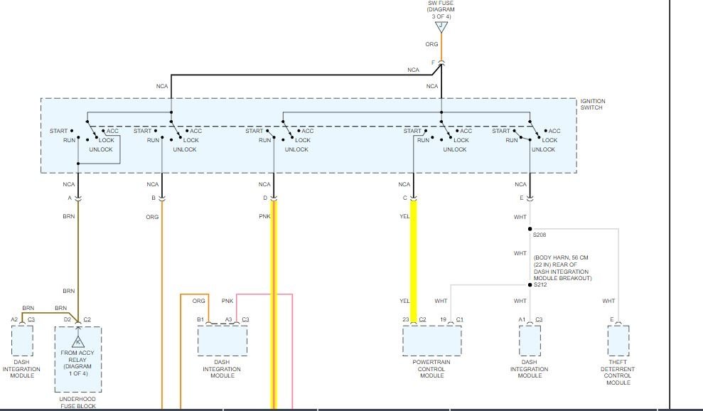

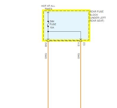

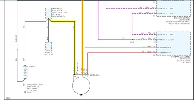

Check the fuse I listed in the diagram and make there is voltage to the 2 wires on the alternator with the key on.
I attached a diagram of the ignition switch. Check the yellow and pink wires at the switch.

This is what the car does even with the battery fully charged.

Sorry I apologize for the delay yes I just check the following:
1. dim (10A) fuse shows power all time
2. ignition Pink wire key on shows power and yellow shows power when I turn the key to the crank position
3. alternator connector with the key on. There's 3 wires red,gray and orange orange shows power the other 2 wires shows .37v and .46v.
Sorry boss thanks for your help.
Aug 10, 2019 at 5:20 AM
Okay, you may have either a bad alternator or the PCM. From here forward, you need a scan tool that can read the charging system to see if the PCM is turning on the alternator to charge the battery.

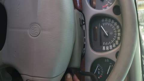

I have autel708 scanner what do I look for in my scanner I was doing some out put test with my scanner but starter and fuel pump says disabled I tried to turn the radiator fans on it won't turn on the fuel pump sounds like turns on every time I command to turn on .
Aug 10, 2019 at 7:57 AM
CALOBETO IBARRA
  • 25 POSTS
Also the lights in the dash for the gauges don't turn on.
Just the lights like the ones show on the video that I posted.
