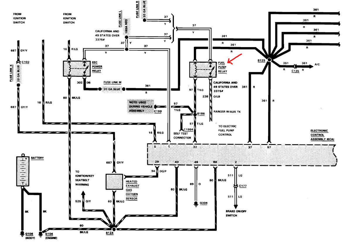

Truck starts then shuts off due to lack of fuel. Not getting power past the fuel pump relay or anything downstream.

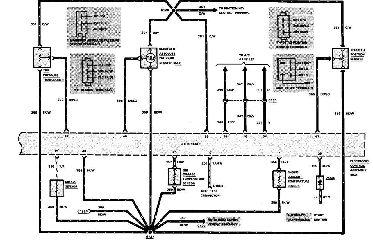

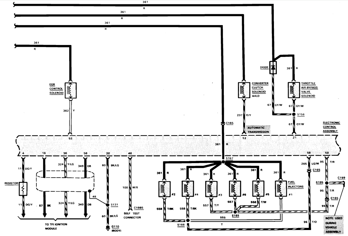

Sure, here are the fuel pump wiring diagrams along with the engine wiring diagrams which both are together.
This guide can help you test the wiring:
Check out the images (below). Let us know if you need anything else.
