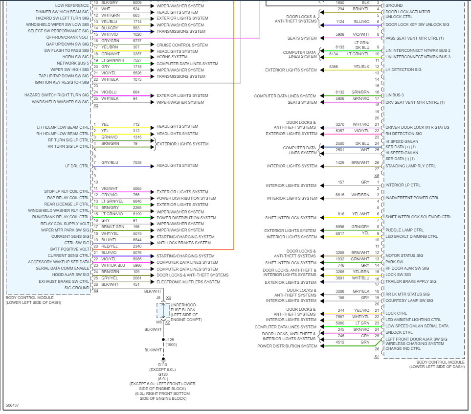

Need pinout wiring diagrams for bcm connectors?
2016 GMC SIERRA
50,000 MILES
TINMAN_GZ
After the installation of a gps with starter disable, menu control and media buttons on steering wheel no longer function. Steering wheel cruise control is functioning. The wires near the bcm have been modified so I suspect the problem is with a broken wire or a pin on a connector has been removed for testing and inserted into the wrong position in the connector. Thank you
May 24, 2023 at 12:44 AM
  • 55,006 POSTS

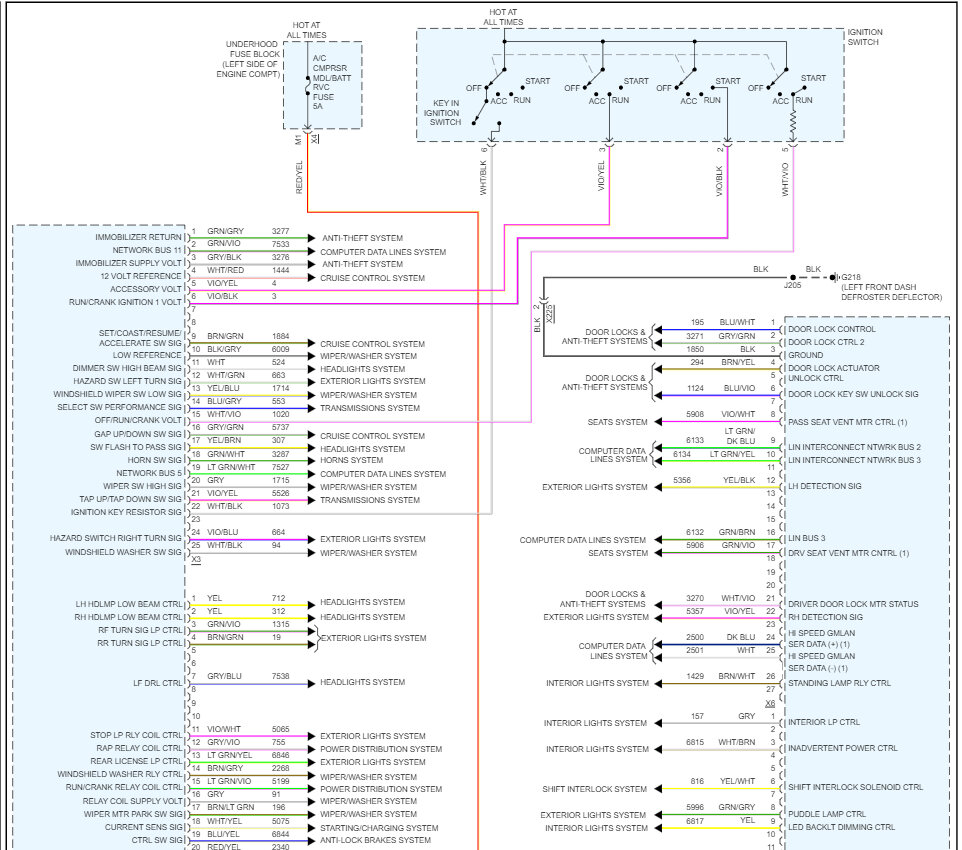

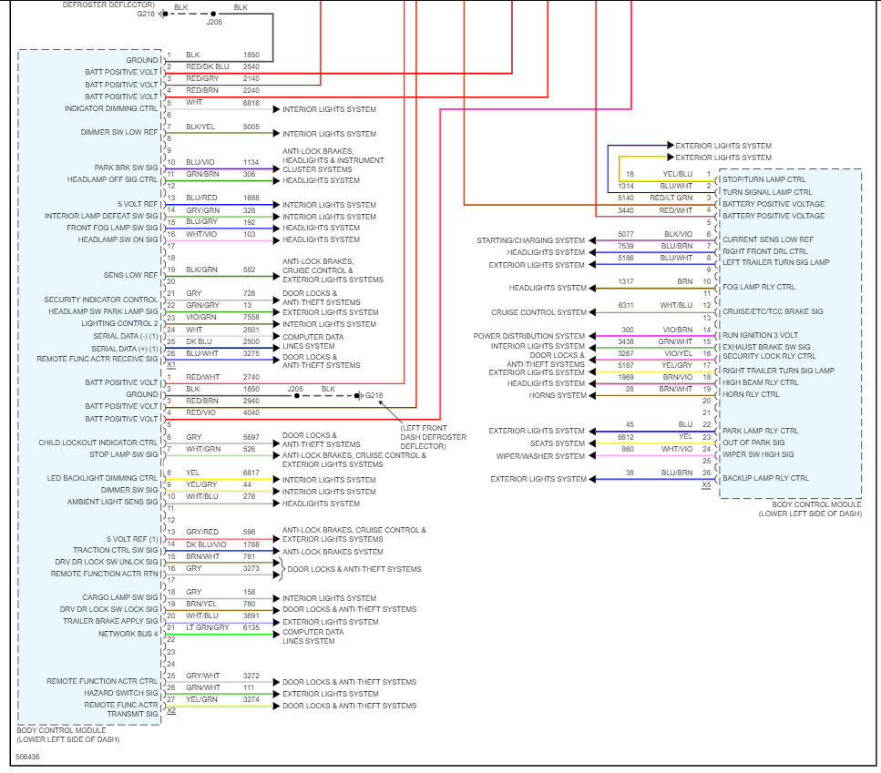

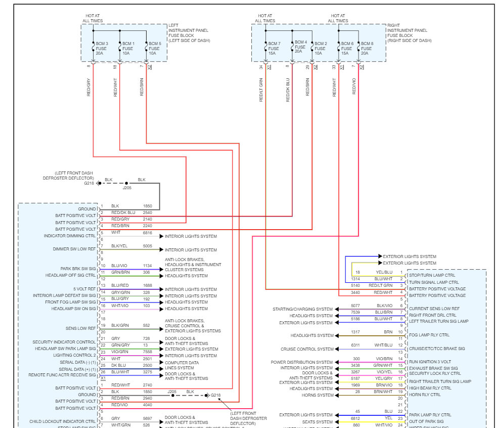

Sure, here is a guide to help you with the testing and the BCM wiring and pinout diagrams in the images below.
Check out the images (below). Please let us know if you need anything else to get the problem fixed.
May 25, 2023 at 2:03 AM
