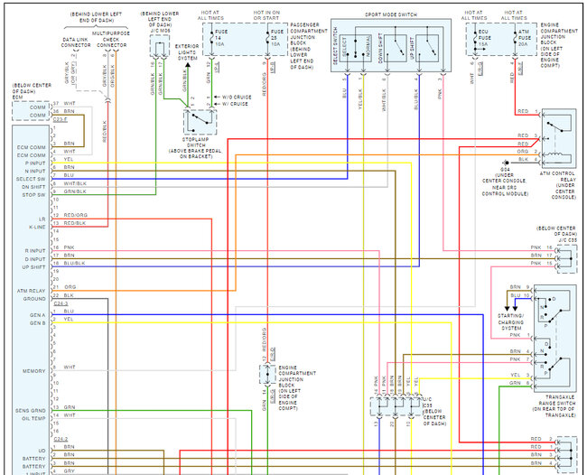

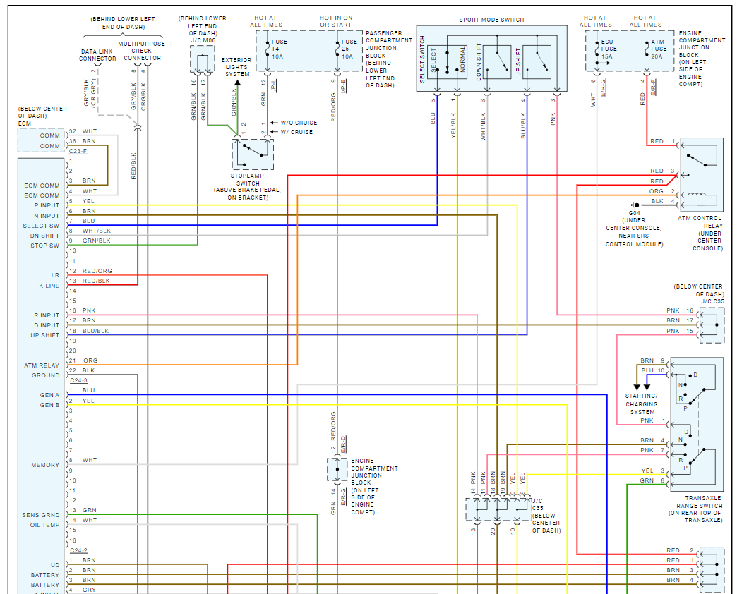

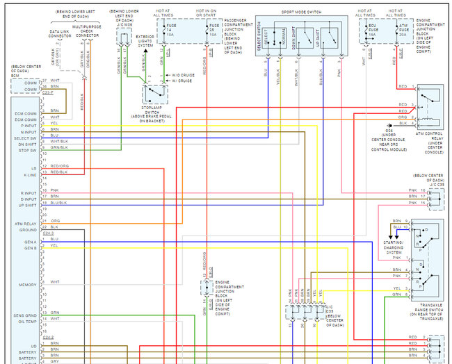

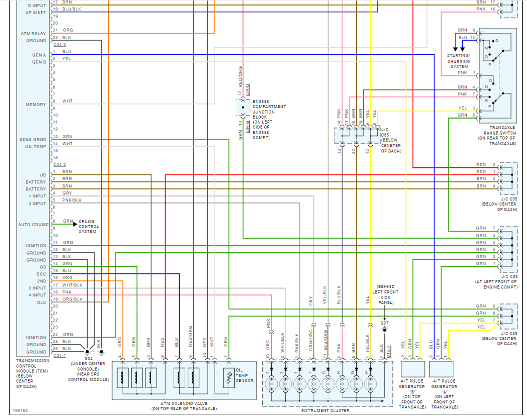

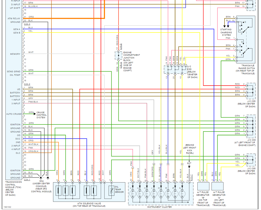

So, both green wires at the input and output sensor should have power all the time.
This guide can help you test:

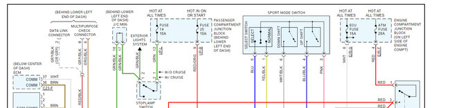

There are four fuses and two grounds that need to be checked as well which I have included in the wiring diagrams below, also if all these are okay, I would replace the TCM which feeds the speedometer.
So, these codes say
Code P0715: Input/Turbine Speed Sensor Circuit Malfunction
Code P1529: Transmission Control Module (TCM) MIL Request

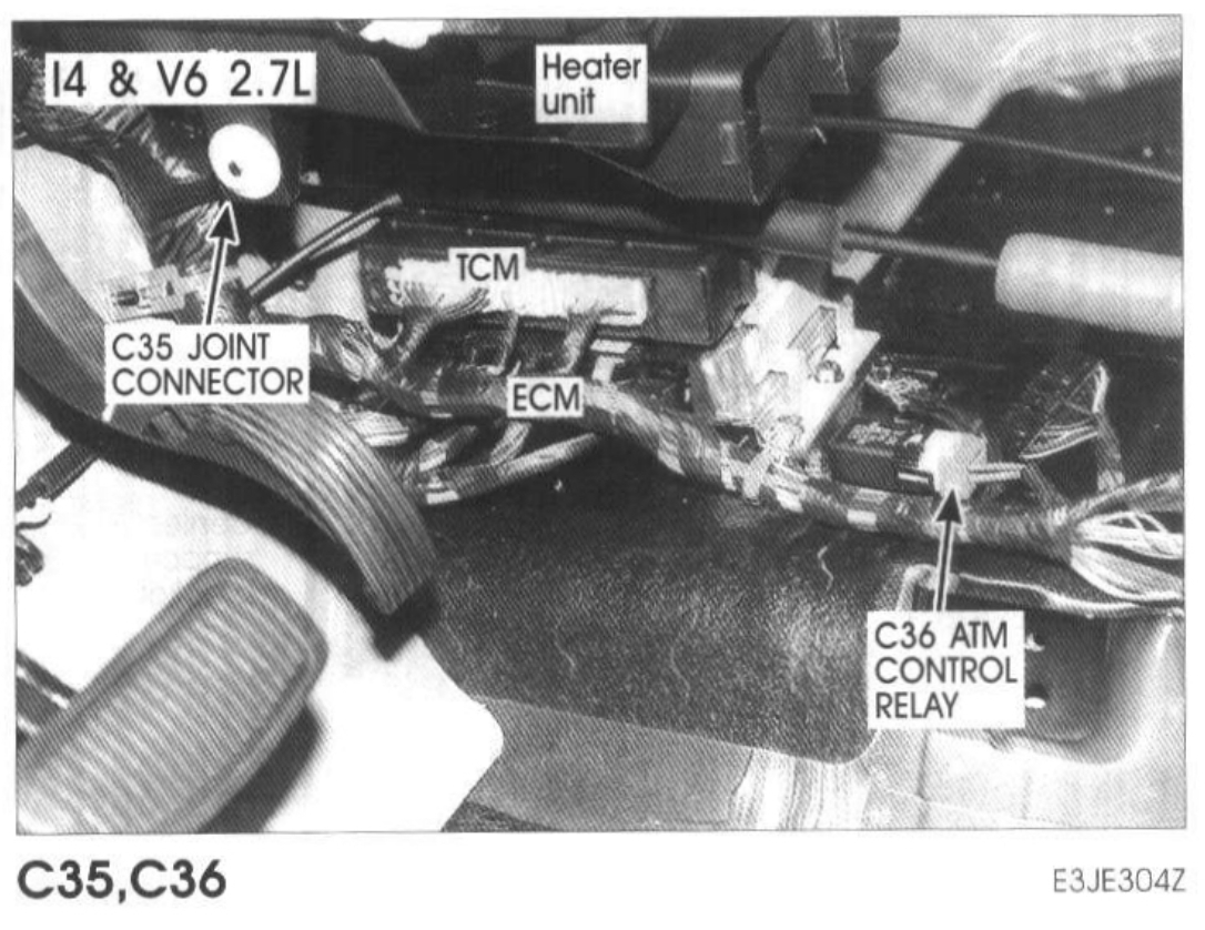

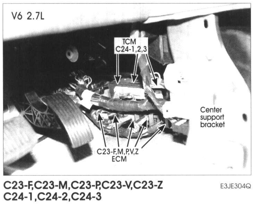

I included the TCM wiring diagrams so you can see how the system works and the TCM location as well in case you need to replace it. Check out the images (below). Please let us know what happens.

So, I did everything. I replaced input output speed sensors as well as turbine and new harness and then it wouldn't shift out of first gear so then just for fun I decided I would go ahead and take off the transmission pan and replace the transmission fluid once more and clean out all of the shift solenoids and replace them all back in again and the same thing is happening except it doesn't stay in first year anymore it shifts all the way everything except for overdrive so maybe it's the TCM? Because its speedometer is still not working.
Saturday, August 10th, 2024 AT 7:32 PM
KEN L
  • MASTER CERTIFIED MECHANIC
  • 55,065 POSTS
Did you clear the codes and if so are there any now? Also, did you check the fuse for power and the check TCM ground? If so, I would try swapping out the TCM, because they are low under the dash they can get wet. Also check the electrical connector for corrosion as well.

So, with these codes all at the same time I would check the power source (fuse and the ground and if okay replace the TCM.
P1529 - MIL Request Signal from TCM to ECM:
P0720 - Output Speed Sensor Circuit Malfunction:
P0715 - Input/Turbine Speed Sensor Circuit Malfunction:
Let us know what you find.

Do you have instructions how to replace TCM or diagram?
Monday, August 12th, 2024 AT 11:46 AM
KEN L
  • 55,065 POSTS
Yes, in the post above I give the location of the TCM, just remove it and get another one.

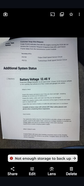

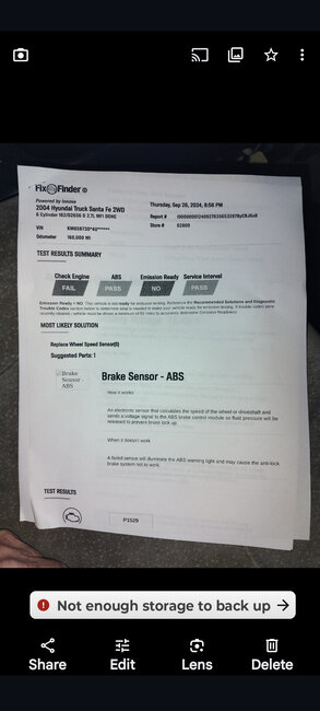

How do I send a picture to you of what it said? I was actually wrong on the codes for some reason I thought I grabbed a different kind of paper but it says the brake sensor ABS is what it says and it's a p1529 is all that shows up it says replace wheel speed sensor which I've done already I mean I can only find one wheel speed sensor on this car. It doesn't matter where I look I've looked so many different places but there's one on the rear only on the driver side and then there's one on the passenger side up front but I was watching all these different videos however and it kept showing two of them on the front which for the life of me and my friend cannot even remotely find where they're talking about that the front left one is but I've replaced the one on the right front.

You can upload the images in your response. Also, the pulse generator A and B that control the speedometer and input shaft readings.

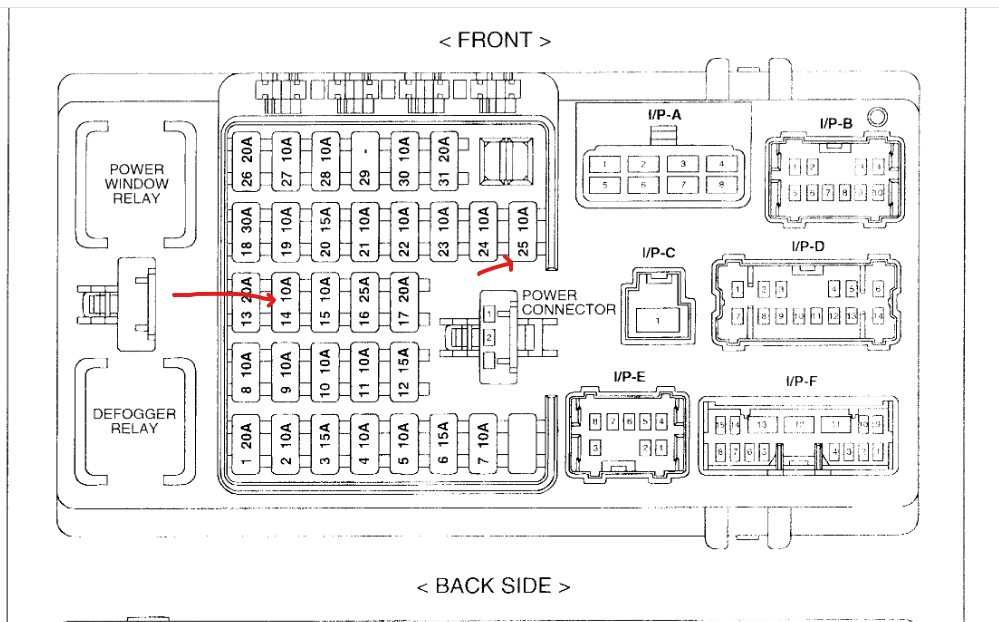

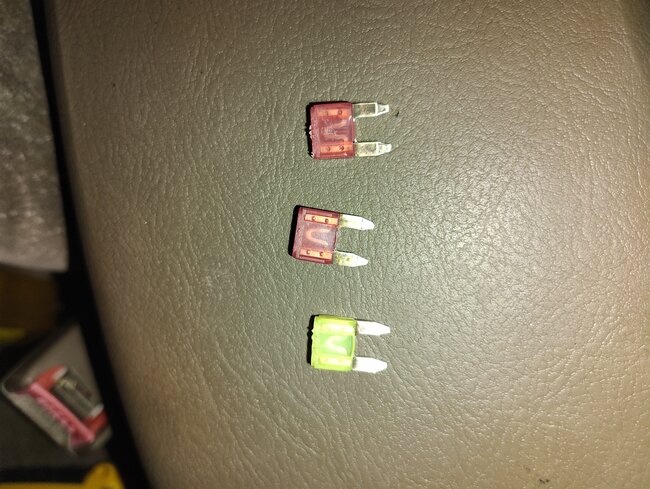

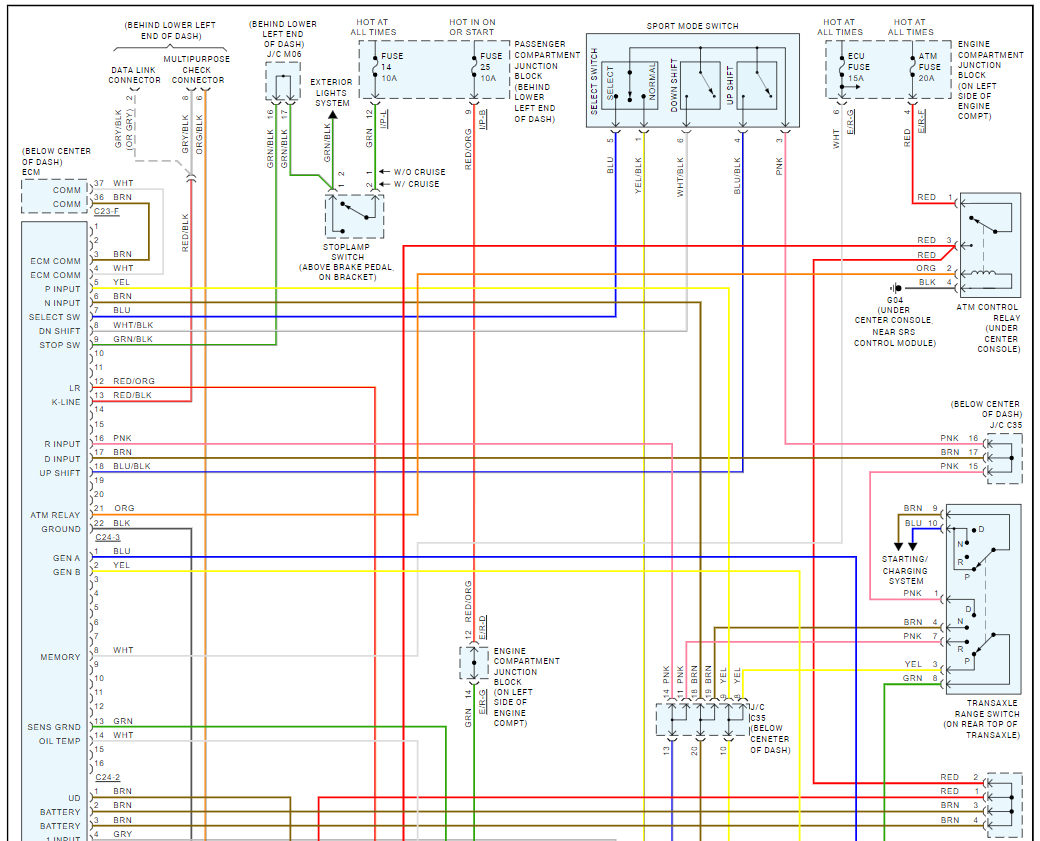

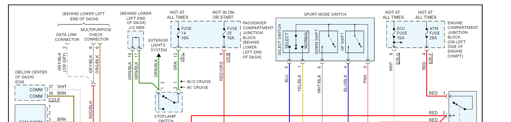

If the speedometer is not working, then the transmission will not shift automatically. Can we check the fuse #14 and #25 in the fuse panel inside the car, these control the TCM. Here is a guide and the fuse locations:
Here are the fuse locations. Test with the key on. if they are okay, I would test the wiring between the output shaft sensor and the TCM.
Sunday, September 15th, 2024 AT 9:44 AM
DANGELL
  • 30 POSTS

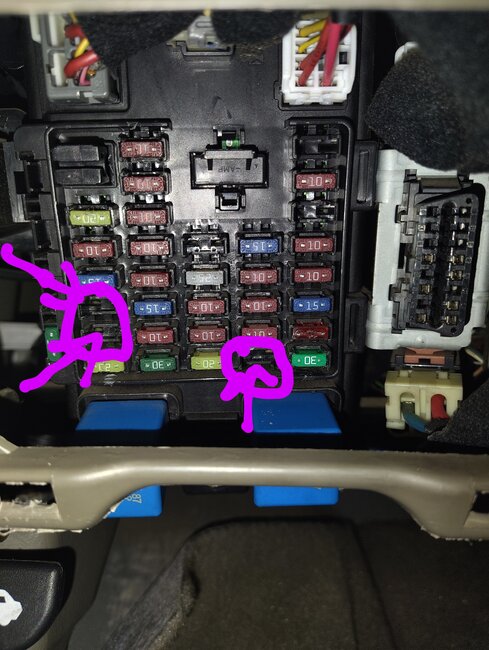

These are the fuses that are not lighting up but look good when I pull them.
Monday, September 23rd, 2024 AT 7:48 PM
KEN L
  • 55,065 POSTS
The fuses looks good, it can be normal for the fuses to not light up, was the key on while testing? It does not look like those fuses have anything to do with the system in question, can you confirm by giving me the fuse numbers? Did you check the power and ground to the TCM?

Here's what codes are. When I test the wires what exactly am I looking for just the continuity or power whatever or what exactly do I need to be looking for whenever we test the wires and you're talking about the wires coming from the TCM to the output sensor right.
