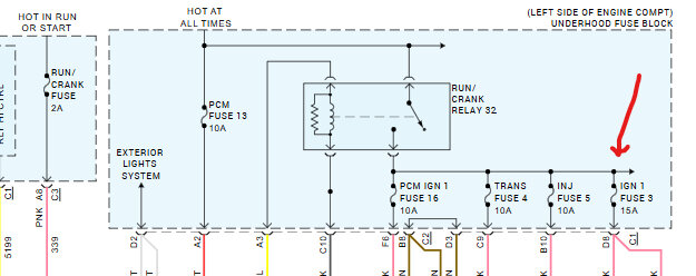

Need coil connector diagram i have ground abut no power at 6 pin coil connector
2006 PONTIAC G6
228,828 MILES • 3.9L • 6 CYL • 2WD • AUTOMATIC
SUNDOWN69696
No spark no power at coil connector with good fuses and relays?

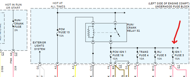

So, there is an oil level switch on the oil pan which if the oil is low it will shut the engine down, so I would make sure the oil level is good and then put the signal wire to ground to see if that makes a difference. We need to see if there is power at the IGN1 fuse with the key on, this guide can help
Check out the images (below). Let us know how it goes, Ken
