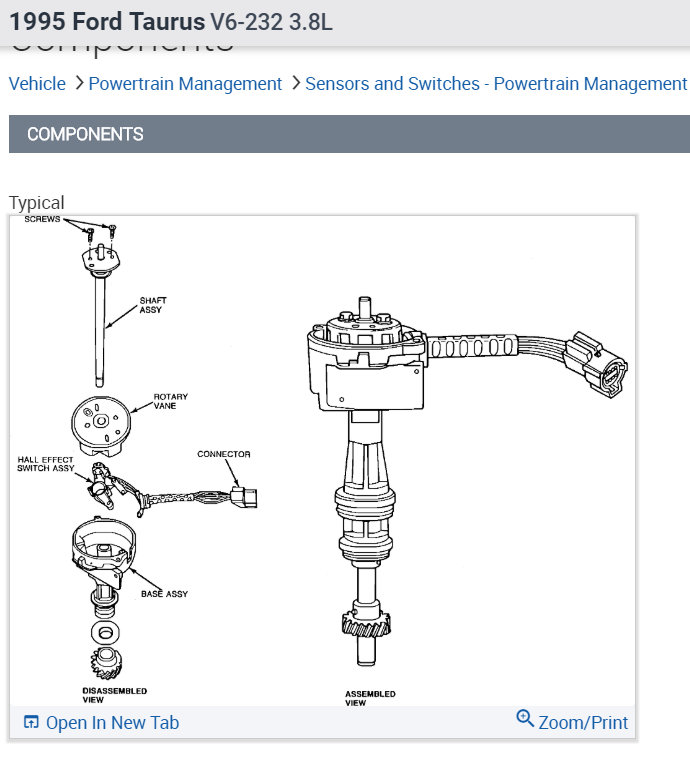

Can't locate the crank angle sensor
Feb 28, 2019 at 11:18 AM
  • CAR REPAIR CONTRIBUTOR
  • 54,350 POSTS
The crankshaft sensor is called a hall effects sensor which is located inside the distributor. Check out the diagrams (below). Please let us know if you need anything else to get the problem fixed.
Mar 1, 2019 at 2:08 PM
STHOMAS0301
1995 Ford Taurus
We bought this car used and it drove perfect for about three months. Daughter parked it in the driveway and it won't start again.
Several people have told us it sounds like the crank sensor. We have the part but have been told to look in two different places in the engine. Where is it located?

1- looking for a crank sensor ?
what do you have for an engine size
Mar 2, 2019 at 11:43 AM (Merged)
STHOMAS0301
The engine size is 3.0
BMRFIXIT
  • 19,053 POSTS
Do not have a crank sensor
do you have a distributor ]and if so no need for crank sensor
have a pick up coil and module
if no spark check and suspect module

Bolted on side of the distributor

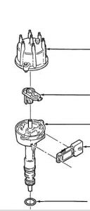

If the 8Th digit is a 4 then you have a 3.8L engine?If you have the 3.8L that has a distributor and wouldn't have a crank sensor.So do you have the 3.8L engine?If you don't then what engine do you have?Do the spark plug wire's go straight from the coil to plug's?Or do you have a cap the wire's come off?
TABJR
  • 5 POSTS
car haves 3.8 with cap. motor mount boke repair and put new water pump car cranks but will not start ?
SATURNTECH9
  • 30,869 POSTS
If you have a cap there won't be a crank sensor.So it ran good before you replaced the mount and water pump?Did you check to see if you knocked any wires loose?Have you checked for spark and what your fuel pressure was?

There is no crank sensor on a 1992 Taurus. This car has a distributor.
