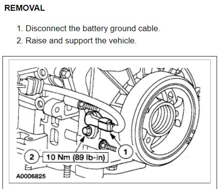

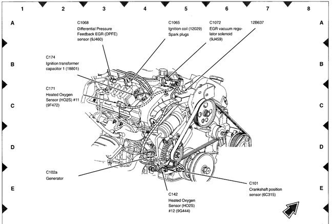

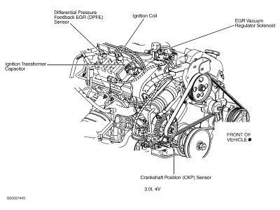

The engine crankshaft angle sensor is located down in front of the engine at the crankshaft level here is a guide to help you see what you are in for when doing the job and the location of the sensor in the diagrams below.

On lower right front of engine

Lower right front of the engine and yes, you can replace it yourself. It's usually just bolted in and has a wiring connector that needs to be disconnected.
