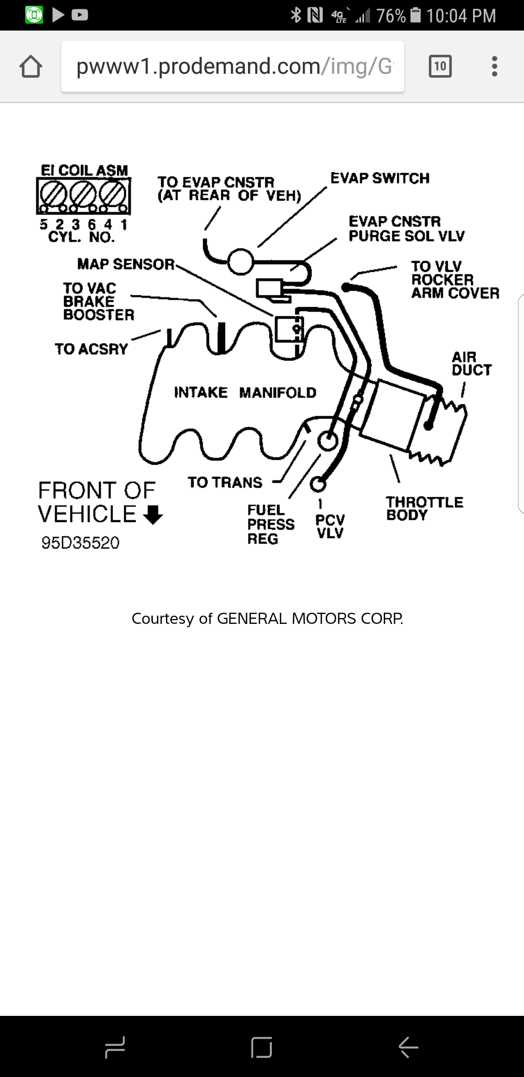

Need vacuum line diagram. Need 360 image.
Monday, June 26th, 2017 AT 7:18 PM
3 Replies
SATURNTECH9
MECHANIC
30,869 POSTS
Which engine size do you have the 3.1L or the 3.4L engine?
+1
Tuesday, June 27th, 2017 AT 9:49 PM
MIKE CLARK2
MEMBER
2 POSTS
3.1 V6
+1
Tuesday, June 27th, 2017 AT 10:02 PM
SATURNTECH9
MECHANIC
30,869 POSTS
There is your vacuum diagram.
