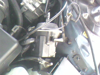

Coolbeans, ty for the drawing. I checked those lines and they all appeared good. I also checked something else out, not sure what this is, maybe the EGR? It has a plastic tube and and rubber hose attached to it with a wiring harness on the back side. The canister can be pushed in by hand and is linked to the throttle. The rubber hose is connected, but soft and spongy and kinda dry rotted looking, the pastic hose was broken, so I connected it to the vacuum line/t connector that was the only thing right there and close.
Car appeared to run better, but will have to wait untill it has set a while, which is when it has the most problems. What is this canister linked to the throttle and what can/will it affect? I appreciate the help and will donate if there is a place to here on payday. Ty

MATT29
  • 10 POSTS
Ok here is two pictures of the part i mentioned before:
https://www.2carpros.com/forum/automotive_pictures/218714_Photo0053_2.jpg
https://www.2carpros.com/forum/automotive_pictures/218714_Photo0054_2.jpg
It has a rubber hose on the side that is kinda soft and dry rotted a bit, runs down and where i cant find. Has a smaller plastic tube attached to it and a wiring harness on the back, it is linked to the throttle as well.
I also noticed a chirping noise this morning. It only happens when im in gear and accelerating, not when im in parj and idling or hittin the pedal. Not sure what that is, does not sound like a belt issue at all, dunno.

MERLIN2021
  • 17,250 POSTS
That looks like your cruise control actuator.
