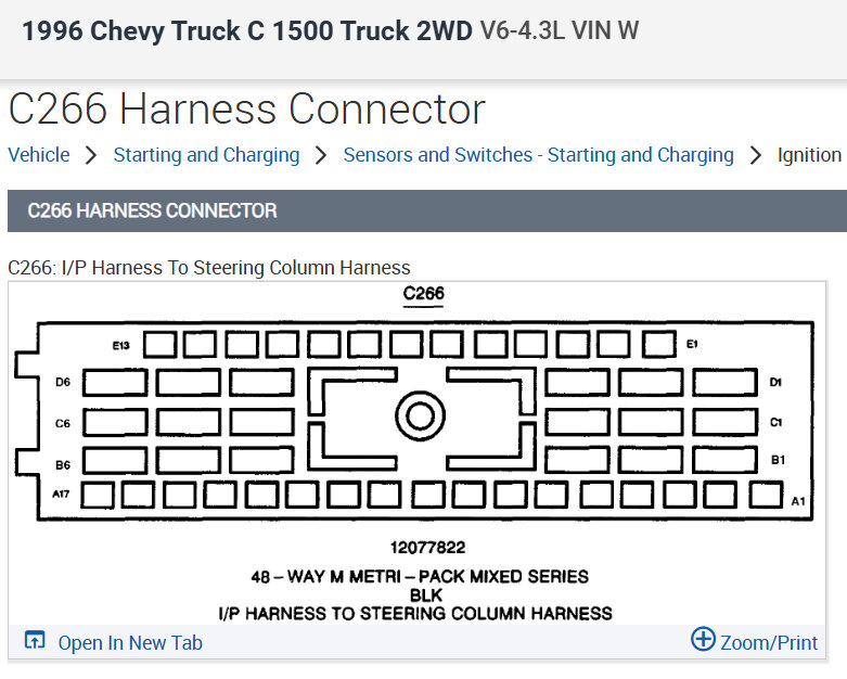

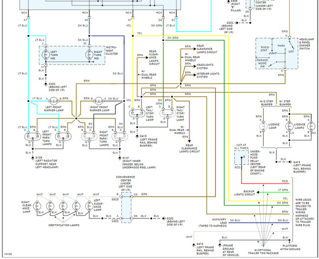

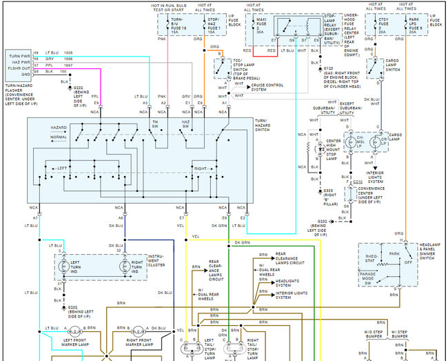

I need the diagram of the multifunction connector, the one that goes in the column under the steering wheel, the one that controls the lights?
1996 CHEVROLET 1500
12,986 MILES • 4.3L • V6 • 2WD • MANUAL
MIKE1500
  • 6 POSTS
I don't remember how the pins are distributed anymore.
I need the diagram of the multifunction connector EL that goes on the column under the steering wheel EL that controls the lights
Dec 26, 2024 at 6:01 AM
  • CAR REPAIR CONTRIBUTOR
  • 54,193 POSTS
Sure, here are the wiring diagrams for the blinkers. Check out the images (below). Let us know if you need anything else.

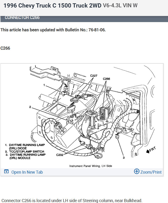

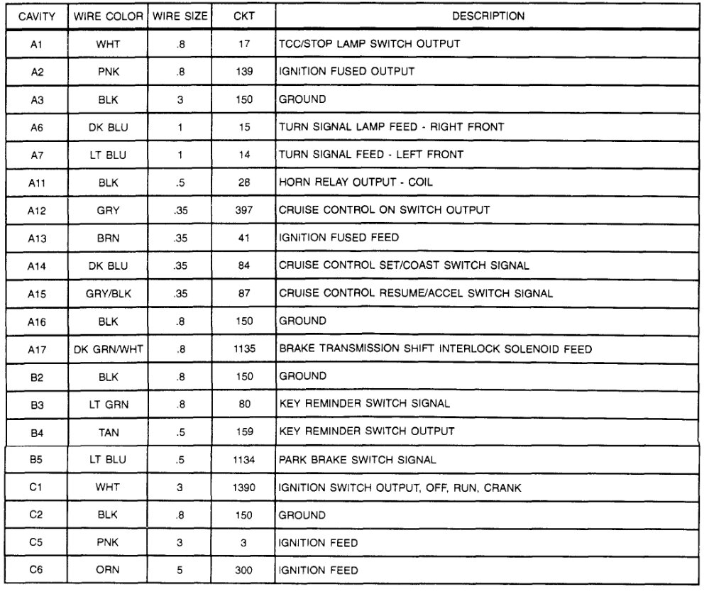

I have already checked fuse 16 and everything is perfect without any problem, thank you. If it is not too much trouble, could you help me with the diagram of the connector that is located on the firewall?
Dec 28, 2024 at 2:14 AM
  • 54,193 POSTS
I think this is the one you need. Check out the images (below). Let us know how it goes.
