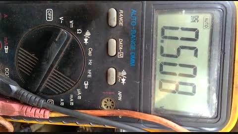

1. When I put the red lead on the 2/4 pressure switch pin1 and the black lead on the return wire, look at the readings on this video.
Tuesday, July 27th, 2021 AT 4:22 AM

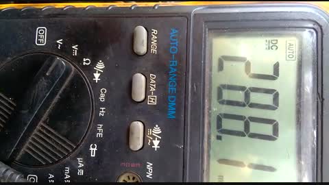

When I put the red lead on the o/d pressure switch pin3 and the black lead on the return wire, look at the readings on this video.
Tuesday, July 27th, 2021 AT 4:28 AM

What can you say about this situation? Because I said let me do the test first before proceeding to body valve if it pass the test?
Tuesday, July 27th, 2021 AT 4:33 AM
Okay, it should be 12 volts. There is an issue feeding the solenoids.

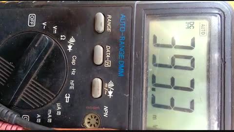

Check and see if any of the wires have 12 volts: the return wire pin4 has 12 volts.
How many volts does the 3 sensor wire supposed to have?
Tuesday, July 27th, 2021 AT 3:32 PM

Red lead into pin4 and black lead to pin 1. Tell me the voltage.
Tuesday, July 27th, 2021 AT 4:21 PM
That indicates an open circuit on the 2-4 sense wire. That is ghost voltage as it is not constant voltage. That indicates an open circuit.

Good evening! Correct. There is either a broken worn or corrosion in the harness: I disconnected PCM connector and Solenoid/Pressure Switch Assembly, I check resistance on each pin. There was continuity and I removed transmission control relay and used jumper wire to connect fused B+ and transmission control relay output, as I put the red lead on pin1 and black lead on pin4 to measure voltage, it reads 10.16 volts on all the pin1(2-4 pressure switch) =10.16volts, pin2(L/R)=10.16 volts and pin3(O/D)=10.16 volts, so I guess the 3-sensor wires are short to voltage. Am I correct?
Wednesday, July 28th, 2021 AT 12:04 PM
With your results, that is what it appears to be, yes.
Wednesday, July 28th, 2021 AT 12:19 PM
